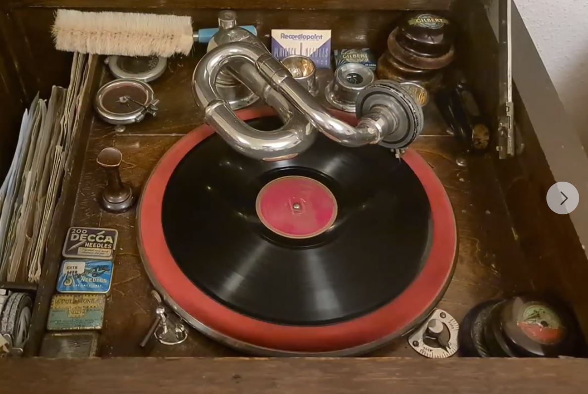

This ?
I would have to contact the owner to find out the name, it's over in the Australian Facebook forums.

Re: longest tonearm?
Post by JohnM »
JeffR1 wrote: Tue Nov 22, 2022 7:17 pm This ?
That’s a Gilbert.
Orchorsol
Posts: 1806
Location: Dover, UK
Post by Orchorsol »
JohnM wrote: Tue Nov 22, 2022 7:40 pm
That’s a Gilbert.
They look as though they ought to be good performers with that extra length of tapered tonearm, but I've always found Gilberts rather poor.
