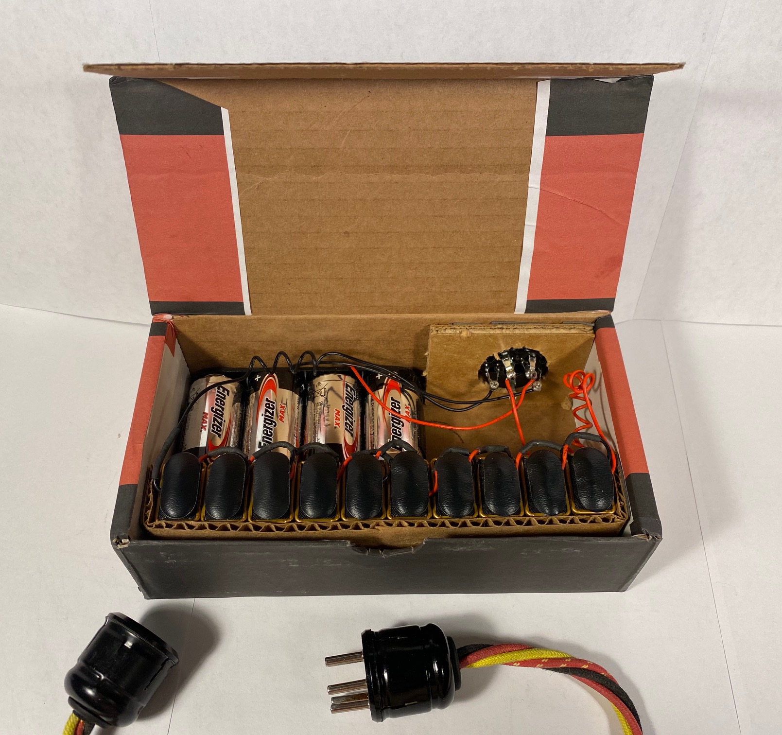

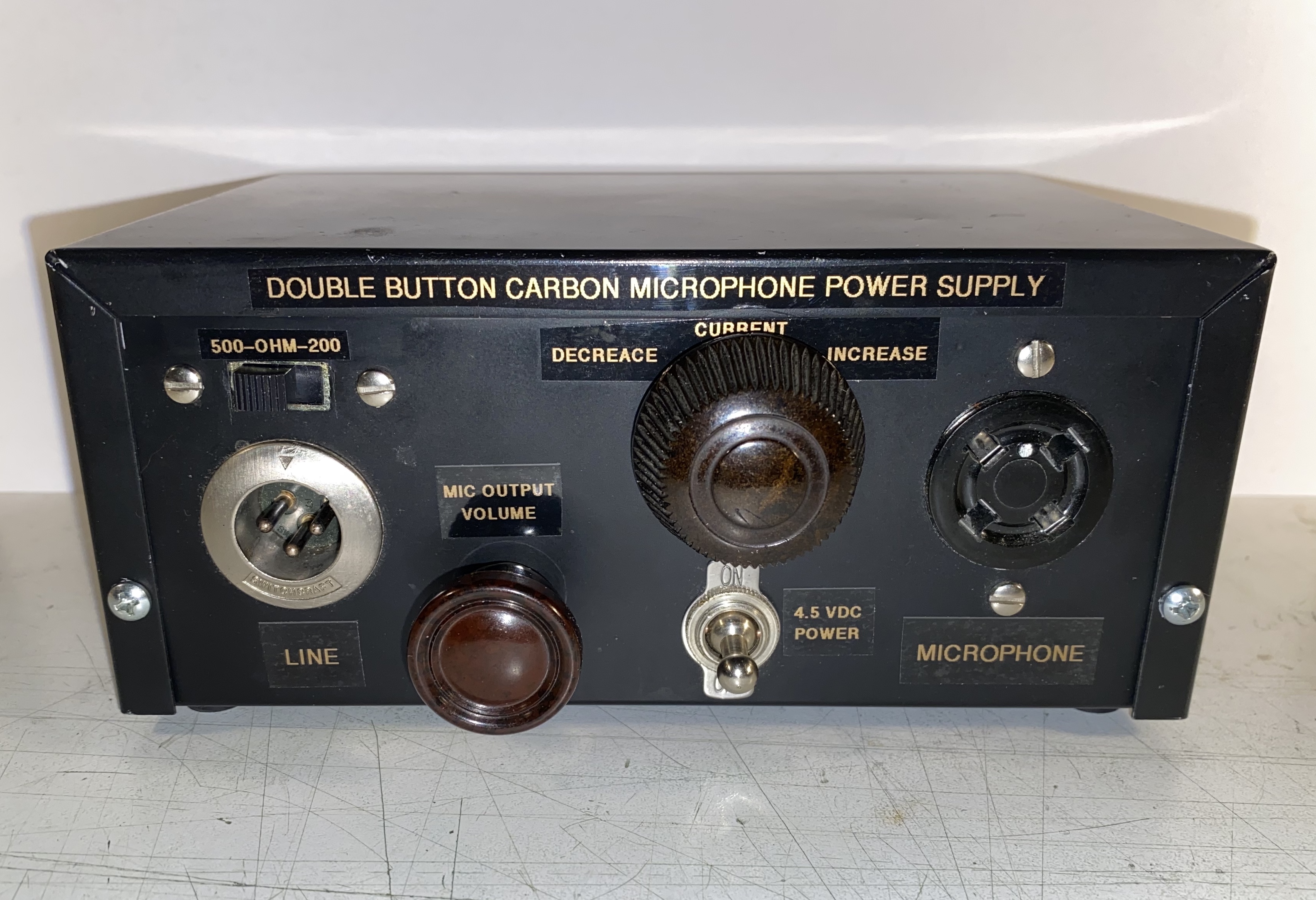

So Bronson and Gunnar.... what is not working about your carbon button microphones? They must be powered with 3-4.5VDC with a matching transformer to work. They will not work just plugged into a amp. The only thing that goes wrong is if the carbon granules have leaked out of the buttons. I suppose I could help you with making them work.

I have made several power supplies I use with my carbon button microphones:
This is a power supply and preamp I built to use my microphones through any Electrola Radio input.
