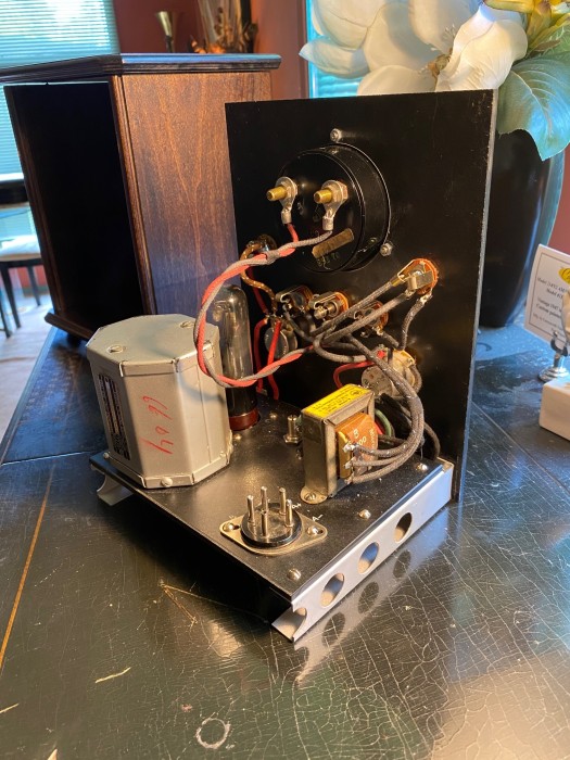

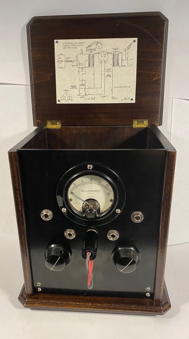

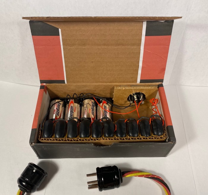

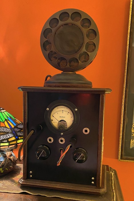

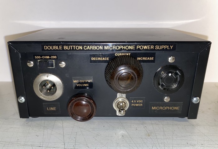

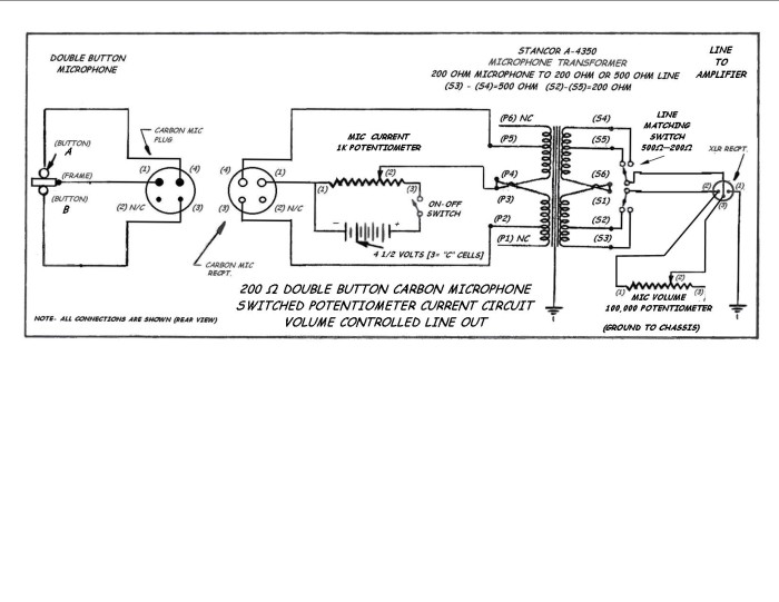

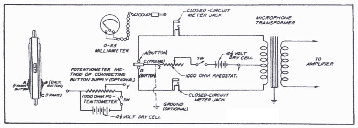

So Bronson and Gunnar.... what is not working about your carbon button microphones? They must be powered with 3-4.5VDC with a matching transformer to work. They will not work just plugged into a amp. The only thing that goes wrong is if the carbon granules have leaked out of the buttons. I suppose I could help you with making them work.
Here is a typical carbon button Mic power circuit.
I have made several power supplies I use with my carbon button microphones:
This is a power supply and preamp I built to use my microphones through any Electrola Radio input. This is the schematic for a simple power supply. Carlton Smith

Re: Anyone rebuild RCA home recording microphones?
Thanks for the detailed reply. I was reading open across the buttons and the center lead rather than the 200 ohms per button that the original spec calls for. I messed with the buttons and it read about 190 and 390 before going open again a few minutes later. Now they seem to have settled around 1.8k ohms. Further messing about could probably get it to the right resistance.
I'd definitely appreciate some advice on working on these.

This is some great information- I just assumed it would need rebuilding. Is there anything I should look for when I look at it next so I can see if it's OK or not?electrolaman 64 wrote: Tue Jan 10, 2023 9:03 am So Bronson and Gunnar.... what is not working about your carbon button microphones? They must be powered with 3-4.5VDC with a matching transformer to work. They will not work just plugged into a amp. The only thing that goes wrong is if the carbon granules have leaked out of the buttons. I suppose I could help you with making them work.
Double Button Carbon Button Microphone Power Supply- schematics 5-6-2020.jpg
