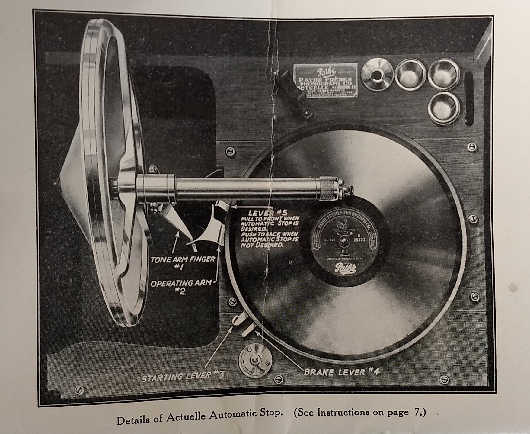

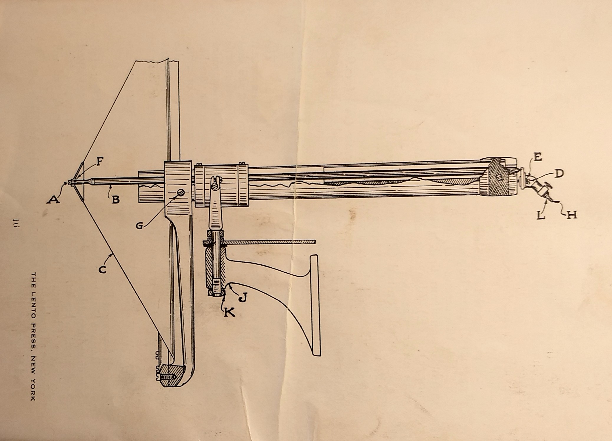

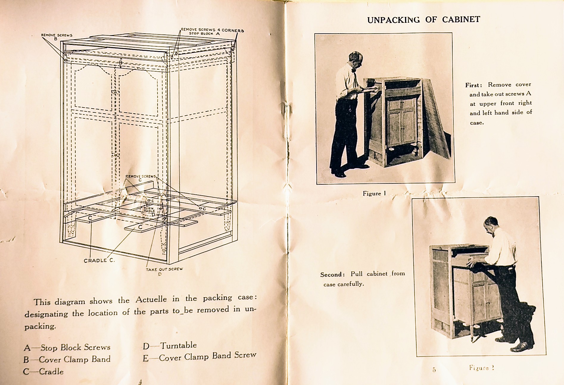

I did a posting of a Pathé Actuelle back in 2009. I acquired an electric model J. It came with numerous paperwork inside. Since then the photos got deleted. I was asked to update with new scans & photos. I hope this will help owners of these interesting machines.

Thank you so much for re-posting these images. My new (old) Actuelle is now a step closer to me being able to complete it. If anyone has the time to take a closer look, I would really appreciate a closeup of the rod that connects to the centre of the cone/diffuser. I will need to fabricate one as mine is missing. I would like to know if/where the original rod transitions from tube to bar so that it can be tapped for the 0-80 screw that goes through the cone/diffuser. That will help with my efforts to replace the missing part. It would also be useful to know the material from which it/they is/are made. Thank you
