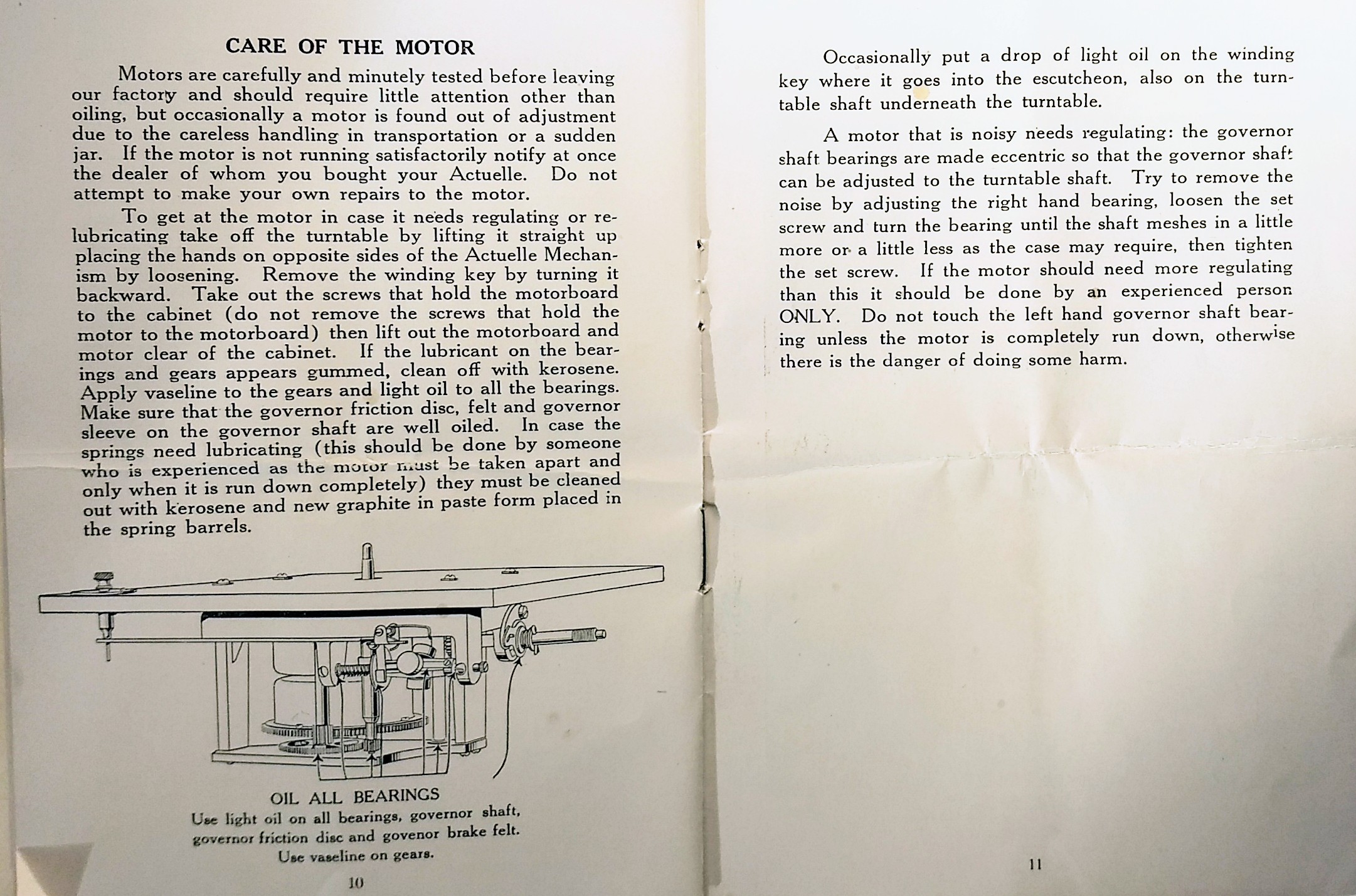

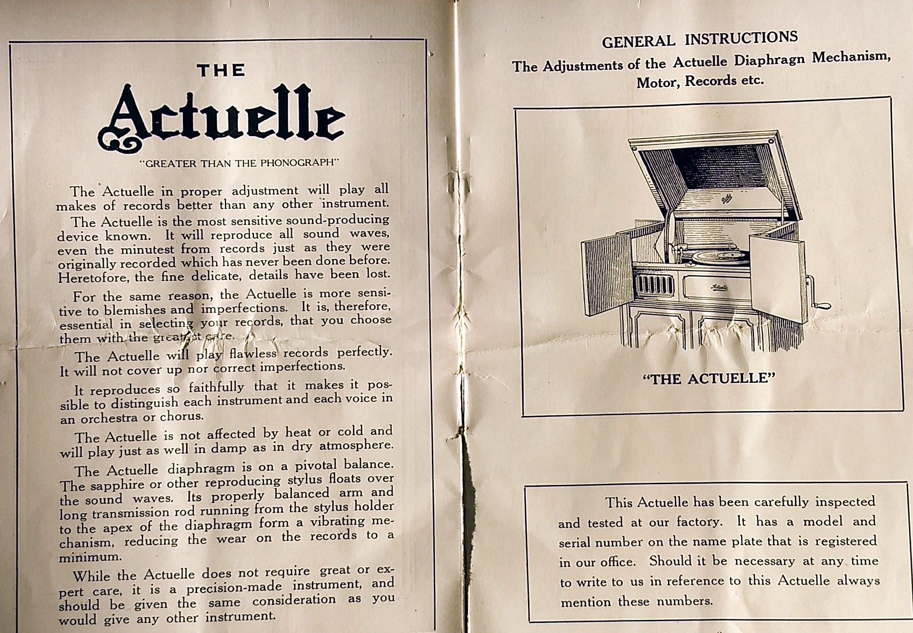

I did a posting of a Pathé Actuelle back in 2009. I acquired an electric model J. It came with numerous paperwork inside. Since then the photos got deleted. I was asked to update with new scans & photos. I hope this will help owners of these interesting machines.
