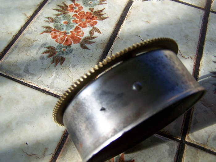

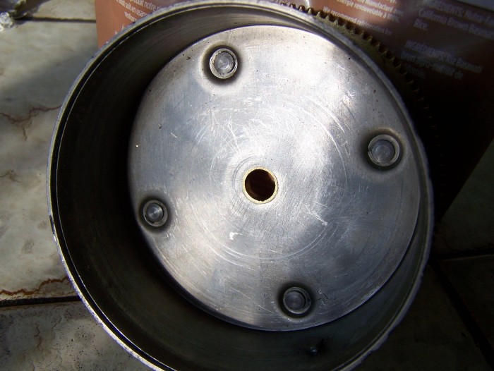

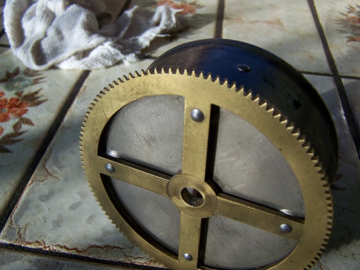

I have this, if you pay the postage from Canada, you may have it.
It did not fit my Victor II motor, even though the teeth are the correct number to fit into the worm, the pitch is different and it binds, so I don't know what it's off of.
It may work on yours though, I've put bushing in it too.

JeffR1 wrote: Thu Feb 23, 2023 6:37 pm I have this, if you pay the postage from Canada, you may have it.
Jeff, I really appreciate your offer. Unfortunately, the gear for my motor has much coarser teeth than the one shown in your pictures.

JeffR1
Posts: 572
Re: Victor II spring barrel brass gear
Post by JeffR1 »
Those are pretty common, it's these fine toothed ones that are hard to find, at least that's what I've discovered.
Someone here should have one of those.
Like this:
