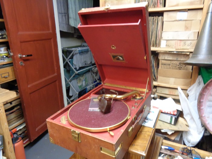

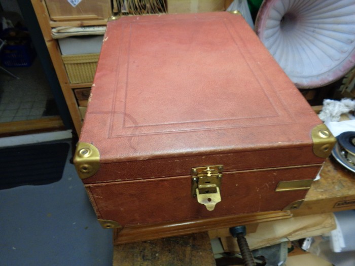

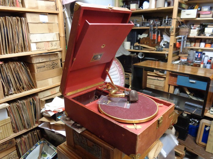

I could not resist this one, since I have never seen one for sale before in my area.
Unfortunately the sound box is lost, but I chose anyway to buy it, even if finding the gilt no 4 soundbox will be like looking for the needle in the haystack.
I upload some photos, since we have lost so many photos on the forum.
The covering is leather and not leatherette, right? Would shoe cream be an option to preserve the leather? I will not apply Swarfega on this one, I am sure it will destroy the leather..
The winding handle is found, according to the seller, even if I have not yet seen neither the gramophone, nor the handle.

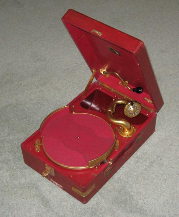

The leather used on the De Luxe 101 and 102 portables is paper thin, nowhere near as robust as leatherette.
The exterior of most surviving examples has faded badly and shows considerable signs of wear.
After gentle cleaning, my Red Leather 102 responded well to shoe cream. I used a car upholstery cleaner suitable for leather.

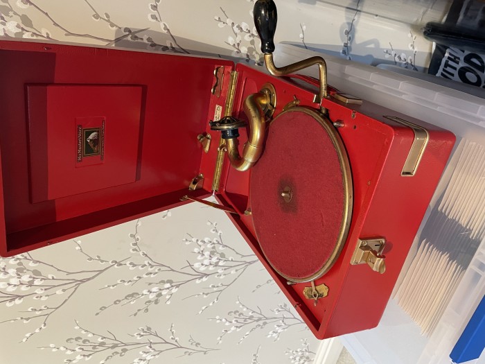

Post by leels1 »
The 102 deluxe I got was so far gone a paint job was the only option. It was only worth saving as the interior metal work was so good still. Here’s a pic
