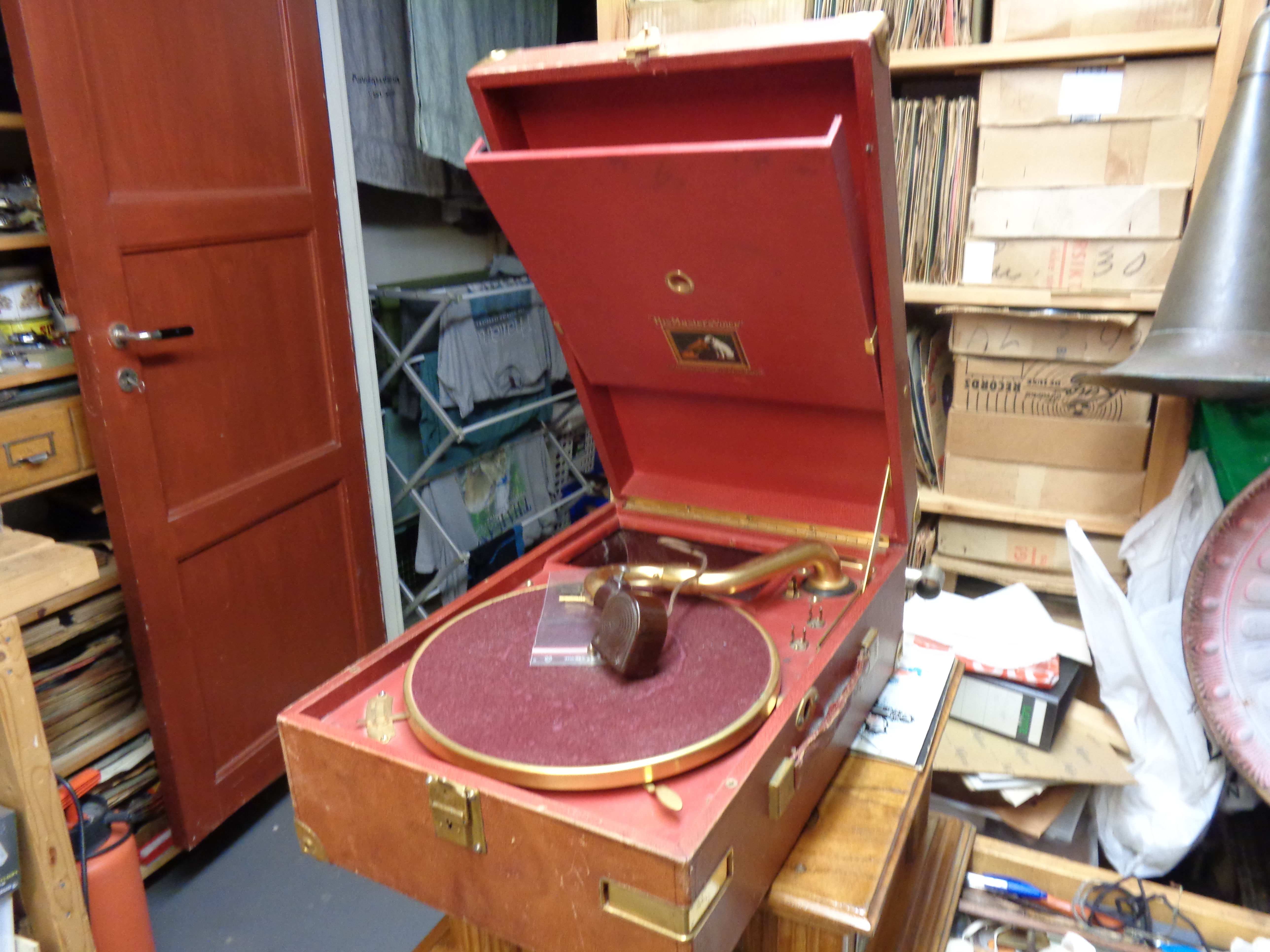

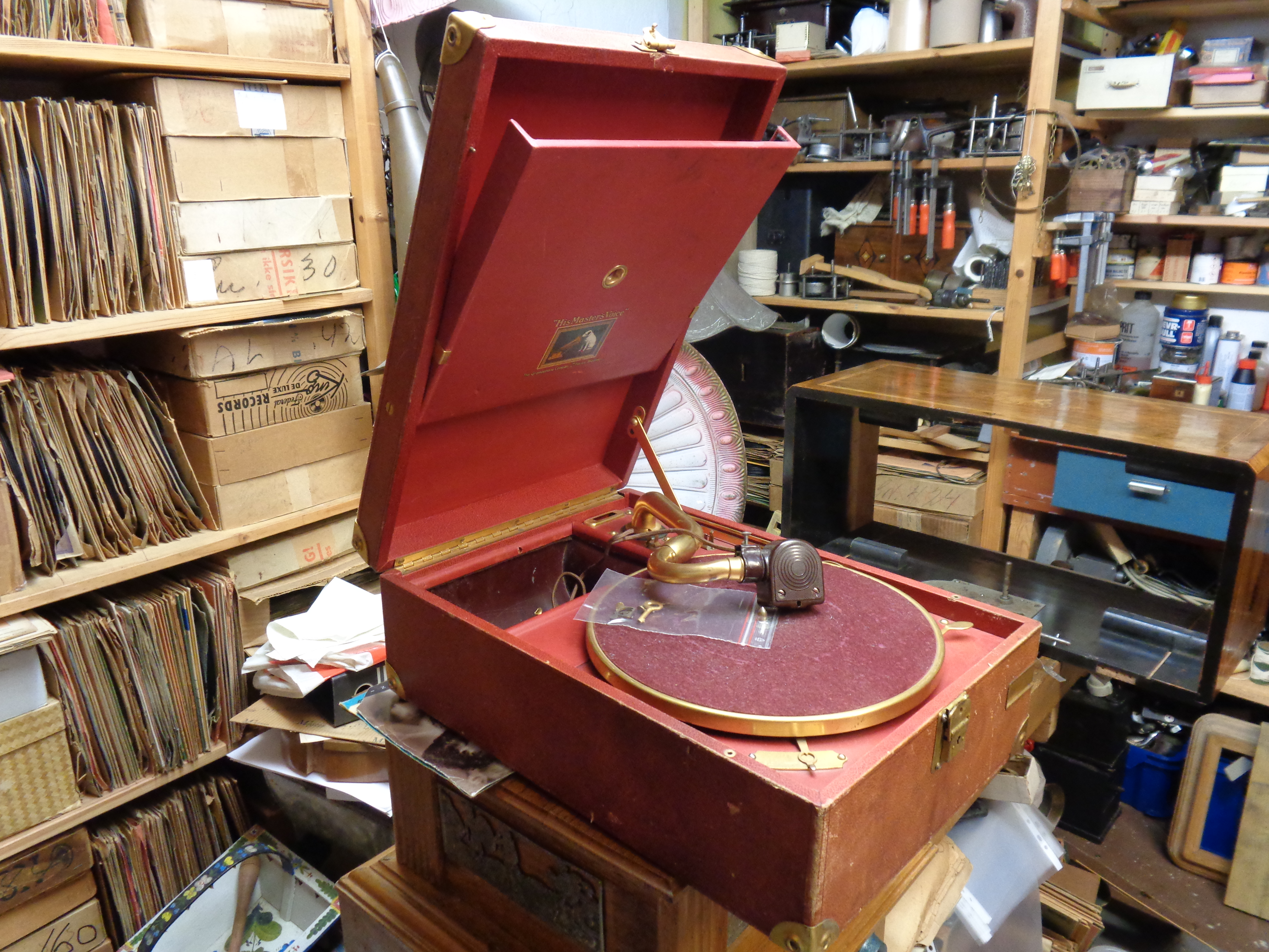

I could not resist this one, since I have never seen one for sale before in my area.
Unfortunately the sound box is lost, but I chose anyway to buy it, even if finding the gilt no 4 soundbox will be like looking for the needle in the haystack.
I upload some photos, since we have lost so many photos on the forum.

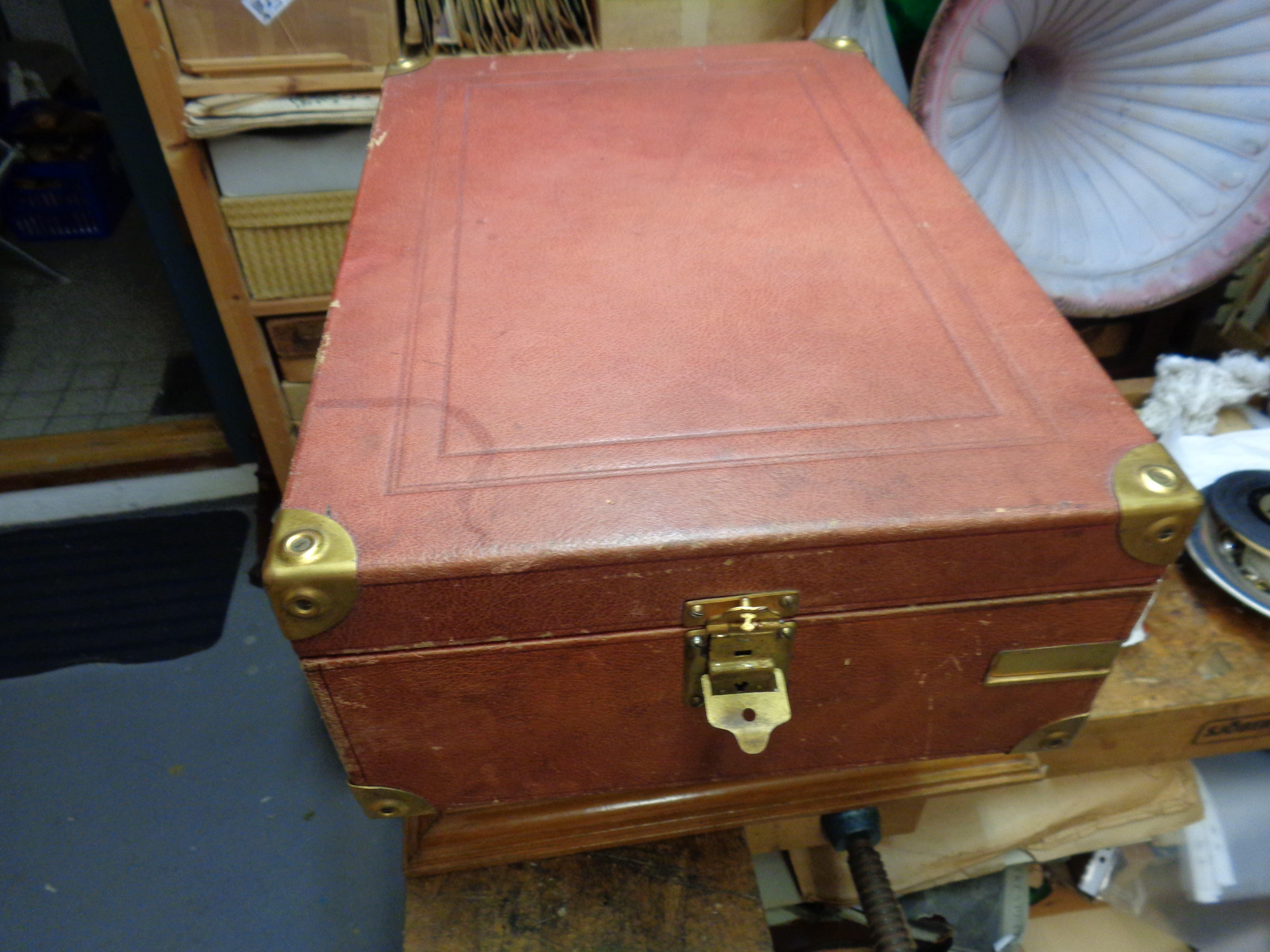

The covering is leather and not leatherette, right? Would shoe cream be an option to preserve the leather? I will not apply Swarfega on this one, I am sure it will destroy the leather..
The winding handle is found, according to the seller, even if I have not yet seen neither the gramophone, nor the handle.
HMV 101, red gilt

The leather used on the De Luxe 101 and 102 portables is paper thin, nowhere near as robust as leatherette.nostalgia wrote: Sat Mar 18, 2023 5:10 am
The exterior of most surviving examples has faded badly and shows considerable signs of wear.
After gentle cleaning, my Red Leather 102 responded well to shoe cream. I used a car upholstery cleaner suitable for leather.

I don't know if this is common knowledge or practice but I found to resurrect the red pigment all you need to do is gently remove the lacquer or sealing agent on the surface. Once I'd removed that the darkness of the red dye reappeared almost magically. I used a gentle abrasive soluble in water with a cloth. It dried a little patchy but I hardly needed any red shoe cream to bring it back to life. UV damages the pigment at the surface which is sealed into the leather. Rub through that layer and you might be surprised how dark the leather becomes without the need for additional dyes.
Roger is basically correct; the leather is quite thin but with that said I gave my 101 a real battering with the rubbing compound and it held up very well. It's tougher than you might think. I'd also soak the leather after cleaning it rigorously, with a leather care cream like AutoGlyn used on car leather seats. This replenishes the essential oils which have been lost. Leave it for at least a week before applying waxes or shoe colouring cream over the surface though.

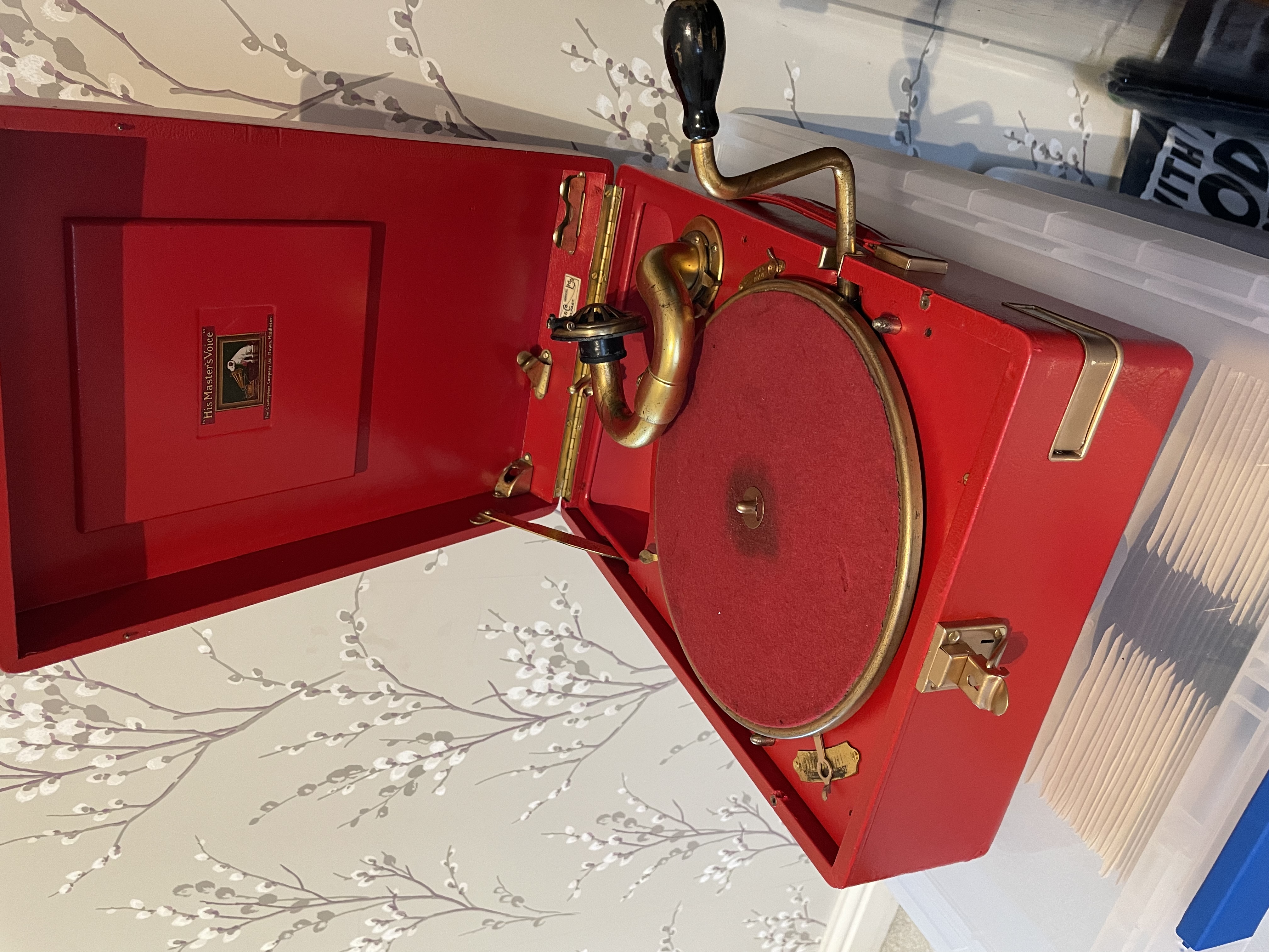

leels1
- Posts: 188
- Joined: Sat Jun 27, 2020 8:40 am
Re: HMV 101, red gilt
The 102 deluxe I got was so far gone a paint job was the only option. It was only worth saving as the interior metal work was so good still. Here’s a pic
