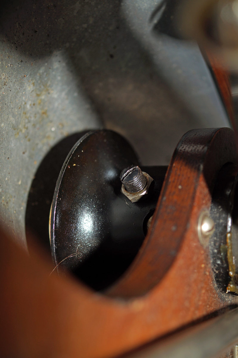

I can't recall seeing the brass coloured 'thing' on my HMV 100 - photo below with blue arrow pointing. Does anyone know what this is ?

It's a protruding bolt that looks brass in the picture, but on mine it's steel.poodling around wrote: Wed Mar 22, 2023 3:49 pm I can't recall seeing the brass coloured 'thing' on my HMV 100 - photo below with blue arrow pointing. Does anyone know what this is ?

Aha ! Thank you very much Barry.Phono48 wrote: Fri Mar 24, 2023 10:07 amIt's a protruding bolt that looks brass in the picture, but on mine it's steel.poodling around wrote: Wed Mar 22, 2023 3:49 pm I can't recall seeing the brass coloured 'thing' on my HMV 100 - photo below with blue arrow pointing. Does anyone know what this is ?
Barry
(I can't reach my HMV 100 at the moment due to so many things being on the gramophone room floor - but when I can I will have a look).

I found mine and as you say it is different to the brass one shown above.Phono48 wrote: Fri Mar 24, 2023 10:07 amIt's a protruding bolt that looks brass in the picture, but on mine it's steel.poodling around wrote: Wed Mar 22, 2023 3:49 pm I can't recall seeing the brass coloured 'thing' on my HMV 100 - photo below with blue arrow pointing. Does anyone know what this is ?
