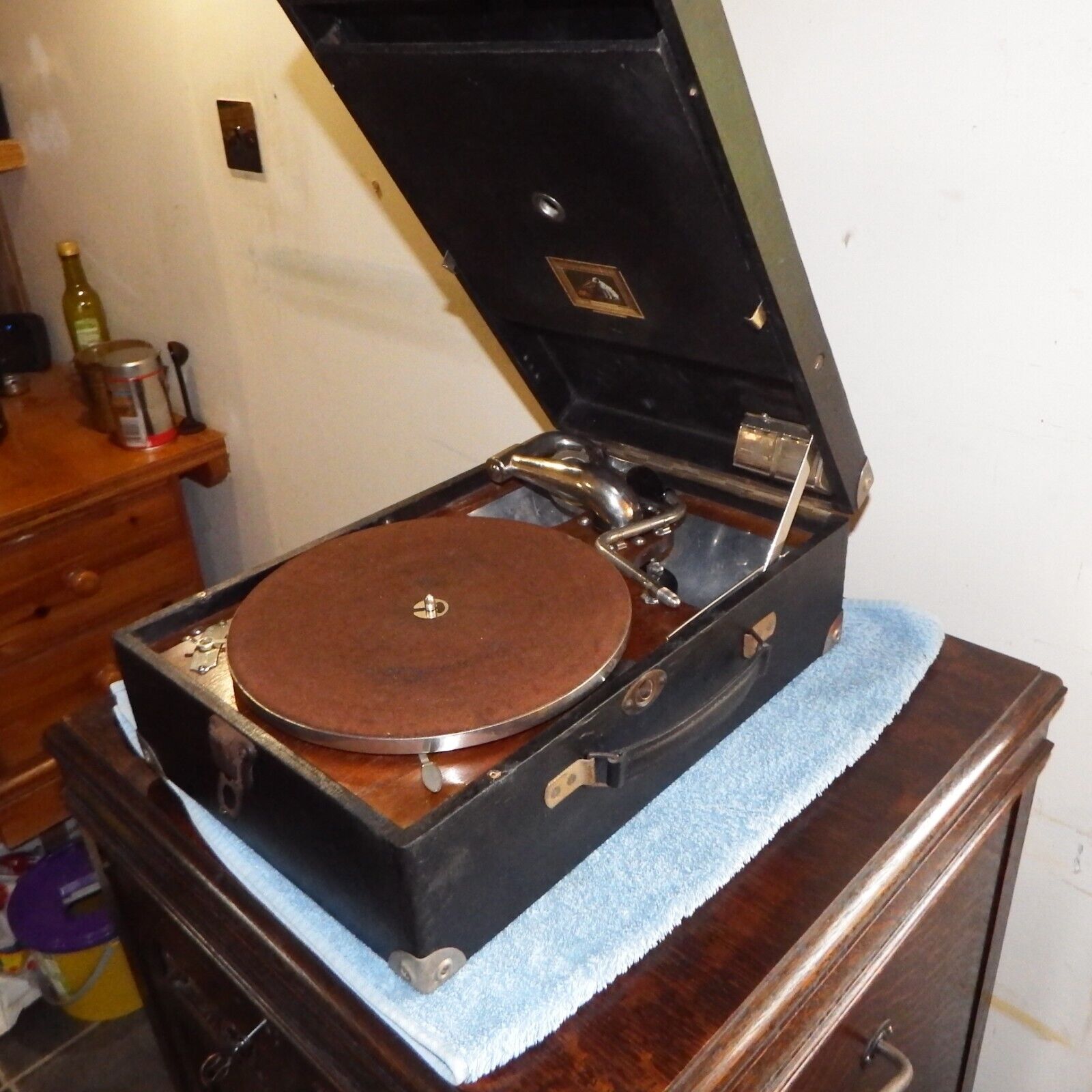

Very interesting indeed. The account the seller gives is:
'Gramophone HMV 100 unusual! serviced playing as it should.
When I acquired this gramophone I was not sure of the side wind on a HMV 100, However after some research I have gleaned that HMV were supplying this model up to 1928. They had ceased production of the model in 1925-26 but as factories abroad closed unused stock was returned to the Hayes factory. Cases and motor boards predrilled to except the front wind motor that had now become obsolete. So as cases cost a lot to make as did the motor boards, they decided to fit them with the new side wind motors that they had and sold them as a cheap alternative to the new 101.
It's not perfect a few marks here and there the lid is tight to close but it is genuine. There are lines on the lid, looks like something heavy was stored on it,
Can come with 6 random records for an extra £5
Any questions feel free to ask'
I must admit I have never heard of this before but of course I don't know everything.

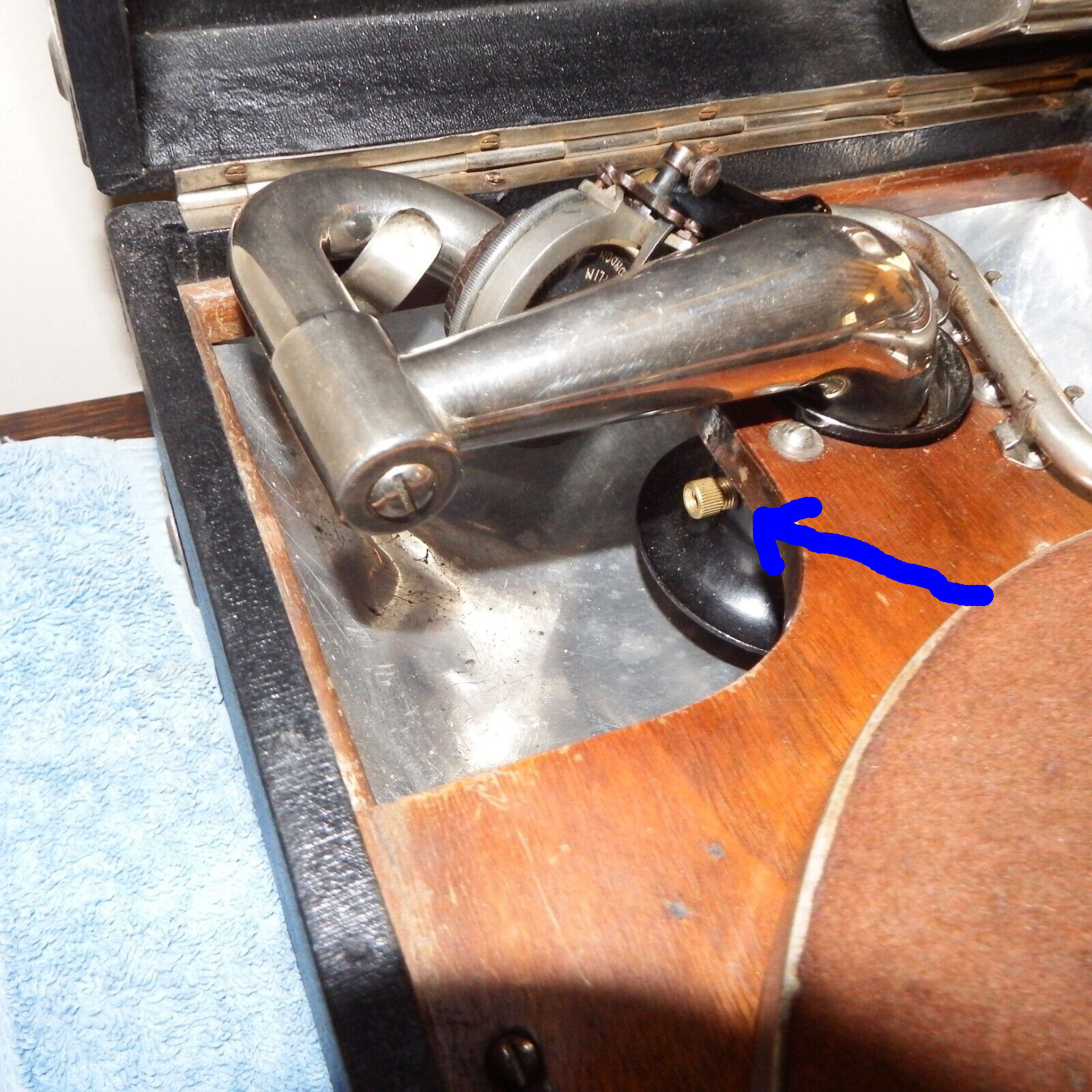

I can't recall seeing the brass coloured 'thing' on my HMV 100 - photo below with blue arrow pointing. Does anyone know what this is ?

A frankenphone?

Steve wrote: Thu Mar 23, 2023 4:27 pmA frankenphone?
That was my initial thought too. Wouldn't be difficult to achieve . Also notice .... look closely and there are witness marks in the lid where a lid - stay was formerly on the left hand side , so something has been going on here. Early model 100's did have a left handed lid stay , and no it couldn't have been transplanted to the right hand side as being handed , the stays are different. ( I have had both left handed and right handed lid stay model 100's in the past ) Another observation .. it looks as if the lid hinge has been messed around with at some point , as its not lying entirely flat between its fixing screws -- usually a sign of a ham - fisted attempt to remove stubborn or rusted wood - screws. I would recommend caution as obviously the seller's story explaining its origins is unreliable to say the least !
Hmmmm very interesting indeed ! maybe . perhaps , I wonder !! :lol:
Posts: 5797
Re: Side wind HMV 100 !!!! ????
Another indication that this machine may have started life as a 101 is the rubber feet on the bottom case corners.
If memory serves, the 100 and the earliest 101's were not fitted with these feet.

epigramophone wrote: Fri Mar 24, 2023 5:25 am Another indication that this machine may have started life as a 101 is the rubber feet on the bottom case corners.
My HMV100 has metal corner fittings but does not have feet, neither. Its winder is located in the front, and its lid stay (that looks like the same as the 101) is on the right side. I am not familiar with variations over its production life, though, but I agree that the one in discussion appears to have undergone a transplant operation.

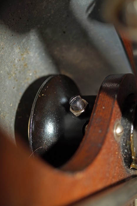

poodling around wrote: Wed Mar 22, 2023 3:49 pm I can't recall seeing the brass coloured 'thing' on my HMV 100 - photo below with blue arrow pointing. Does anyone know what this is ?
It's a protruding bolt that looks brass in the picture, but on mine it's steel.

Phono48 wrote: Fri Mar 24, 2023 10:07 am
Barry
Aha ! Thank you very much Barry.
Barry
I found mine and as you say it is different to the brass one shown above.

Even with my best Columbo head on, I can't figure this 100 out. As Dulcetto said, there are witness marks and holes on the left side of the lid possibly indicating where a lid stay might have been but the same lid itself has the right hand needle bowls, which is wrong for a 101. Only the 100 has this lid configuration!
