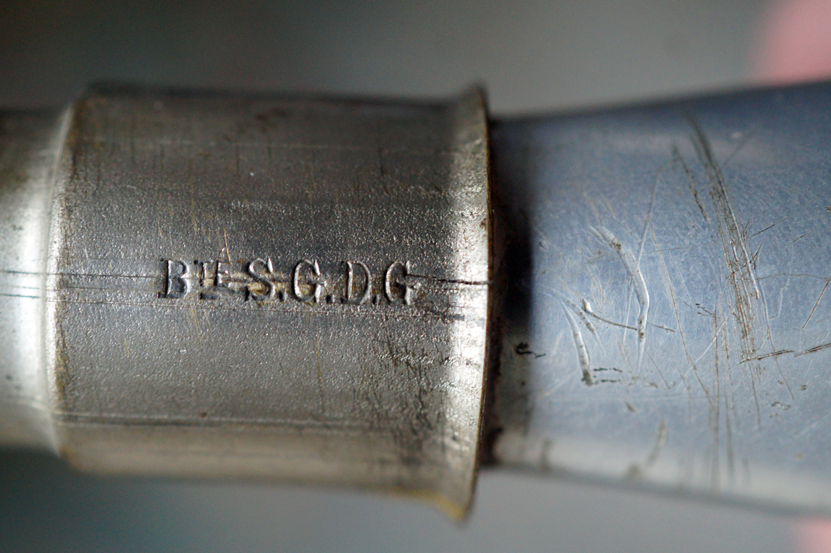

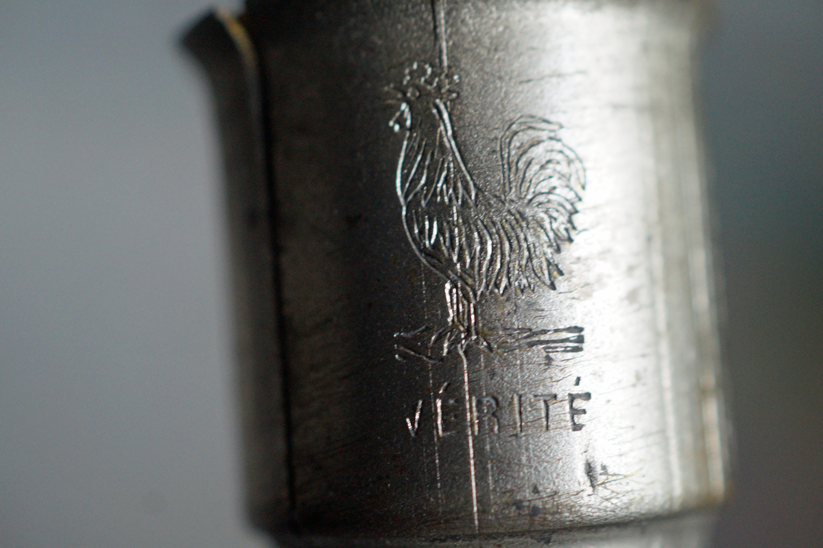

On the Pathé horn it states two things:
1. What looks like 'VERITE' - what does this mean please ?
2. Also, 'BTE SGDG' - which having looked at the internet seems refer to patents which have no government guarentee. What does this actually mean though ?

Verité was a system from Pathé, don't know what consisted in. Breveté SGDG I don't know the exact meaning, butt all French things patented carry this notice. maybe means patents pending or something similar.
Maybe one of our French versed colleagues sheds more light...

Brevété SGDG (¨sans garantie du gouvernement¨) is the French patent system used at the time - translated as ¨patented with no government assurance¨.
The Verité system consists of a suspension made of a frame made of bent wires that cradled the horn and the reproducer: that frame was fixed to the base of the machine, and supposedly increased the fidelity of the reproduction. It was sold as an optional gadget, a French version of the US snake oil. The knob shown is part of that Verité system, I think.

Here's PDF copy I made of a webpage showing the "Système Vérité" --
I tried posting the link, itself, but when I clicked on it to test it, I was greeted with a "not found" message. Seems that this may have been an archived page, though I was able to bookmark it and call it up in my browser.

Fantastic ! Thank you OrthoFan, I now know what that is.OrthoFan wrote: Mon Mar 27, 2023 6:50 pm Here's PDF copy I made of a webpage showing the "Système Vérité" --
Pathé COQUET CYLINDER PHONOGRAPH.pdf
