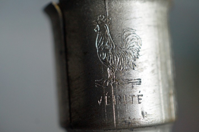

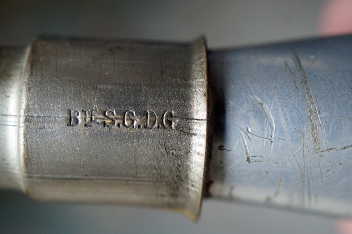

On the Pathé horn it states two things:
1. What looks like 'VERITE' - what does this mean please ?
2. Also, 'BTE SGDG' - which having looked at the internet seems refer to patents which have no government guarentee. What does this actually mean though ?

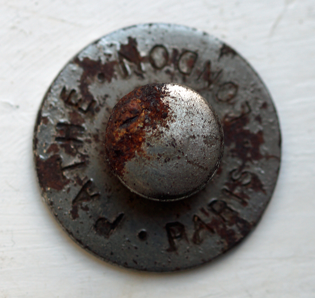

3. I also have a 'Pathé weight' which I think is used to balance on top of the reproducer ? This would create more pressure on the cylinder I guess. Why would this be necessary though ?

Verité was a system from Pathé, don't know what consisted in. Breveté SGDG I don't know the exact meaning, butt all French things patented carry this notice. maybe means patents pending or something similar.
Maybe one of our French versed colleagues sheds more light...

Re: Pathé phonograph horn and reproducer 'weight' questions
Brevété SGDG (¨sans garantie du gouvernement¨) is the French patent system used at the time - translated as ¨patented with no government assurance¨.
The Verité system consists of a suspension made of a frame made of bent wires that cradled the horn and the reproducer: that frame was fixed to the base of the machine, and supposedly increased the fidelity of the reproduction. It was sold as an optional gadget, a French version of the US snake oil. The knob shown is part of that Verité system, I think.
Here's PDF copy I made of a webpage showing the "Système Vérité" --
Fantastic ! Thank you OrthoFan, I now know what that is.OrthoFan wrote: Mon Mar 27, 2023 6:50 pm Here's PDF copy I made of a webpage showing the "Système Vérité" --
