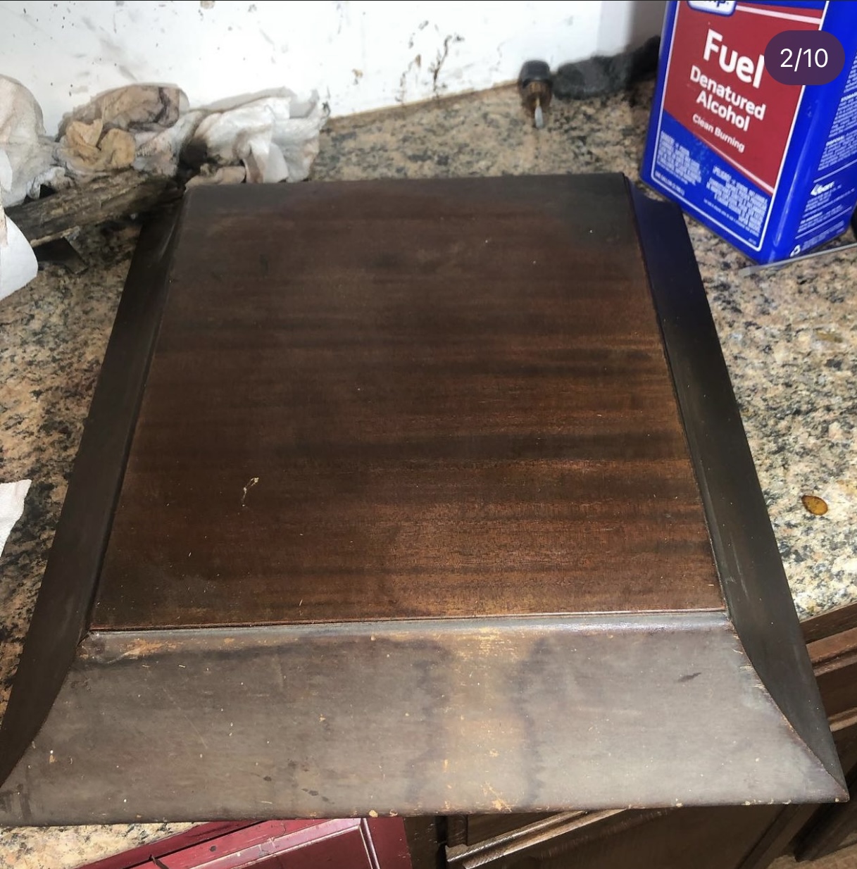

Mahogany is definitely harder to refinish than oak… so if you do go that route be prepared for it to take awhile. Because it’s a softer wood…. It’s real easy to get deep sanding marks. And they’re pretty visible.
I second James idea for denatured alcohol. Take this lid I did with just denatured alcohol for instance. If you take your time with it… you can really bring a finish back to life.
Cheers

I’ve always been a little cautious about using the denatured alcohol. I’ve always wanted to try and bring back the crackled shellac with this method but never had the “pelotas” to do it.
Too afraid it wasn’t the correct shellac or finish it would work on…
Nice to see an example of how it works…

I was trying to remember mahogany restoration & suddenly remembered I've already fixed a small clock like this. This is a 1920 Sessions "American No. 1" eight-day clock which I bought on eBay and then got a refund on when it arrived totally destroyed. The case had come apart at the seams, the pendulum was broken, & the fly on the strike train was rather mangled. I ended up repairing it all and refinished it with alcohol. If I'd been feeling fancy I'd have mixed up some shellac & done a few coats of that--This might be what I do to freshen up the Victrola.
There are a few smudges on it from wax. I was in a hurry to go to sleep & blew out the candle a little too vigorously; didn't see the mess until next morning.
If I remember right I basically washed the clock in denatured alcohol, with the case of it completely disassembled. Rubbing it around on the surface of the parts floated the original finish off the clock, but didn't seem to hurt the grain filler or stain any. This was nice; it lightened it a shade but that was mostly the decaying shellac with a coat of contaminants that darkened it further. The clock is definitely brown, not the bright red mahogany on the Victrola.
And David--I know you know what alcohol does to finishes. Remember being out there in the barn at half past midnight when we were working on this thing? I still wish we'd taken "before" pictures because this was almost black.

Flying Dutchman wrote: Fri May 05, 2023 9:17 am I’ve always been a little cautious about using the denatured alcohol. I’ve always wanted to try and bring back the crackled shellac with this method but never had the “pelotas” to do it.
I have only played with this method a few times but had some reasonably good success. One of the secrets to a good outcome is to get the original finish as clean as possible or you'll just be mixing the dirt into the re-melted shellac.
