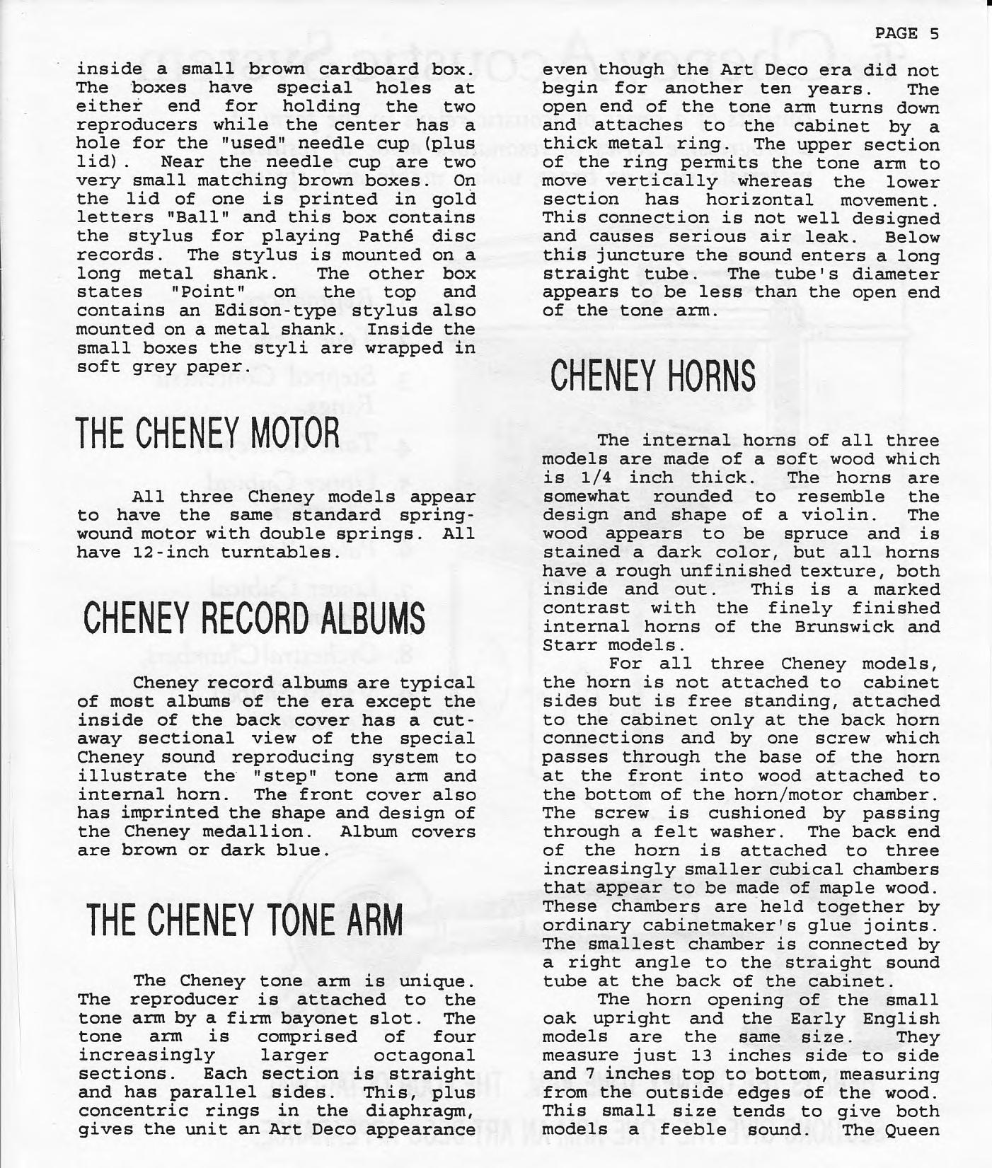

The Cheney reproducer diaphragms were made out of Gutta-percha -- https://en.wikipedia.org/wiki/Gutta-percha .
Here's a description of the reproducer culled from https://archive.org/details/V78J5
(Click images to view full size.)
R.J. Wakeman wrote an excellent book about the Cheney Talking Machine which is available online for members of the Antique Phonograph Society -- https://www.antiquephono.org

In case you haven't seen this:
Cheney Owner's Manual -- https://www.nipperhead.com/old/cheney.htm

The manual is very helpful, I had no idea about the needle adjustment according to the length. Thank you for posting.
