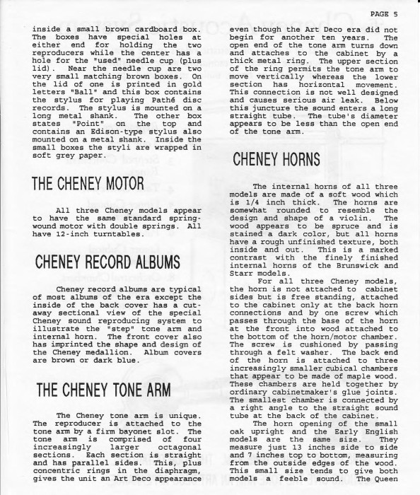

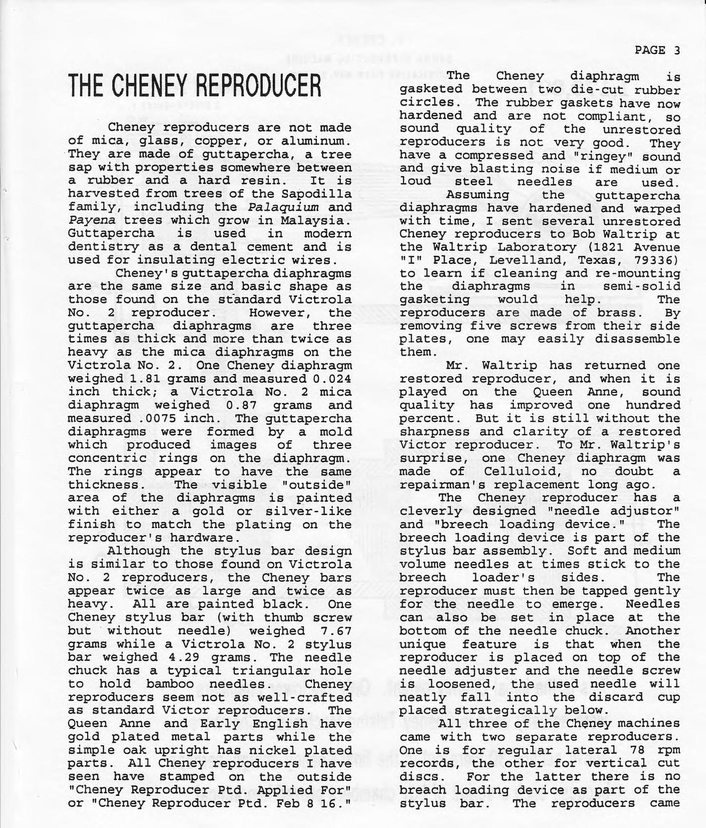

The Cheney reproducer diaphragms were made out of Gutta-percha -- https://en.wikipedia.org/wiki/Gutta-percha .
Here's a description of the reproducer culled from https://archive.org/details/V78J5
(Click images to view full size.)
R.J. Wakeman wrote an excellent book about the Cheney Talking Machine which is available online for members of the Antique Phonograph Society -- https://www.antiquephono.org

Cheney have both lateral and vertical reproducers you just have to look on ebay or maybe a member has a spare. I sent my reproducer to Wyatt Markus to rebuild because they have two small rubber isolators that need to be changed out in order for the reproducer to sound correctly. Hope this helps.
