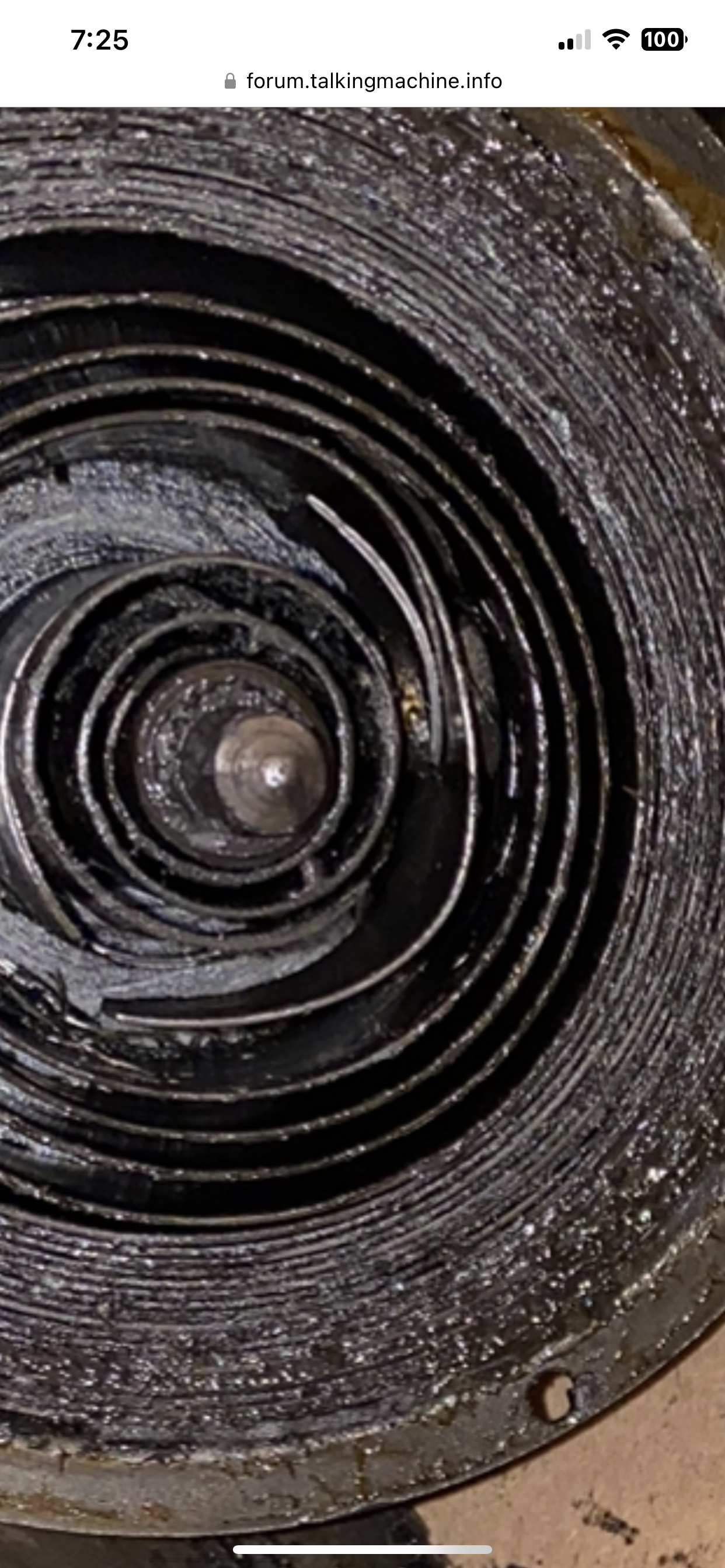

Here’s a zoomed in picture. A flat head screw was put through and a nut on the back to hold the pieces together.
David
