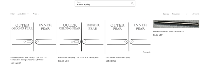

I am working on this Sonora for a customer and it needs 2 new springs. Can anyone tell me which spring I need to order from Brian? Is the third one from left the correct option?

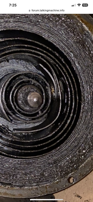

And can someone please explain why folks in the past fixed springs like this? (click on last picture to see broken spring) This is at least the third time I have seen this kind of repair :roll:

I don't see your repaired spring image, but as to why folks, (like me), repaired springs, it's because there was a time with no internet, making it easy to find and source such things as new springs. Unless you somehow stumbled upon a club, such as the Michigan Antique Phonograph Society, MAPS, and found out about parts suppliers, you were left to your own devices to repair your phono motor. Putting a new end on a spring is an acceptable repair to an otherwise good spring. Riveting a broken sping together is a bit problematic. Although, my dad did that once and it lasted for 45 years and is still going today.

Here’s a zoomed in picture. A flat head screw was put through and a nut on the back to hold the pieces together.

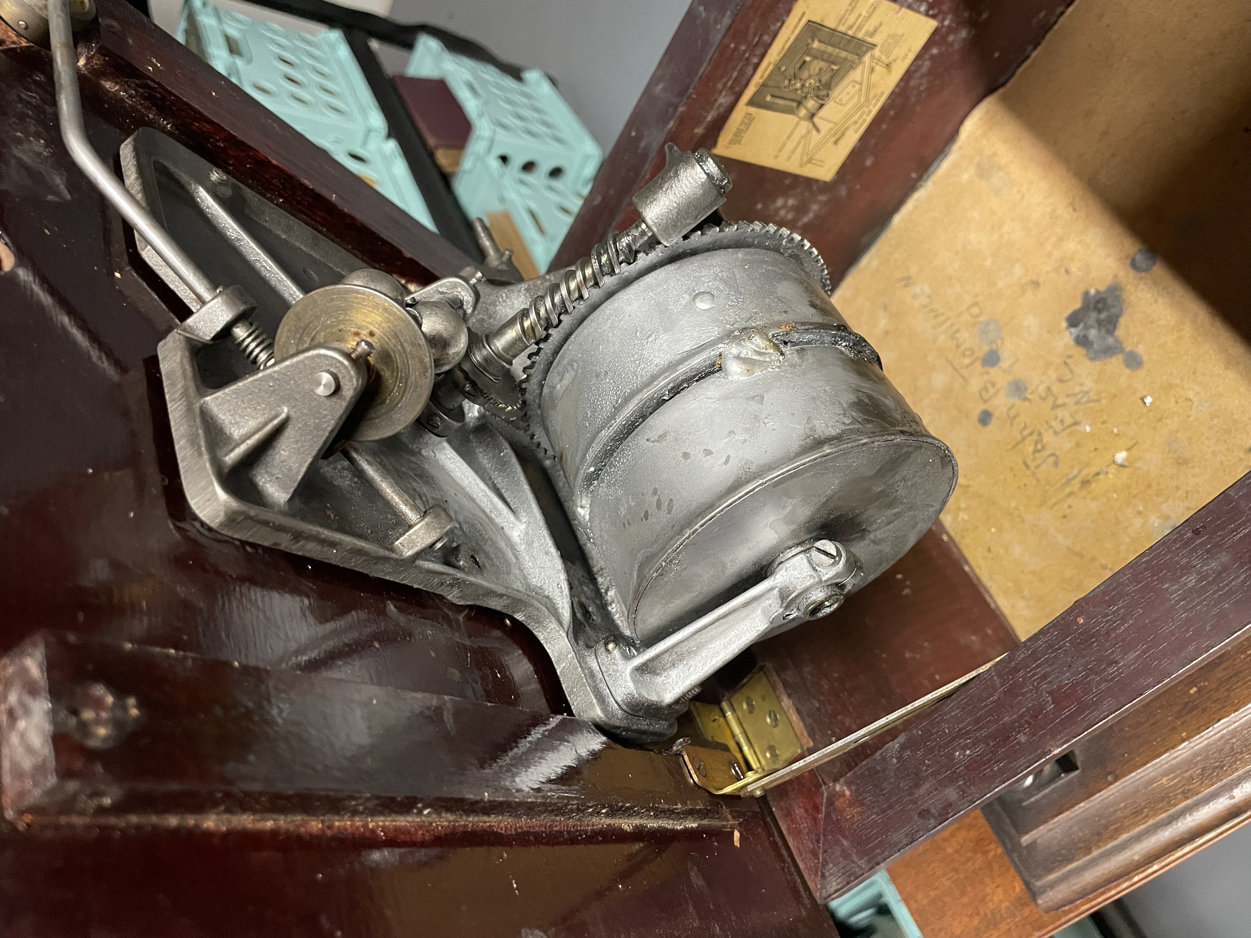

David

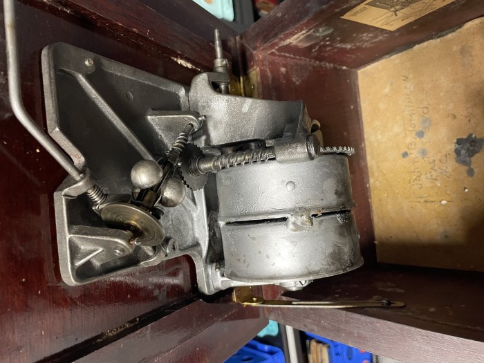

Be glad they just fixed the spring. I'm currently working on a Victor IV were someone in the past simply welded the two spring barrels together, essentially making it a one-spring machine :evil: In order to make it look "better" they then painted the motor in radiator paint, the type that gives you silver fingers even decades later. The person was so proud of his job, he wrote his name and address on a paper inside the machine. Hillbilly repairs are the worst :roll:
Andreas

Also, I figured out which spring... it was HQ82 on Brian's website.

alang
VTLA
Posts: 3116
Personal Text: TMF Moderator
Location: Delaware
Re: Sonora Spring Replacement Help
Post by alang »
As requested :roll:
pallophotophone
Post by pallophotophone »
I'd hacksaw the 2 barrels apart and grind off the weld remnants if I were facing that situation. An awful PI the tuchas , I know !!
