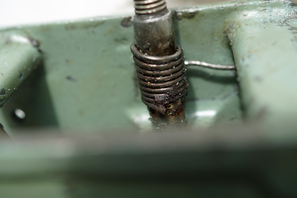

leels1 wrote: Tue Jul 04, 2023 4:09 pm I’ll go for mrrgstuff’s solution. I’ve tried it and it works. I also have no lathe!
If the whisk doesn’t work, a wire coat hanger, stripped of the plastic will. You might get away with the whisk to be fair as it’s a small motor.
I used a drill bit and a pair of mole grips and pliers. Use a bit just smaller than the shaft of the winding spindle.
I clamped one end of the wire to the drill bit, then held it vertically in a vice. Then start to wrap it round with a pair of pliers to keep it close to the bit. Eventually it’ll work, just make sure it’s long enough. Then, put the loop in to anchor it. It’s hard work and you have to try and be dexterous to move the pliers round without letting go, or it’ll not be an equal wind.
The most important part- ensure you wind it the correct way round, else it’ll do exact the opposite and not hold the wind! I found this out the hard way.
It will go on the shaft with a bit of fiddling.
Someone told me the action of wrapping the non- springy material round, in fact adds some spring when it’s done.

Okay, so last night I started work on the non-return spring .................. until about 1.30 in the morning !
The good news is that re-using the existing spring seems to have worked ! The odd thing was that re-shaping it was quite easy. The difficult thing was trying to get the securing screw to work. It just would not fit back in the hole. Then I remembered that a long time ago I bought a selection of old gramophone screws and one of those fitted perfectly !!! It is far too long but I intend to hack-saw it later so it fits under the motor board.
I assume that because there is now 'less spring' to grip the spindle that may be a problem ? Perhaps the more the main-spring is wound the greater the pressure on the non-return spring ? I am unsure. Maybe it would be wise not to wind the main-spring too much so the non-return spring is not under too much of a work-load ?
Anyway, hopefully this part of repairing one of my (very unusual) gramophones is going well. Next step, trying to repair a pot metal tone arm which has snapped in half (is this even possible ?) and finding the correct motor-board speed control for this Collaro motor - as this part is missing.
I attach four photo's - one of the broken part of the non-return spring with the screw which refused to go back in, the over-long replacement screw which needs a hack-saw, the 'reduced' non-return spring and finally, where it is attached.
Thanks everyone for your help. Happy days always !!!!

I am sorry that you could not re-use your non-return spring. You mentioned earlier in this thread that you may try to make a new one from a whisk or a coat hanger. I hope that was successful. By coincidence I was out and about a week or so ago and came across some wire coat hangers. So I bought them thinking that they may have a gramophone use one day !
I am careful not to wind this gramophone up too much incidentally, in case the now shorter non-return spring slips or breaks . I guess the more the main-spring is wound the more the non-return spring has to deal with more tension ?
