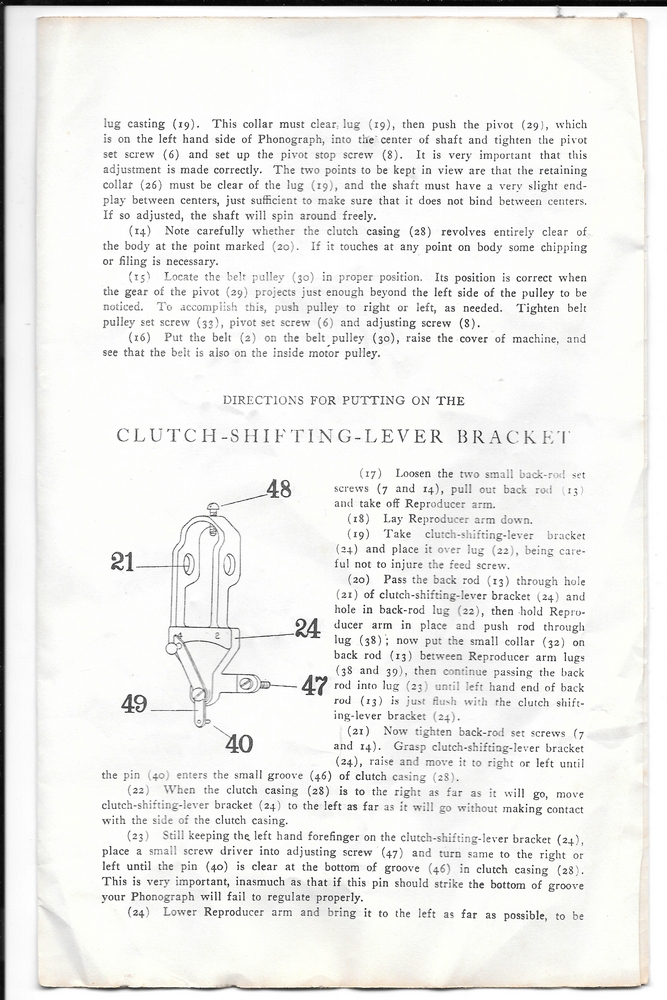

Hello, all. I have an Edison Home A parts machine with a 2/4 minute conversion kit installed, and I would like to remove it so I can use it on another machine. I have removed Standard conversion kits, but never one from a Home. Can anyone offer instructions or tips on how to do so? Pictures would be very helpful, too, if possible. Thank you.

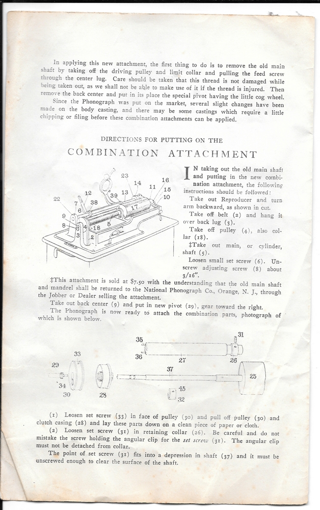

Here are images of the Edison Home A, B, and C installation instructions from the National Phonograph Company (Edison). This should at least get you started.
Shawn

Well, that sure looks like installation will be a breeze.........

Easy as 1, 2, 3, .... 40 ... 50

Use caution because there are differences in the conversion kits for various Home models.

Thanks Jerry .. Is there a way to identify which kit goes with the appropriate phonograph. Tom

I believe they are identified with a small letter corresponding with the Home model.Thanks Jerry .. Is there a way to identify which kit goes with the appropriate phonograph. Tom
