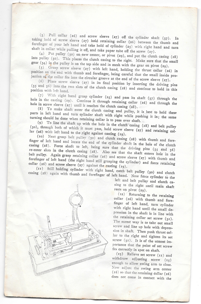

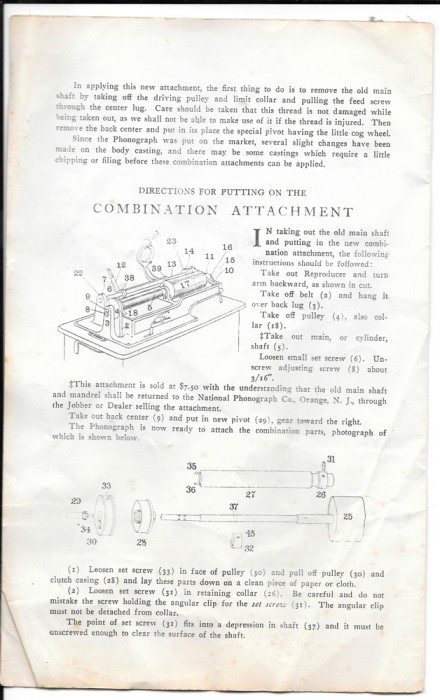

Here are images of the Edison Home A, B, and C installation instructions from the National Phonograph Company (Edison). This should at least get you started.
Shawn

Well, that sure looks like installation will be a breeze.........

Easy as 1, 2, 3, .... 40 ... 50
