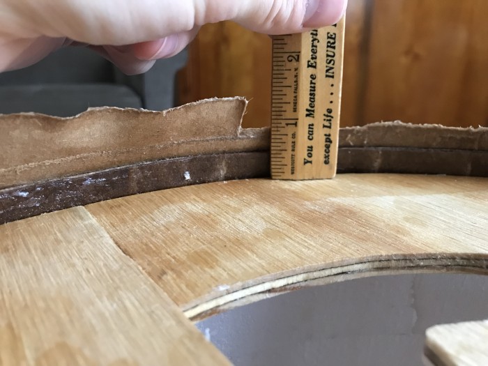

The former partially pushed out of the horn—about ⅜”:

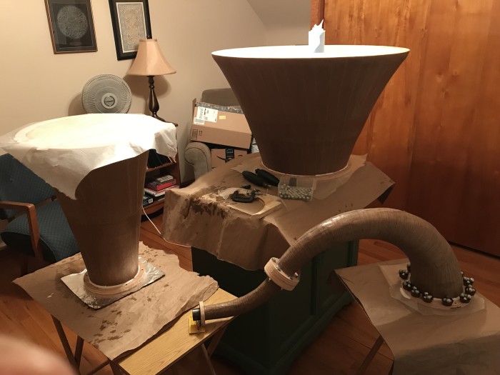

The horn sections (the bell halves on the formers, the neck off), with mounting rings in place:

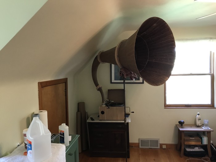

More photos--
The complete horn--the B-39 technically could support itself and the cabinet could hold it up without quite tipping over, but at least with the current neck thickness (~3/16"), the B-43's bell is too heavy for the neck to support safely, and the whole thing is too heavy for the cabinet to hold up, so some sort of external support is necessary--a bridge lamp is currently fulfilling the role:

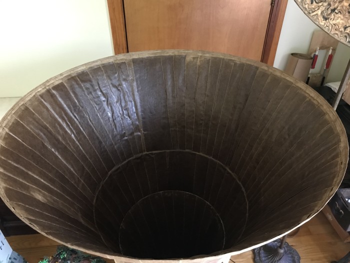

The wrinkled paper inside the mouth:

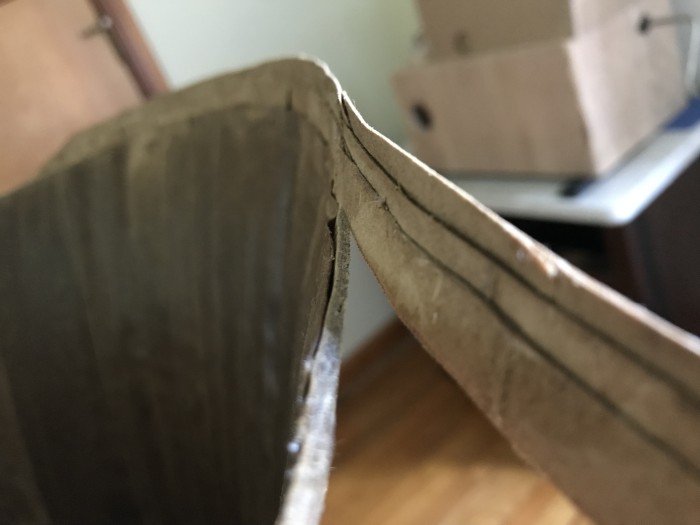

Shrinkage of of individual layers of paper at the mouth rim--each layer was initially trimmed right to the edge of the former, not staggered as pictured below after the shrinkage (which also made the horn contour slightly concave right at the rim, hence the need to trim some off):
