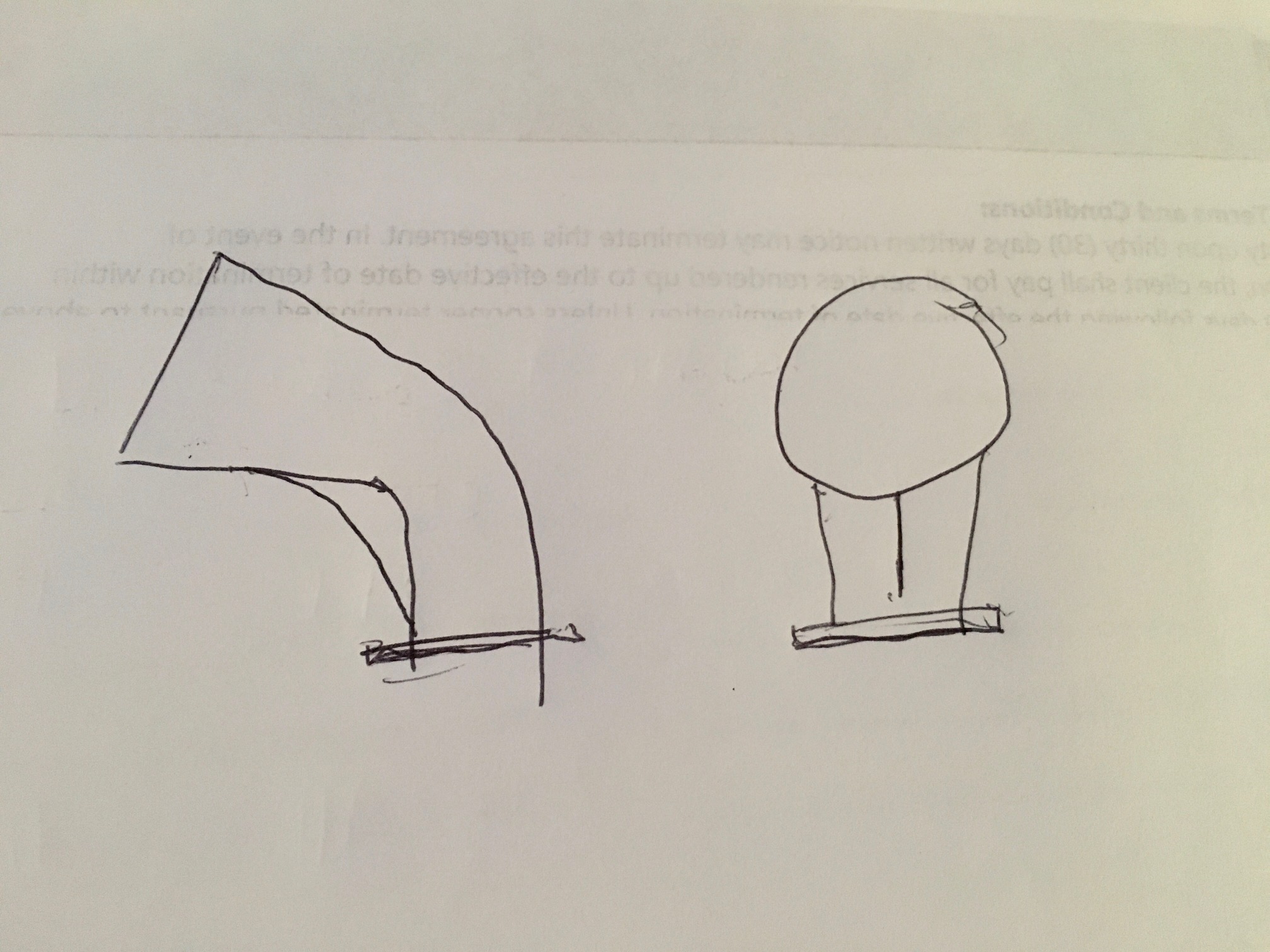

Regarding the elbow I have never heard of an OEM Victor product/elbow to take the size of the 23" horn. I have seen an elbow that had a blade/support soldered in along the bottom of the elbow to help resolve the potential for collapsing the elbow. That was on a fancy Victor D years ago. I believe your OEM elbow is safe to take the mass of the horn, however I would worry about anything that could fall on the top half of the horn pushing the bell down causing additional pressure on the elbow itself - that would be a bad day IMO.

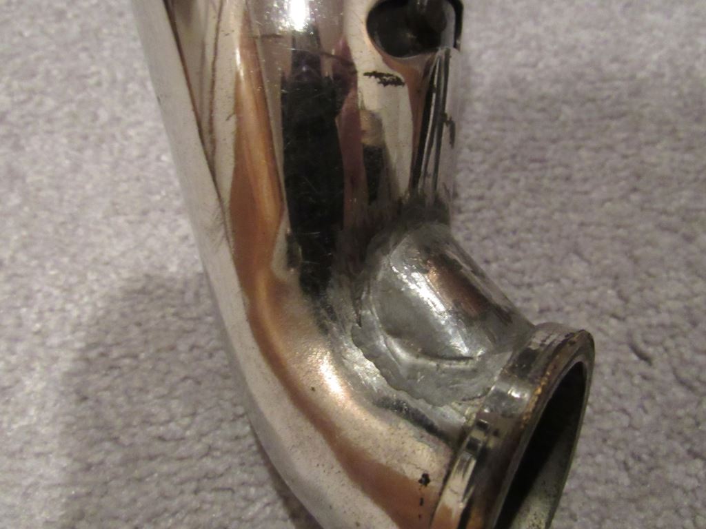

I took a closer look at the elbow. Here's the Pic. Question is, "is it dealer original or is it previous owner alteration"

It doesn't matter who did the modification. Its not finished very well, but I understand why - it is in a tough spot to work on. I found the thread where someone had images of the Victor Fancy D with large horn, but the TMF site no longer supports past images - here is a rough drawing of the way the solution was done on that elbow. JD
