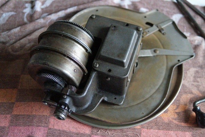

I am thinking about using my Garrard 7a motor to build a gramophone. (and yes, it will have an external horn created from paper).

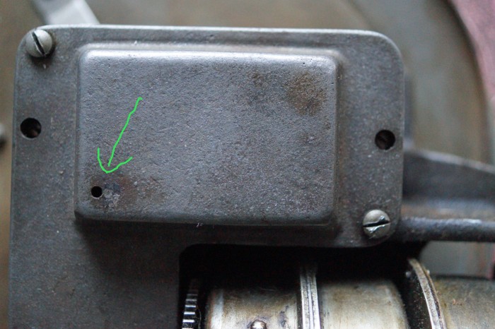

I noticed that there is a small hole in 'the pan' and wondered if it should have a bung / stopper in it ? (Photograph below).
On the one hand, perhaps the internal oil absorbent pan floor pad, (or 'IOAPFP' for short) when sufficiently 'doused'/ 'wetted', is enough to 'wick' the oil around ?
But surely any excess does not just drip out from the bottom hole onto the internal floor of the gramophone ?

I hope someone will know, but i'll be surprised if anyone does! Probably an excess oil drain as you say, or possibly pressure relief for heat buildup if that little space is sealed. I remember reading tests of electric motors in The Gramophone where one of their measurements was heat rise over time.

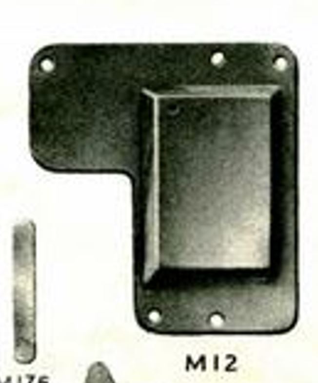

Yes, I too think it could be an overflow facility although the position at the bottom is a little strange ? The hole seems to be part of an original design judging by the enlarged photo of the exploded diagram. Your own experiments may well give you the answer to your question ?! An absorbative sheet under the motor would probably be a good idea. A fine motor.

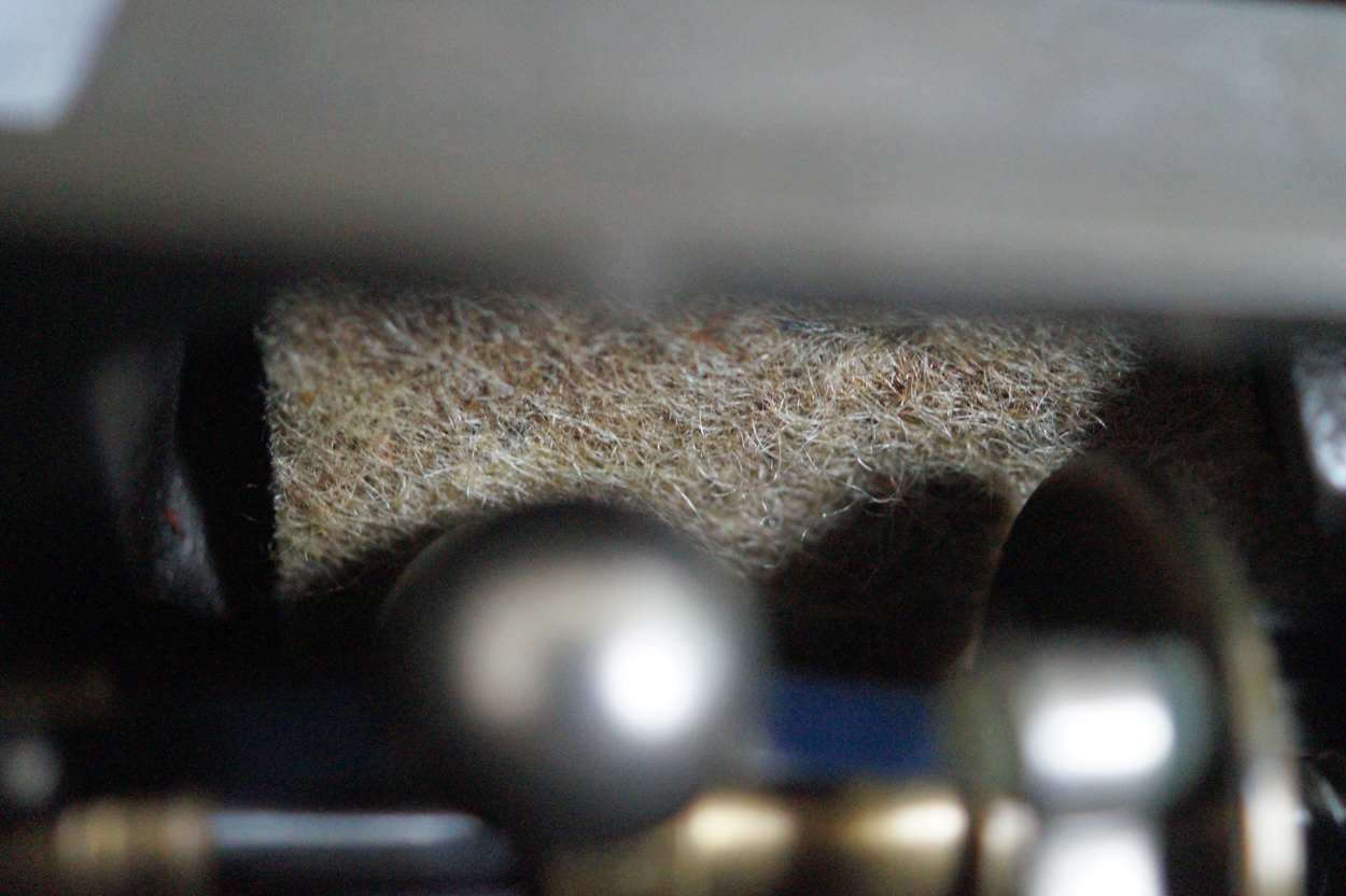

I will soak the original absorbative sheet (which is on the internal floor of the pan) with oil then. This is connected to (and seems to be the same material as) the 'wick'. That must be how it was designed then, I guess. (Photograph of internal pad / wick material below).
