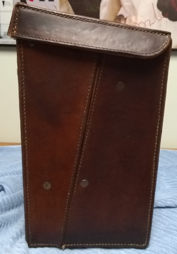

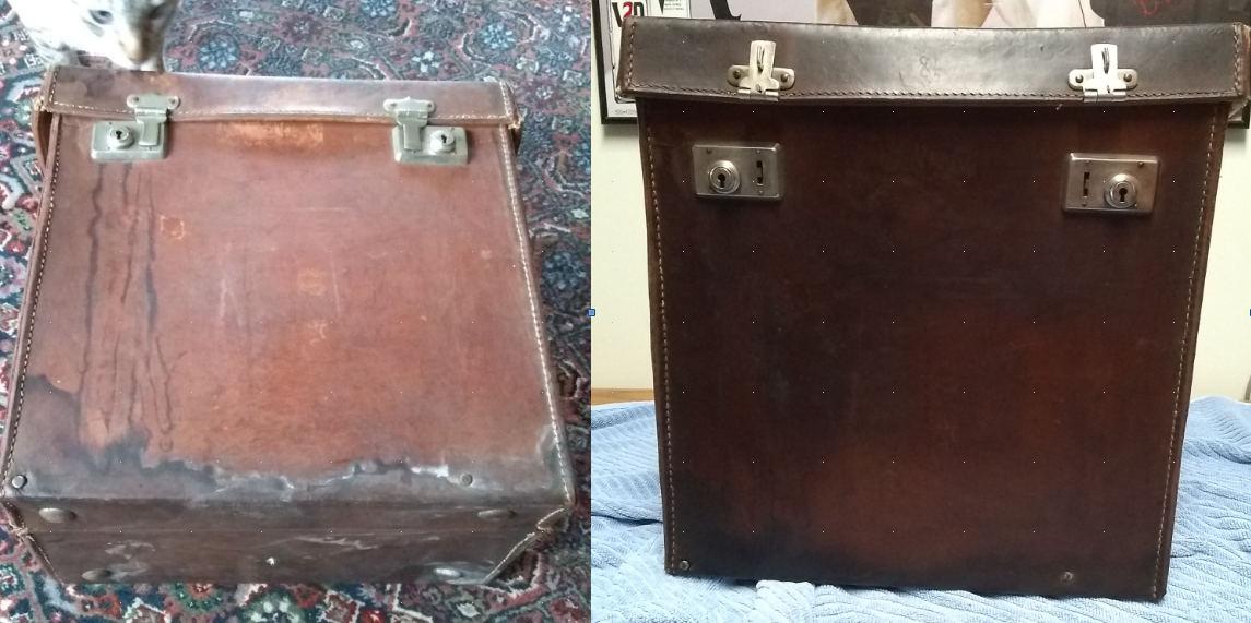

The Case Before and After
I am not finished with the case yet. I need to get another secondary restoration product, I think, a leather balm.
the rest of the case shows similar improvement.
I would like to get the aluminium frame out of the case so that I can re-block it and try to get the warping out of it now that it is more pliable.
It appears to be held in with two split rivets on the sides at the front and with one screw at the back. I am struggling with the rivets at the moment.

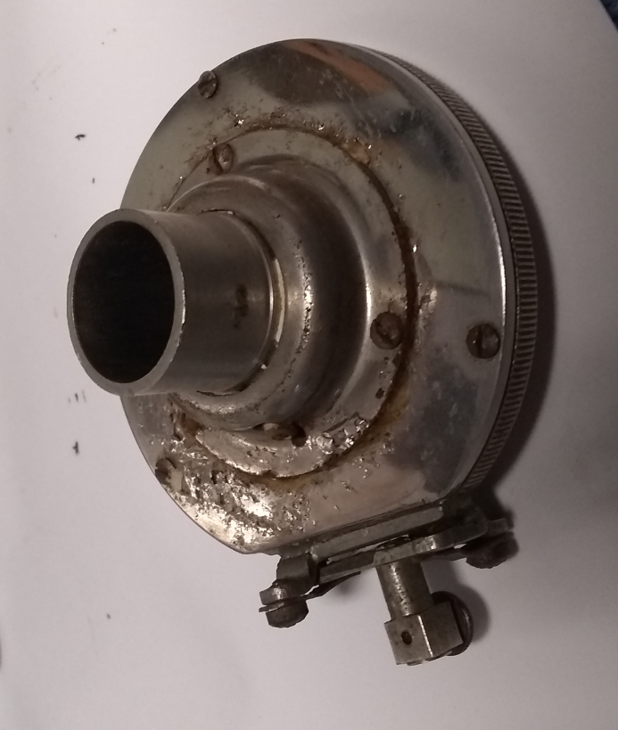

The Reproducer
The mica is loose in the reproducer because the gaskets have disintegrated. It looks like I might be able to save it.
The front of the reproducer doesn't look too bad, but the back is a bit of a dog's breakfast.

Posts: 4693
Re: Started on the Roberts Bestone
Wow, what a change in the appearance of the case!!! It looks fantastic
Lah Ca
Posts: 1414
Post by Lah Ca »
Inigo wrote: Thu Jan 18, 2024 6:13 pm Wow, what a change in the appearance of the case!!! It looks fantastic
Thanks. And I hope it will look better, yet.

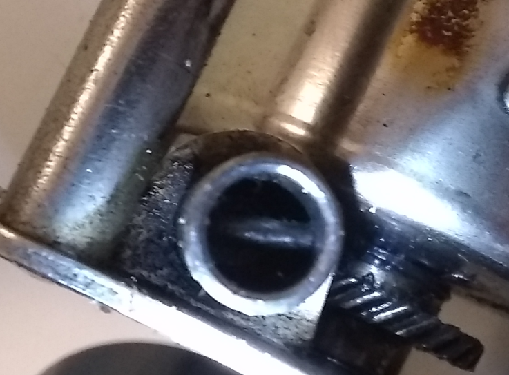

Well .. I know what this is now:
2024-01-18 16.32.02 forum.talkingmachine.info 79907c553042.jpg (7.03 KiB) Viewed 14534 times
It is the end of the non-return spring, I think. For purposes of testing, I managed to uncoil a small part of the broken non-return spring and lock it under the screw down tab that holds it in place. It probably won't stay there.
