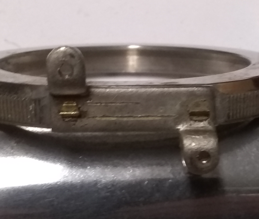

I am working on cleaning up the reproducer today (while various screws sit in rust remover and leather continues to soak up neetsfoot oil).
The housing of the reproducer seems to be plated brass. If I peer down into the screw holes it looks like brass, and it is heavier and has a different feel than pot metal. It has a plate welded or soldered to its base to mount the needle bar. Two small holes go through the body and the plate, and two brass pins cut to rough knife-edge pivot points are driven into the holes so that the knife-edges protrude from the plate.
As implied above, the needle bar is not a pin-pivot type but a knife-edge rocker type. There are two small leaf springs that hold the needle bar in place.
Some thick,, dark brownish substance has been applied to the leaf springs where they make contact with the needle bar so that there is no direct metal contact between the springs and needle bar. It does not seem to be wax; it is too hard. Perhaps it is thick shellac? Any ideas?

They were small pads of rubber, now degraded and hardened. Other brands used the same technique.
Lah Ca
- Posts: 1414
Re: Started on the Roberts Bestone
Thank you.JerryVan wrote: Tue Jan 30, 2024 6:37 am They were small pads of rubber, now degraded and hardened. Other brands used the same technique.
If these were meant as mechanical dampeners, they will no longer have much effect.
So I guess I should replace them with something. They are not (and probably were not ever) very thick. Thin silicone cut to size and affixed with contact cement? Or even just multiple thin coats of contact cement?

I would think that the spring pressure alone should hold them in place. Otherwise, maybe just a small dot of shellac. My guess on thickness would be about 1/32". Too thin and the spring pressure may "bottom out" the rubber, giving no real dampening effect.
