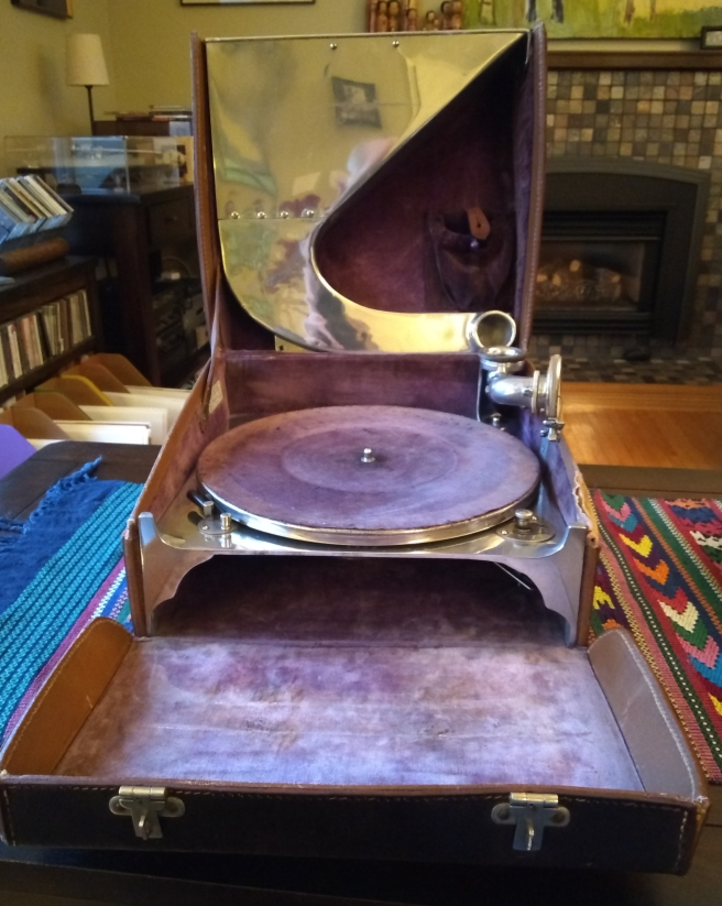

Getting Close to Done
The Case
The case will need continued work with neetsfoot oil and straightening--a little at a time.
Lonsdale leather sells a product for treating/finishing the rough edges of leather, so I will probably go buy some.
Tweaks and tweaks over time.
You can see the Chicago screws that I used to replace the bifrucated rivets in the pictures below. I used the black ones but took steel wool to the tops of them to make them look old and abused. I had to drill things out just a little to get them to fit. They work very well.

The Machine
The photo below is staged. I cannot wind the motor up when it is in the case--no crank, yet.

Things that remain to be done:
1. Need a better diaphragm. I ordered two. One is terrible. The other is marginal. I am using the marginal one. Sounds OK. Looks bad. Contacted vendor. No meaningful reply. Won’t order again from this vendor.
2. Need new gasket-washers for the tone arm and reproducer. I soaked the originals in alcohol for a few minutes which softened them up a tiny bit, made them a bit gummy, and made them easier to clean. The backflange one is doing what it should do--no air leaks from the reproducer. The one between the reproducer and the tone arm needs replacing for cosmetic reasons, but I got it soft enough that it is probably sealing OK. I would like to replace them both. I may have a line on some natural gum ones ... we shall see.
3. I need a new o-ring for between the tone arm and the horn. I soaked the orginal in alcohol also, but the effects were not as dramatic as with the gaskets. Still I managed to get it soft enough to get it back on the tone arm upsidedown without destroying it. It looks better, and peering into the closed lid using my snake light, I see that it is probably sealing OK-ish, but it is not elastic enough to function really well. I have an idea where I can find one. I just need to get over the embarrassment of going to look.
4. I need rubber replacements for the vibration insulating washers between the motor and the motor board. I could not find anything locally, so I made felt ones. They will do for now.
5. I probably need to have the motor completely serviced by someone with a machine shop. I have never done a motor, but I could probably take it apart, clean it, relubricate it all, do the spring (never done one before) and put it all back together. The Garrard 3 is a very simple motor with very few parts. But I don’t think my work would fix the problem with the tic. Later.
6. I need to repair the disintegrated cardboard and rexine on one side of the bottom of the case at the front. I have a cunning plan.
7. I need a crank. I have a line on what I think is a Birch crank—might be able to pick it up on Feb 28th. It is of appropiate dimensions. I will just need to convert the end to a fork. Everywhere I have looked within easy driving distance has no 5/16ths steel rod that is not threaded—so haven’t tried making one. Still looking for a real Garrard crank, too. I have a feeling if I do find one, there will be a financial standoff—It’$ $uper rare $$$$--Yes but the people who need one are very few.
8. I need to redo the pad on the brake. There is nothing left, and things are mostly down to bare metal. But there is not much clearance, so whatever I attach to the brake will need to be thin. When I was looking at garbage rubber washers today, there were quite a number that did not have the centres fully punched out. I will measure the brake and see if the ID of any of the washers matches up. I also bought some hollow punches the other day, but there is definitely some skill to using them—I may or may not be able to cut something nicely. If at first you don’t succeed, get a bigger dead blow hammer.

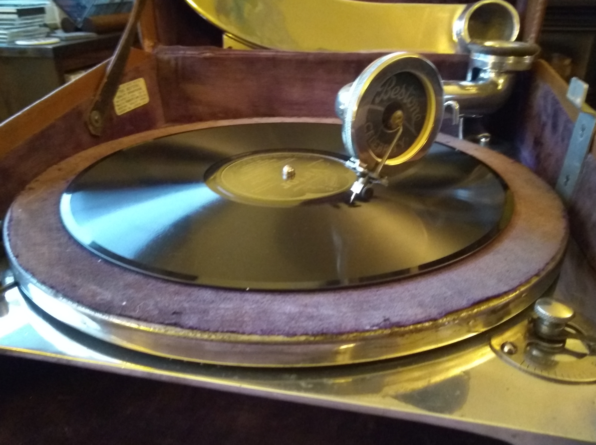

The motor runs fairly quietly under a load, and the tic, tic, tic noise is either gone or inaudible. It runs stably at 78 RPM without much wow and flutter. The spring is quiet both winding and playing, but it is a very small spring, and in the machine's current condition it struggles to play 12" records, particularly electrically recorded ones. The motor really does need a complete overhaul and tune up.
While winding the machine one time, my non-return spring repair gave way dramatically. I had to take everything apart to fix it (again) and then reassemble it all. I can do it in my sleep now.
What does the Bestone sound like?
Very good actually, And very loud.
In comparison to my other portables, it lacks bottom end, but the mids and highs are very clear, maybe almost as good as my HMV 102c.
It does not fare well, however, with anything beyond a medium tone steel needle, and even medium tone needles can seriously overdrive the horn with some records. Fibre needles are better, and they also seem to give better bass response.
The machine also sounds quite good with the lid open with only the tone arm as a horn. It is surprisingly loud but not as loud as with the horn.
One curious thing with the machine is that you need to be certain that you have needles inserted as deeply as they will go into the chuck. If you don't, the machine can skip while playing because there is so very little clearance between the reproducer and the closed lid of the case.
