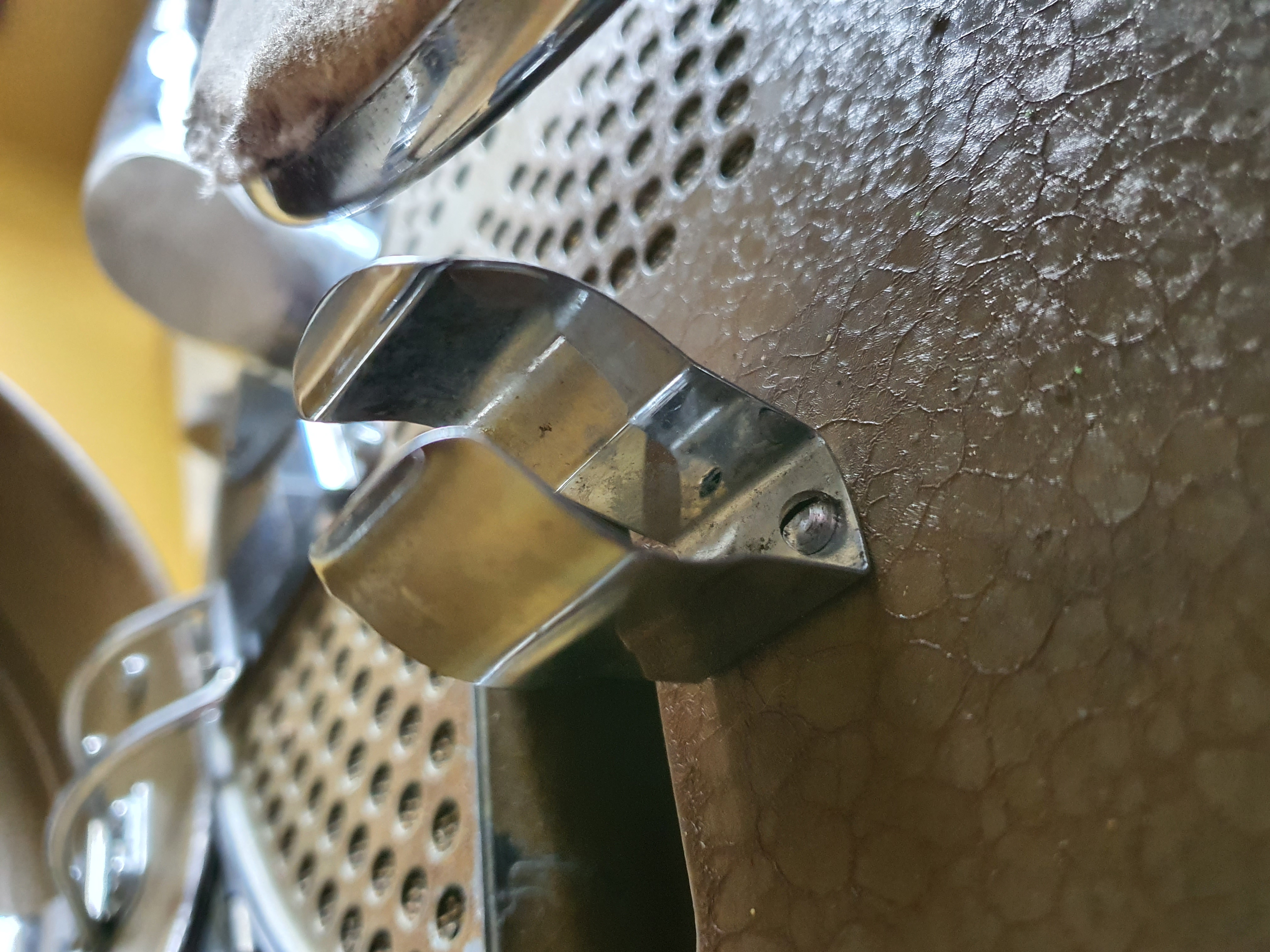

flying500 wrote: Sat Mar 02, 2024 12:03 pm Would you be able to photograph the clip for me please?
Do you remember how the tonearm is attached as i removed the thre screws securing the cover plate at the base of the arm but it did not appear removeable from there?
Many Thanks again.
Here it is.
Unfortunately I don't recall how to remove the arm, but to open the machine I had to unscrew some bolts on the sides.
I found the reason for the spring on the spindle: when you close the machine, the flap on the lid presses against the spindle, lowering it to the level of the turntable and therefore preventing it from dislodging during transport. Smart system!

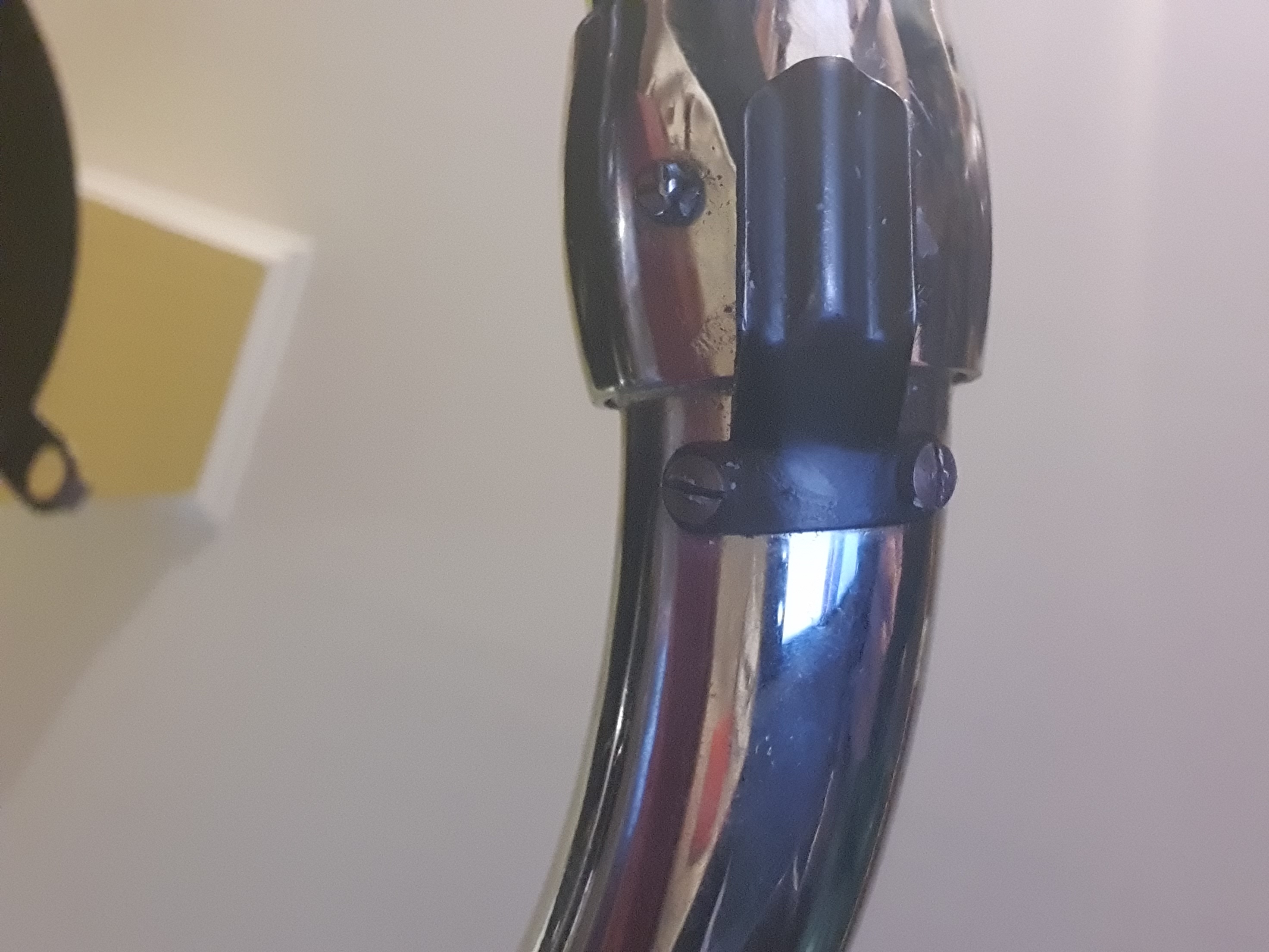

Thank you once again but it is the clip on the joint on the tonearm which keeps the arm raised when changing ta record.
CarlosV
Posts: 2158
Location: Luxembourg
Re: Odeon System Vadesz Bauhaus Gramophone
Post by CarlosV »
flying500 wrote: Sun Mar 03, 2024 9:12 am Thank you once again but it is the clip on the joint on the tonearm which keeps the arm raised when changing ta record.
OK, got it. Here it is, taken from the bottom.
