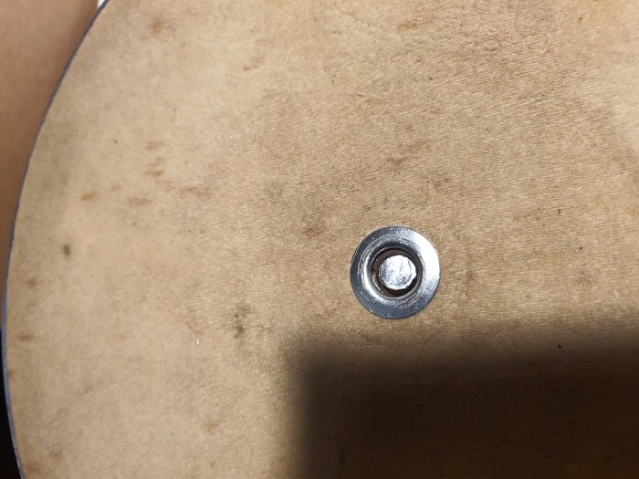

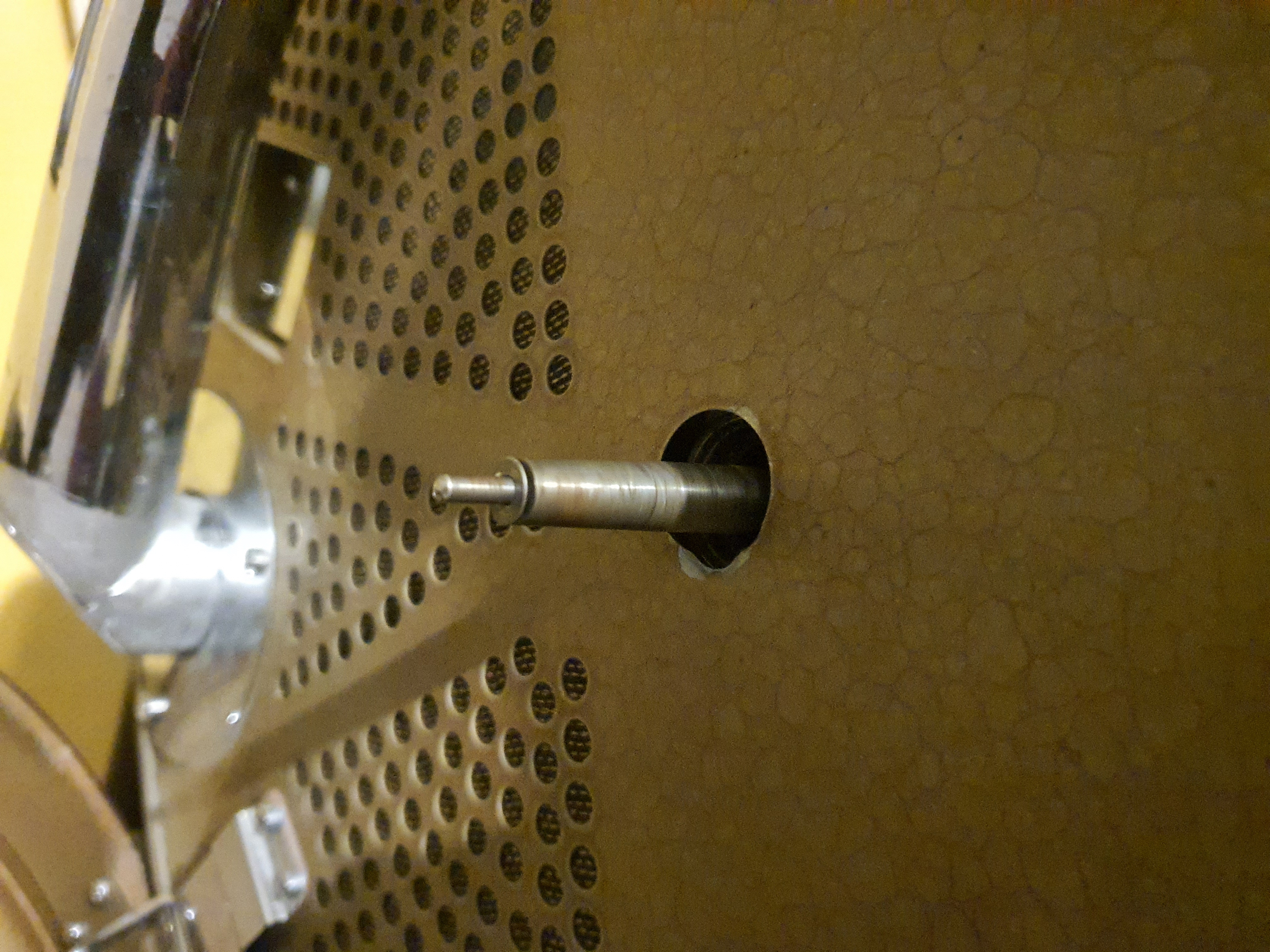

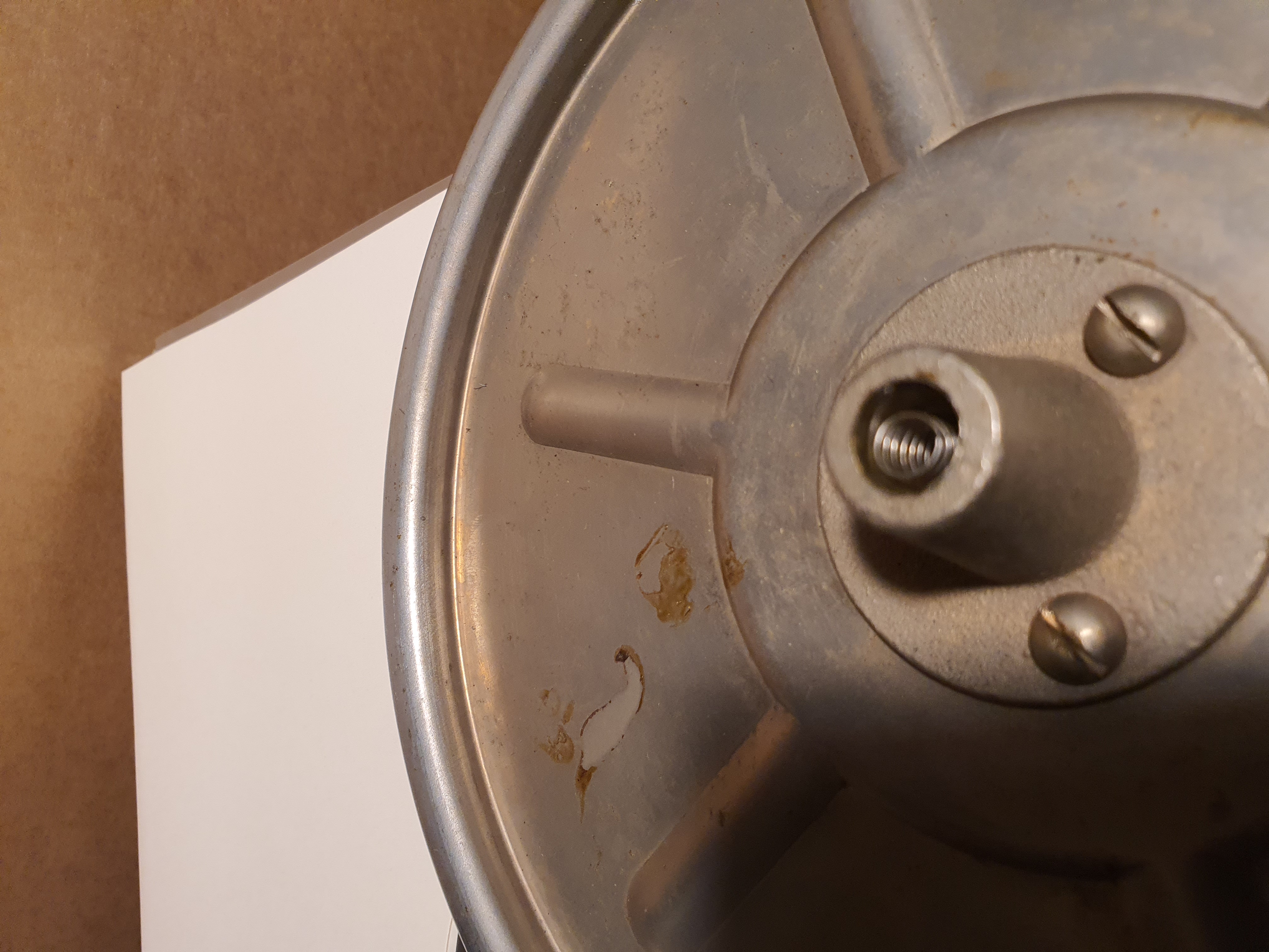

The turntable will lift by applying vertical pressure upwards with both hands - it is not screwed. It may be stuck due to age, rust etc, so tapping on the center will help, but be careful: the particularity of this machine is that the spindle is not integral to the motor, the visible part that fits in the record hole is actually a cap that sits in the actual spindle, and has a spring between them, so when you lift it be careful to not lose both parts (spindle cap and spring). The photos below should clarify, you can see the spring inside the turntable cap in one of them, and that the cap recesses - but, at least in the case of my machine, does not fall off - when you remove the turntable.

Re: Odeon System Vadesz Bauhaus Gramophone
Thank you for the photos. They are very imformative.
Do you know why there is a spung top section?
It escapes me why there is a spring in the spindle, actually I had never noticed it until last night when I removed it to take the photos. I opened the arm years ago to clean it, and my recollection is that it is a simple metal-to-metal connection with no bearings. I just tried it now and there is no play in the arm, it rotates well around its axis with no lateral play.flying500 wrote: Sat Mar 02, 2024 4:18 am Thank you for the photos. They are very imformative.

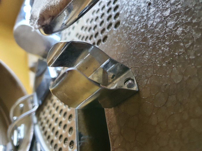

Would you be able to photograph the clip for me please?

Here it is.flying500 wrote: Sat Mar 02, 2024 12:03 pm Would you be able to photograph the clip for me please?

I found the reason for the spring on the spindle: when you close the machine, the flap on the lid presses against the spindle, lowering it to the level of the turntable and therefore preventing it from dislodging during transport. Smart system!

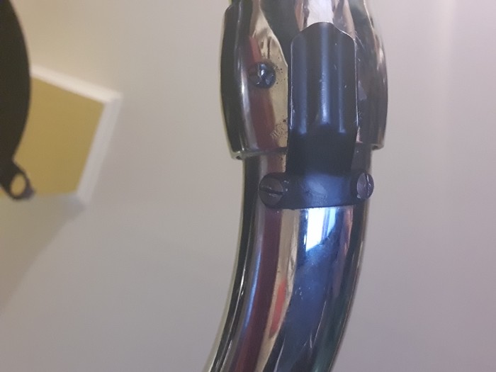

Thank you once again but it is the clip on the joint on the tonearm which keeps the arm raised when changing ta record.

OK, got it. Here it is, taken from the bottom.flying500 wrote: Sun Mar 03, 2024 9:12 am Thank you once again but it is the clip on the joint on the tonearm which keeps the arm raised when changing ta record.
