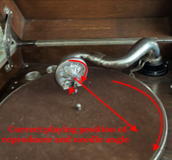

Diagram showing reproducer position and record rotation...
Screenshot 2024-06-19 at 9.27.30 PM.png (190.93 KiB) Viewed 610 times

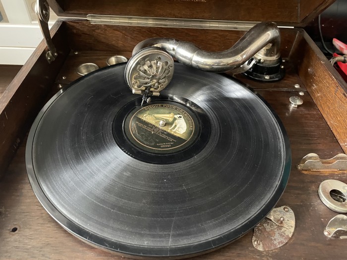

In one of your photos, you show the needle positioned perfectly vertical. You also depict the reproducer/needle sitting to the left of the turntable spindle. Both are incorrect, (and for some odd reason a very common error seen these days).
The reproducer/tonearm/needle must be positioned to the right of the spindle. The reproducer/needle also must adjusted such that the needle sits at roughly a 30 degree angle from vertical and pointing "forward", in the direction of rotation.
Have you removed the reproducer from the tonearm? If you have, you will see a "J" shaped slot in the tonearm end. You will also see a locator pin inside the reproducer throat. When placing the reproducer on the arm, the pin is aligned with and slides into the J slot. Once the reproducer pin slides into the J slot as far as it will go, the repoducer is then rotated so that the pin follows the bottom of the J. Once the pin hits the end of the J slot, the proper angle will be achieved.
Also, use the needle only once. Replace it with every play.
[/quote]
I indeed saw the "J" shaped slot in the tonearm end, checked it and normally it should be the right angle.
However, I dont understand the reproducer position as then, it makes the record unplayable (unless it's not the right kind of record)?
For the needle, I need to buy a new pack since I have about 90 in the phonogram pot but I have no idea wether they are worn out or not. :)
But for the moment, just testing with an old '78 no-one is interested in at home and which was already scratched so.... a few scratches more won't hurt I guess.

Curt A wrote: Wed Jun 19, 2024 9:30 pm Diagram showing reproducer position and record rotation...
Curt,
Is this correct? If so, I guess there is a problem with the record? :lol:

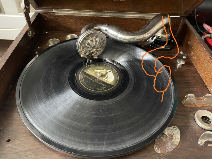

Posts: 6828
Re: The HMV130 and the Noob :)
MarieP wrote: Thu Jun 20, 2024 5:21 am
Curt,
No! You still have the reproducer to the left of the spindle, with the needle digging into the record. Swing the tonearm to the right side. The needle angle is now correct however.
The only problem with the record is that it's been ruined by playing it the wrong way.
Check out this video.. Notice where the reproducer is placed when playing. https://www.youtube.com/watch?v=bHc7mYlpGI8&t=3s

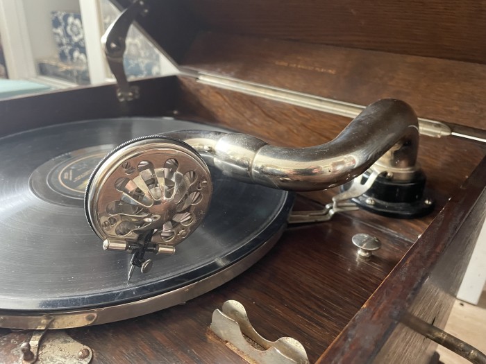

Orchorsol wrote: Thu Jun 20, 2024 6:35 am
Should be right this way.... but still the same result :?
Curt A
Posts: 6892
Post by Curt A »
The last pic is correct...
