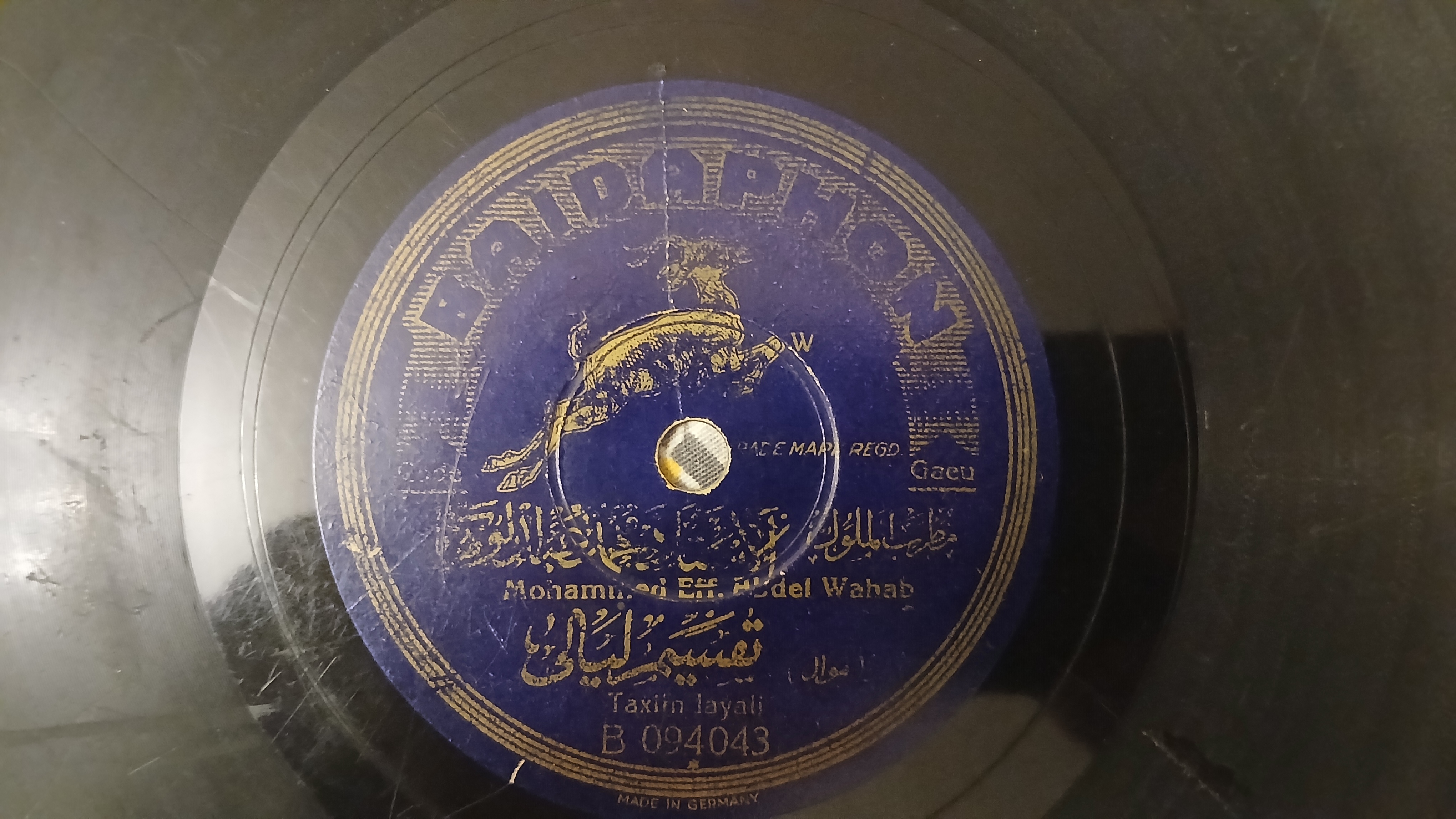

Hello everyone again. I was digging in that same antiques store where I found that busted Columbia style portable for 78s and miraculously I managed to find an Arabic 78 record stuffed under a jumble of 33 LPs from the United Arab Republic. I also found another 78 in a slightly better condition but imma make a separate post for that later.
The owner asked for 3 OMR (around 6 GBP) for the record since it was really in bad condition and cracked as well on one side, with a chip on another.
How good of a find is this? I'm not familiar with Arabic 78 recordings even though I myself am Arab.
Thanks for taking the time to read.

Abdel Wahab is one of the 'greatest' of the Arabic singing, as was Oum Kulthum, etc, si it must be good.

Inigo wrote: Wed Jun 26, 2024 9:03 am Abdel Wahab is one of the 'greatest' of the Arabic singing, as was Oum Kulthum, etc, si it must be good.
My parents said the same thing. Thanks for the reply! Much appreciated.
