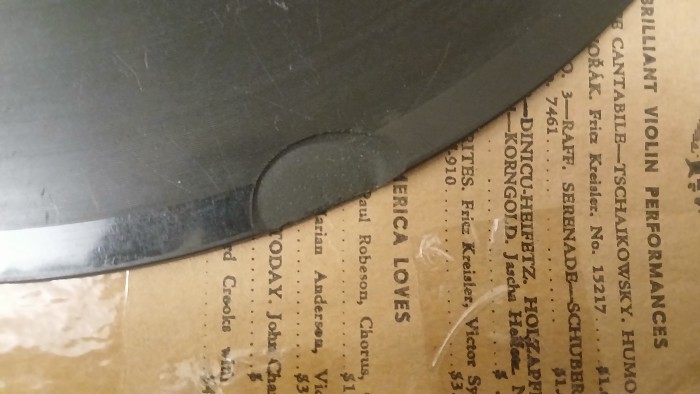

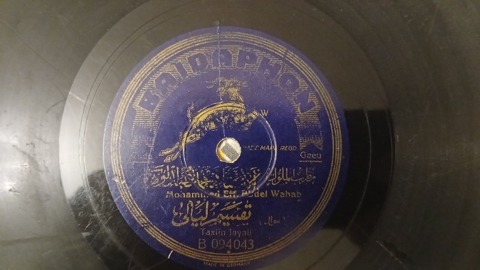

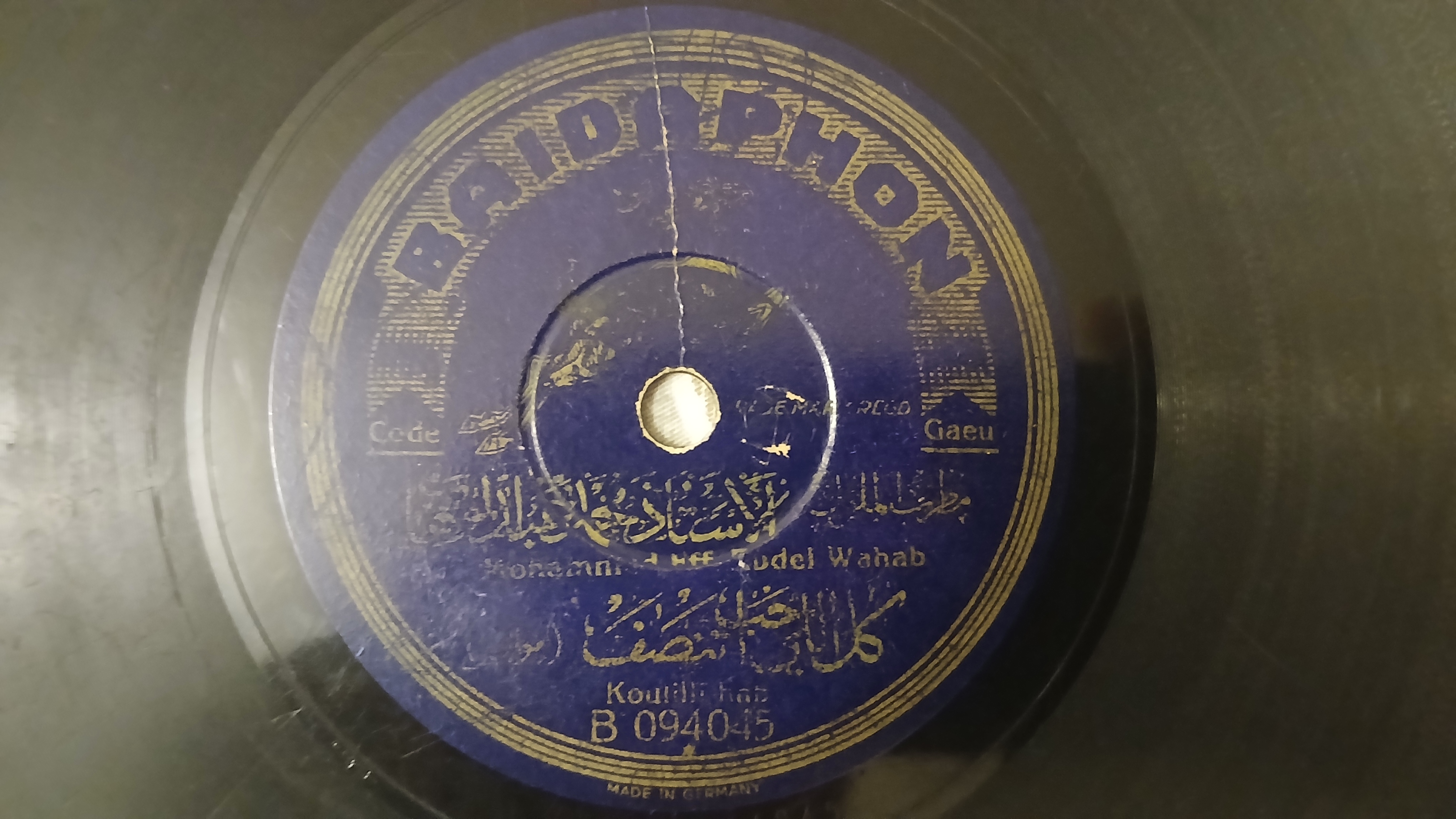

Hello everyone again. I was digging in that same antiques store where I found that busted Columbia style portable for 78s and miraculously I managed to find an Arabic 78 record stuffed under a jumble of 33 LPs from the United Arab Republic. I also found another 78 in a slightly better condition but imma make a separate post for that later.
The owner asked for 3 OMR (around 6 GBP) for the record since it was really in bad condition and cracked as well on one side, with a chip on another.
How good of a find is this? I'm not familiar with Arabic 78 recordings even though I myself am Arab.
Thanks for taking the time to read.
Baidaphon B 094043 FIND

Abdel Wahab is one of the 'greatest' of the Arabic singing, as was Oum Kulthum, etc, si it must be good.

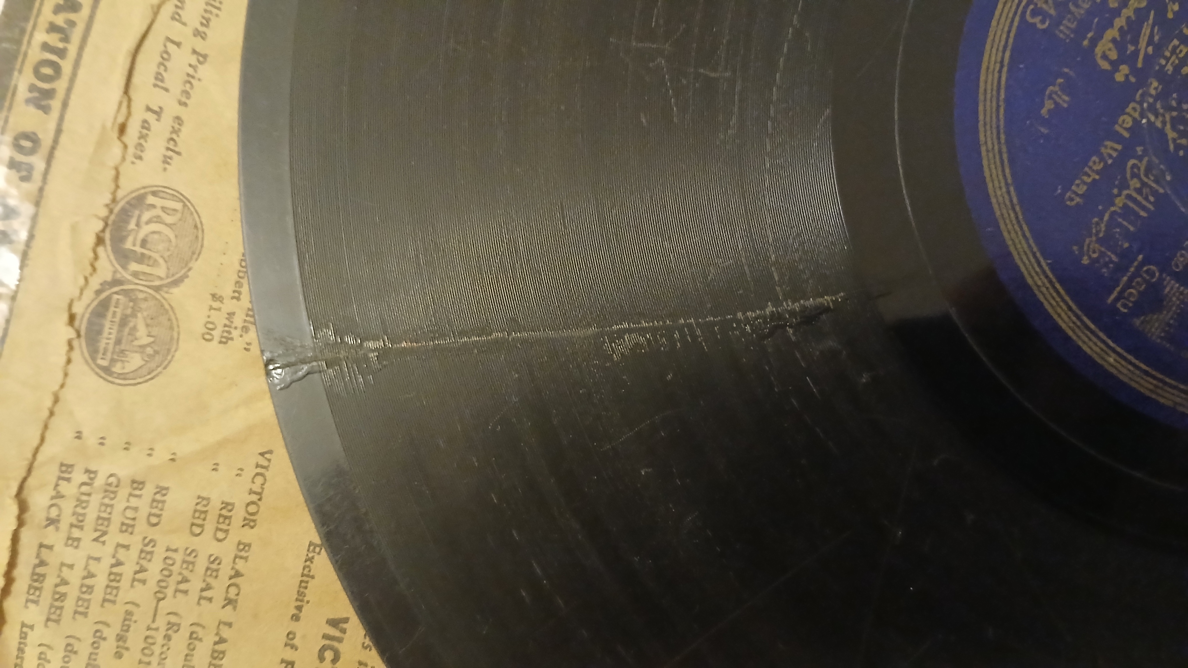

It is possible to repair cracked and broken records (if you have all the pieces).
A fellow CAPS member once testily advised me that you shouldn't repair a record; you should look for another copy. The second half of his advice is entirely sound, the first not. Repair is good, especially if you are unlikely ever to find another copy.
Depending upon why the record is cracked, there are varying degrees of success as far as playback noise goes. If the record is cracked because of internal tension (it wants to warp but can't because of the rigidity of its materials, so it snaps), you probably won't get the crack to line up completely flat.
Repaired records that click badly, I restrict to play on acoustic machines, not wanting to risk damage to a modern and expensive stylus on an electric cartridge.
I also treat and polish (some) repaired records with carnauba palm wax (a floor and furniture polish). The wax hardens and often reduces the noise of the crack. The wax can also make a badly worn record look in much better condition that it actually is.

Taking a close look at it, it seems that maybe the guy who had it before me tried to fix it himself, as the material doesn't want to move at all. I tried forcing it with pressure and it seemed to move just the tiniest of distances. I really appreciate the mountain of effort you put into writing this post. Unfortunately I don't have the missing chip and it seems that the record was already glued in a previous attempt by someone to right it. I did manage to reduce the cracks effect on the sound with pressure though I will try that new technique you just wonderfully showed me.Lah Ca wrote: Wed Jun 26, 2024 9:45 am It is possible to repair cracked and broken records (if you have all the pieces).
