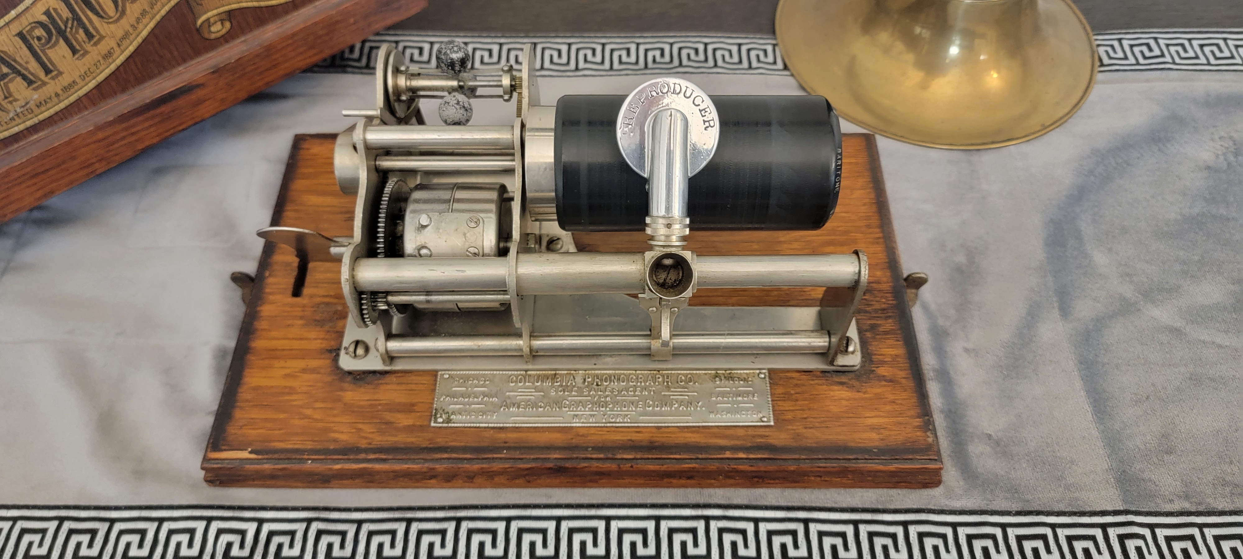

Heh. I was looking for a reproducer for my recently acquired eagle and I couldn't find any on ebay at the moment! (the one I got for my Q doesn't track very well) Glad to see you got it.postwick wrote: Fri Jul 12, 2024 8:28 am So this is where we are.
20240712_080236~2.mp4
Dumb question but is there supposed to be a needle in the reproducer?
Anything I can do to improve the shaky sound?

I ordered the belt material from The Phonograph Shop. I am going to redo the belt because it's definitely a pretty poor job for my first attempt, and does seem to be binding when the glued joint goes around the pulley.
I also order, off eBay, an entire complete motor. Turns out it had a disconnected spring too, but the opposite side as my original. So I just put the two halves together

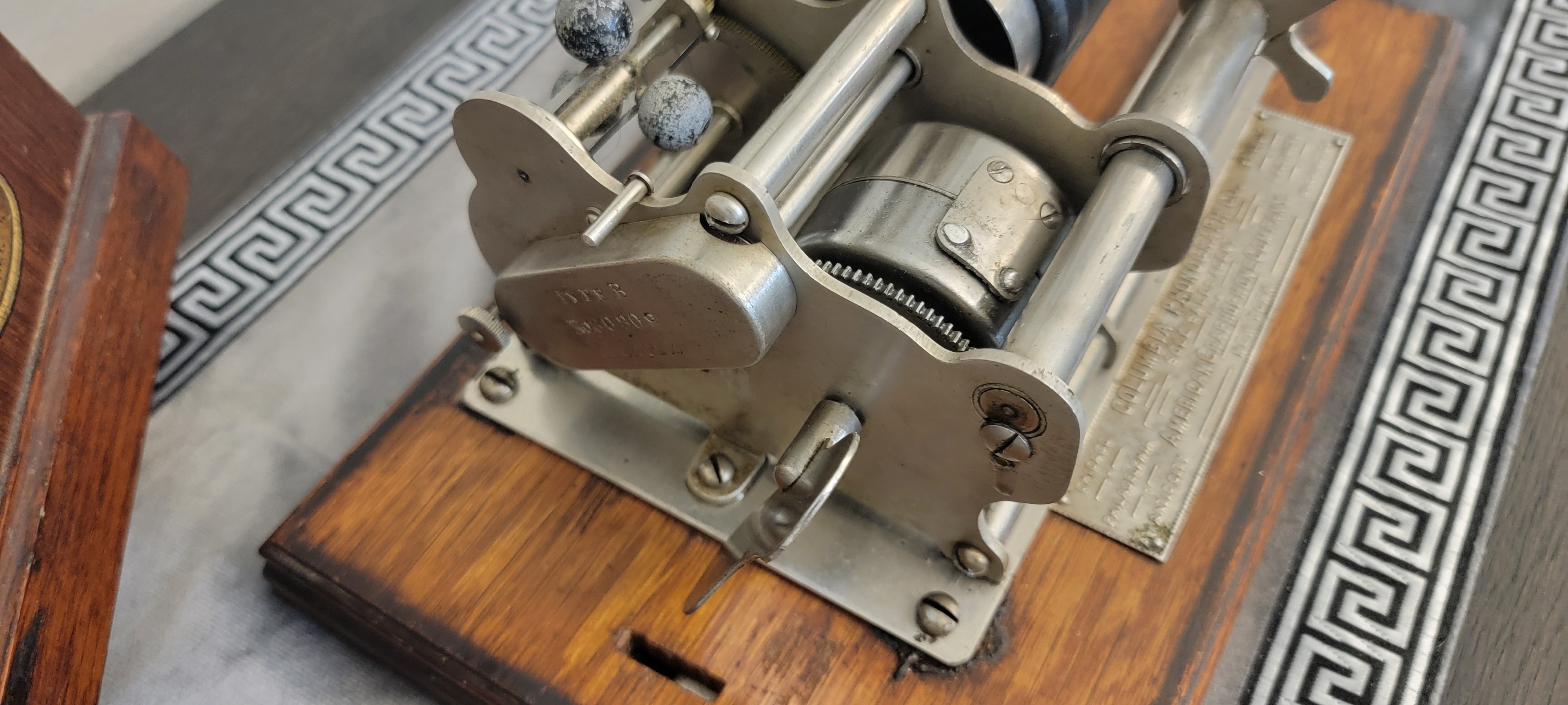

I better lubricated the reproducer slider and the cylinder shaft, adjusted the top pulley and it plays much better. One issue is the faster it spins, the weights bend the thin metal straps they're connected to, which pulls the left disc plate inward and it rubs on the speed control. That's what you hear in the video just before the music starts.
Here is the final result!
- Put two bad motors together to make one good one
- Made a new belt
- Disassembled, cleaned, lubricated and reassembled
Link to video of it playing: https://youtu.be/U48-NtgBjUQ?si=pMFmVD7LATDygO-b
- Made a new belt

I too have encountered the speed control arm rubbing against the governor disc. I assume as the leather pad wears down, this becomes more likely. I have found that CAREFUL bending of the speed control arm just a fraction of an inch can fix that problem. You'd need to remove the arm, clamp it in a vice, and slightly bend the pad end with padded channel-locks or other appropriate tool.
