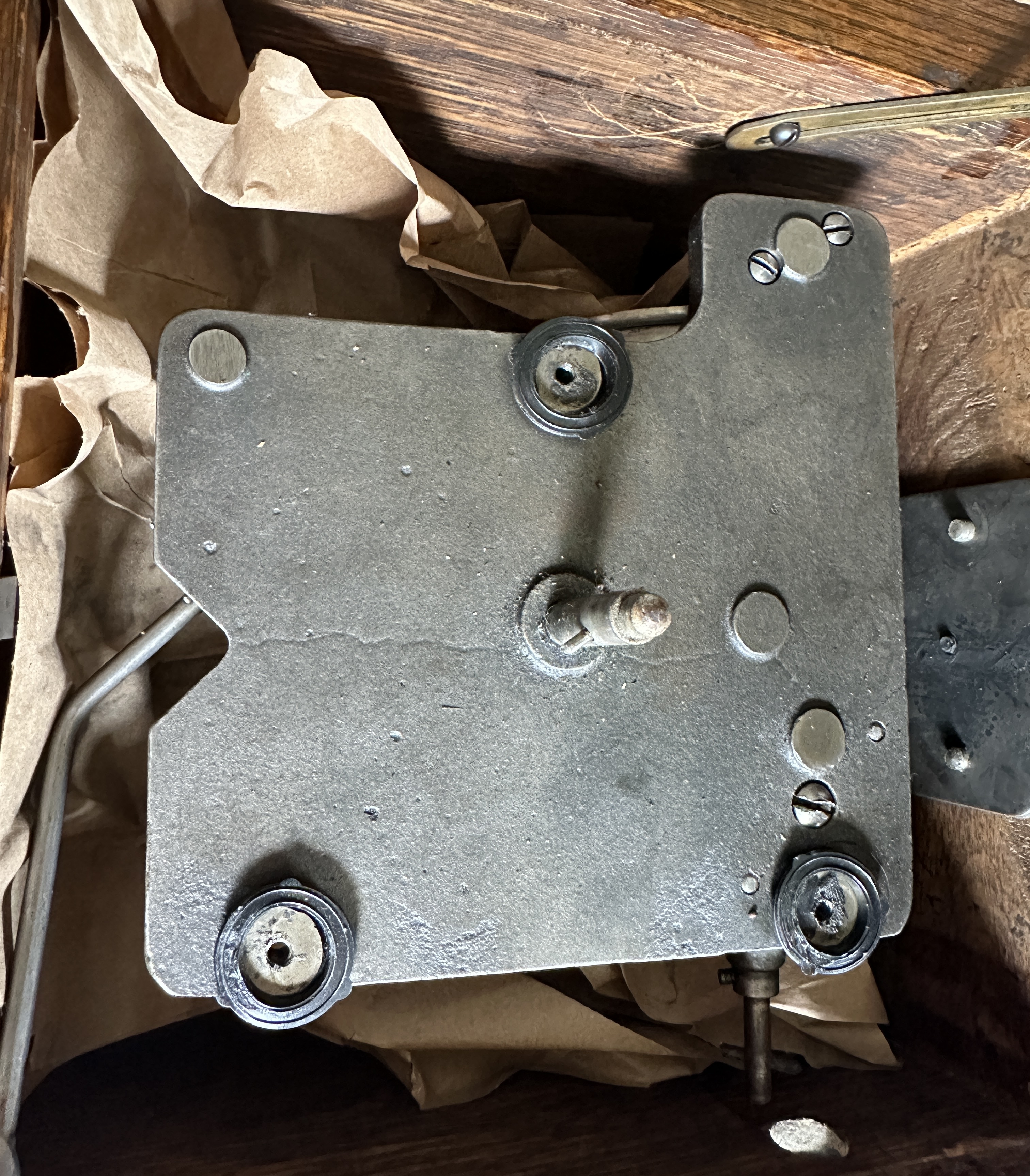

- Posts: 111
- Joined: Tue Feb 27, 2024 8:05 pm
- Personal Text: If your Victrola predates the Model T, it’s a good thing!
- Location: Kentucky
Re: A Vic III New To Me
See attached…
- Dischoard
- Posts: 634
Someone has definitely been here, and more recently than I would have liked. I wonder what those rubber washers are from…
Online
- Posts: 6382
Those are garden hose gasket washers. Not a horrible solution actually, but not quite right either.Dischoard wrote: Tue Jul 23, 2024 12:56 pm Someone has definitely been here, and more recently than I would have liked. I wonder what those rubber washers are from…
- Dischoard
- Posts: 634
Yes, I believe they are and the little nubs on the side are to keep them in place when they're in the receiver. They don't look all that old.
I just noticed in my picture of the spring barrels that there is an empty hole above the first barrel. I now wonder if the spring isn't broken
but that the inner spring attachment has become dislodged... maybe both are true...
