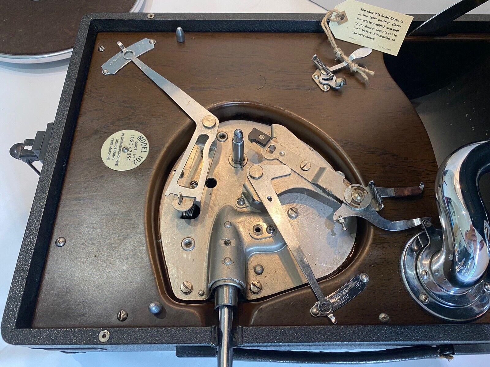

Posts: 5814
Re: Gramophone "his master voice"
The earliest 102's had a metal motor board from which the motor could easily be removed for maintenance.
For reasons best known to themselves, HMV replaced this sensible layout with a wooden motor board which needed to be completely removed to gain access to the motor.
Sherazhyder
Posts: 239
Personal Text: There was talk of big dreams and big fears and all the things that make people fall in love.
Location: Islamabad, Pakistan
Post by Sherazhyder »
epigramophone wrote: Sun Sep 08, 2024 9:52 am The earliest 102's had a metal motor board from which the motor could easily be removed for maintenance.
Hi ! Thanks for sharing the picture. The idea of a machine bay in the middle of a metal board was wonderful. I am thinking that using a die to cut a metal sheet for a creating a central bay would have been easier as compared to cutting a wood sheet through chiseller. Thus the machine bay design was abandoned.
