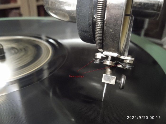

Having recently rebuilt another Exhibition Soundbox and despite resplacing the gasket and/or diaphragm, the Exhibition soundbox has always sounded to me too bright and especially strident on electrically recorded discs. So this evening I performed an experiment replacing the stylus armature springs with more flexible springs. The aim was to gain more stylus compliance and improve the bass.
I read some in this forum making the stylus bar springs less rigid by grinding the existing ones. Tonight I went one step further and tried manufacturing my own springs from razor blades.
The resulting springs were less stiff than the originals. I fitted the spring to my Exhibition on my VV-VI to test.
The sound quality changed noticably. The stridentness was suppressed and the bass response improved. An electrical disc sounded less strident. The highs were attenuated somewhat but not unduly. I shall try making the springs stiffer to see how it will affect the highs

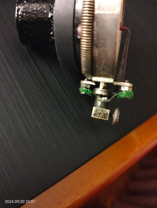

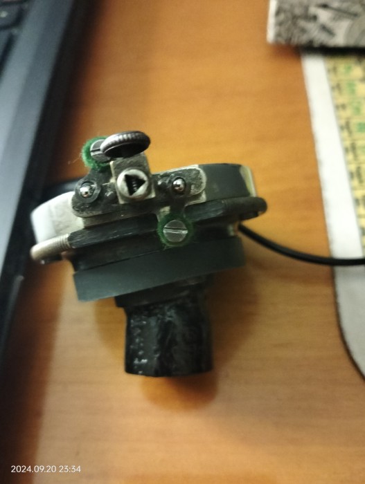

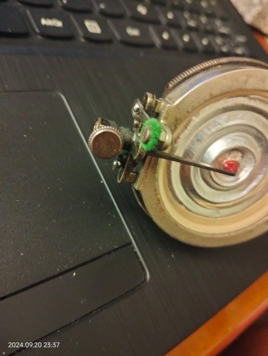

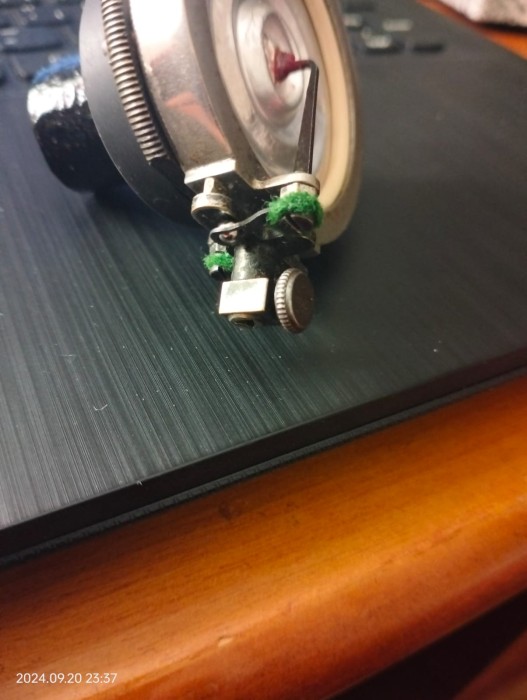

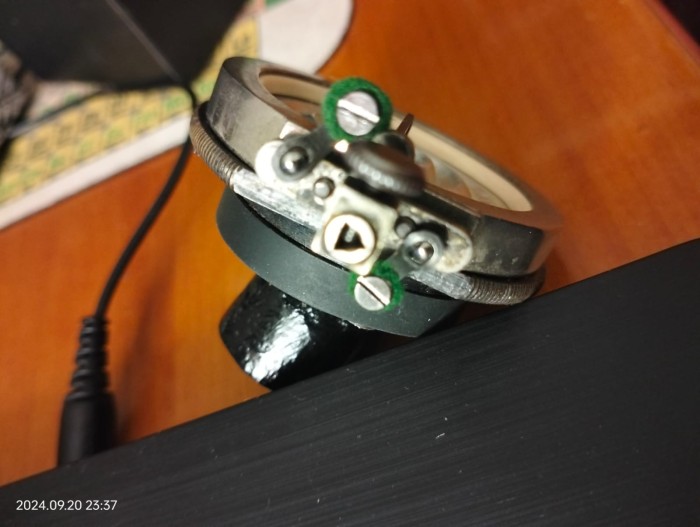

I'm one of them... I've reattached the original springs differently, so they only hold a bearing ball each, placed on top and pressing the needlebar fulcrum plate against the knife supports. This arrangement is similar to emg-expert, but instead of points, mine press through steel balls housed within the spring holes. It's only a relocation of same elements (introducing the steel balls). An image tells more than 1,000 words.... I'll post it later

Colleague jamiegramo and others herein have shown other experiments to update the design of the exhibition.
There's much to say here... A lovely soundbox the design of which, I believe, we feel was incomplete, because they changed to the no2 and no4 and then the orthophonic, so the exhibition evolution was halted. It's clear that it could have been further improved, as EMG people proved, using it as a base to develop their soundboxes.
It's a little marvel, small and heavy, powerful and simple, and I don't resign to leave it as it is... My dream is to understand it and evolve it to a superior thing by means of small reversible changes.
