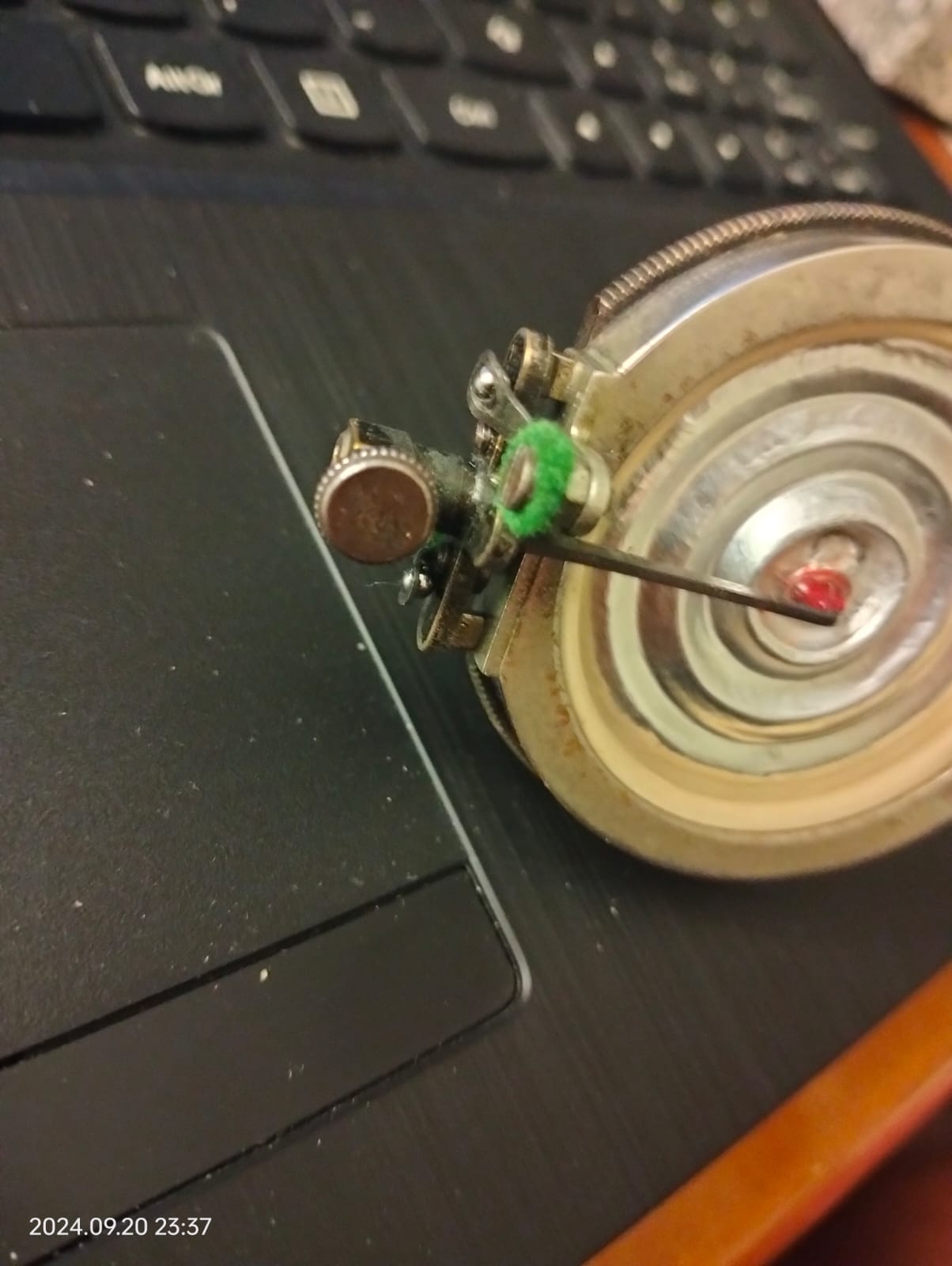

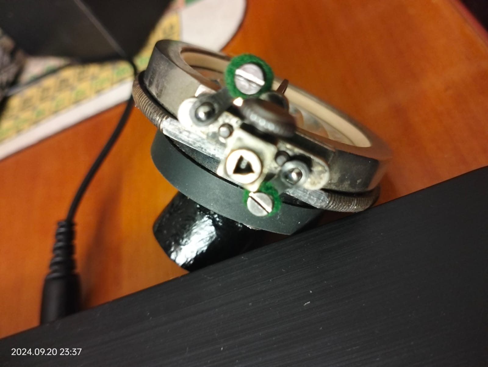

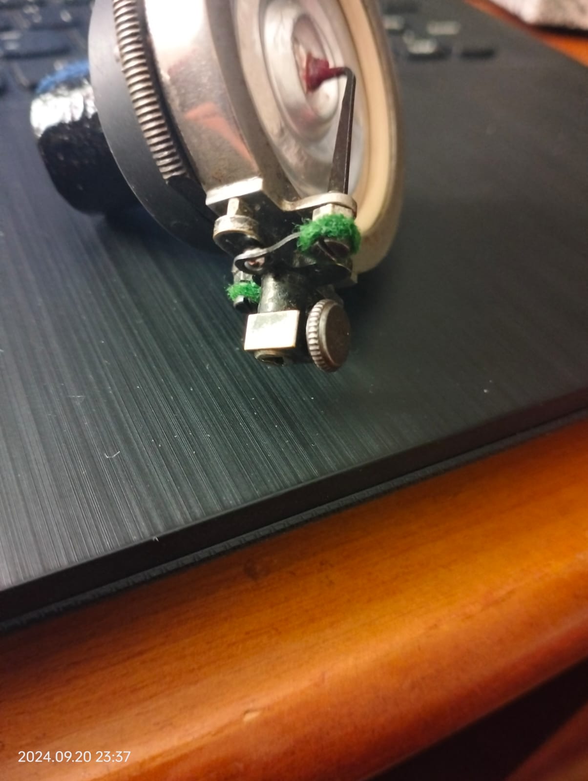

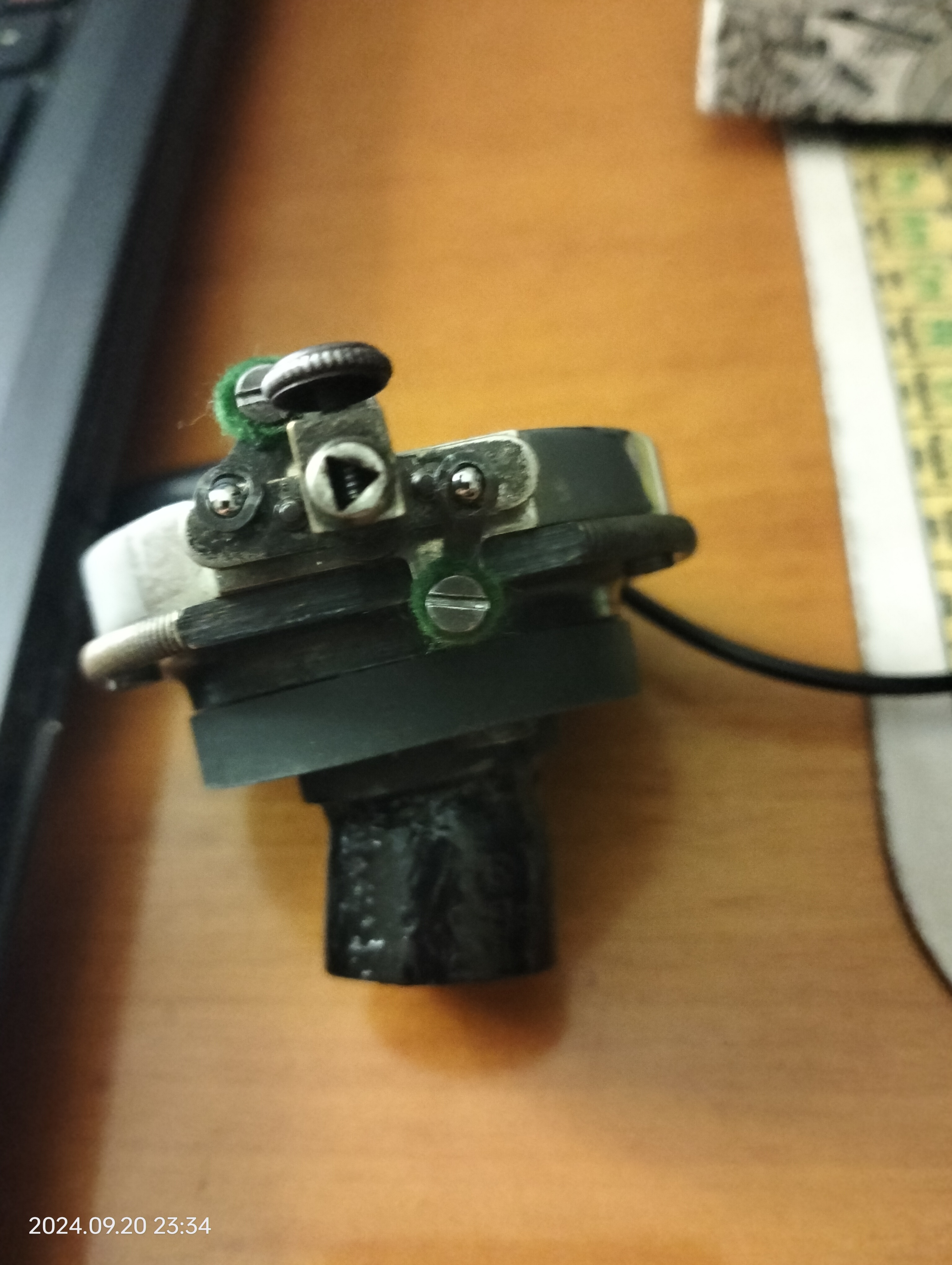

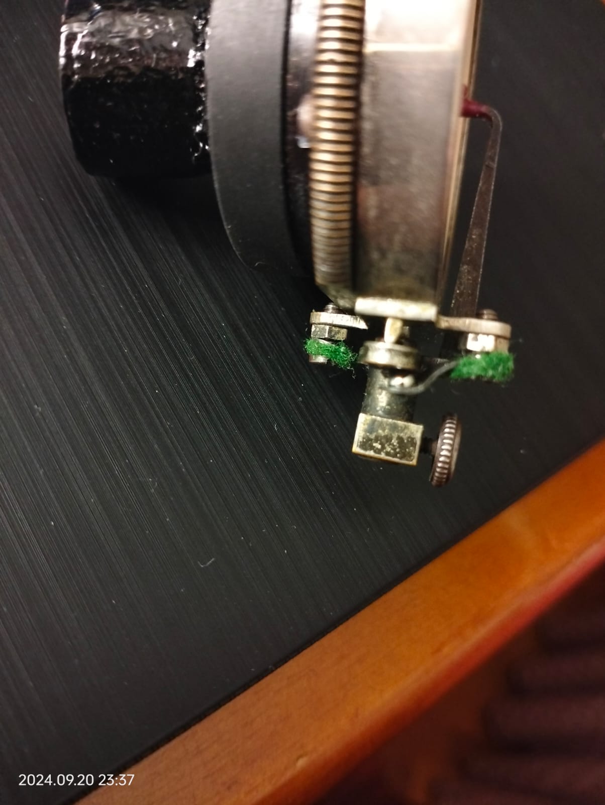

I'm one of them... I've reattached the original springs differently, so they only hold a bearing ball each, placed on top and pressing the needlebar fulcrum plate against the knife supports. This arrangement is similar to emg-expert, but instead of points, mine press through steel balls housed within the spring holes. It's only a relocation of same elements (introducing the steel balls). An image tells more than 1,000 words.... I'll post it later
I'm also experimenting in the same soundbox with different quality metal diaphragms. Later I will extend my explanations if you are interested.
Colleague jamiegramo and others herein have shown other experiments to update the design of the exhibition.
There's much to say here... A lovely soundbox the design of which, I believe, we feel was incomplete, because they changed to the no2 and no4 and then the orthophonic, so the exhibition evolution was halted. It's clear that it could have been further improved, as EMG people proved, using it as a base to develop their soundboxes.
It's a little marvel, small and heavy, powerful and simple, and I don't resign to leave it as it is... My dream is to understand it and evolve it to a superior thing by means of small reversible changes.

My experiments go in that direction, also trying several home made diaphragms made of metal, plastic and cardboard:
