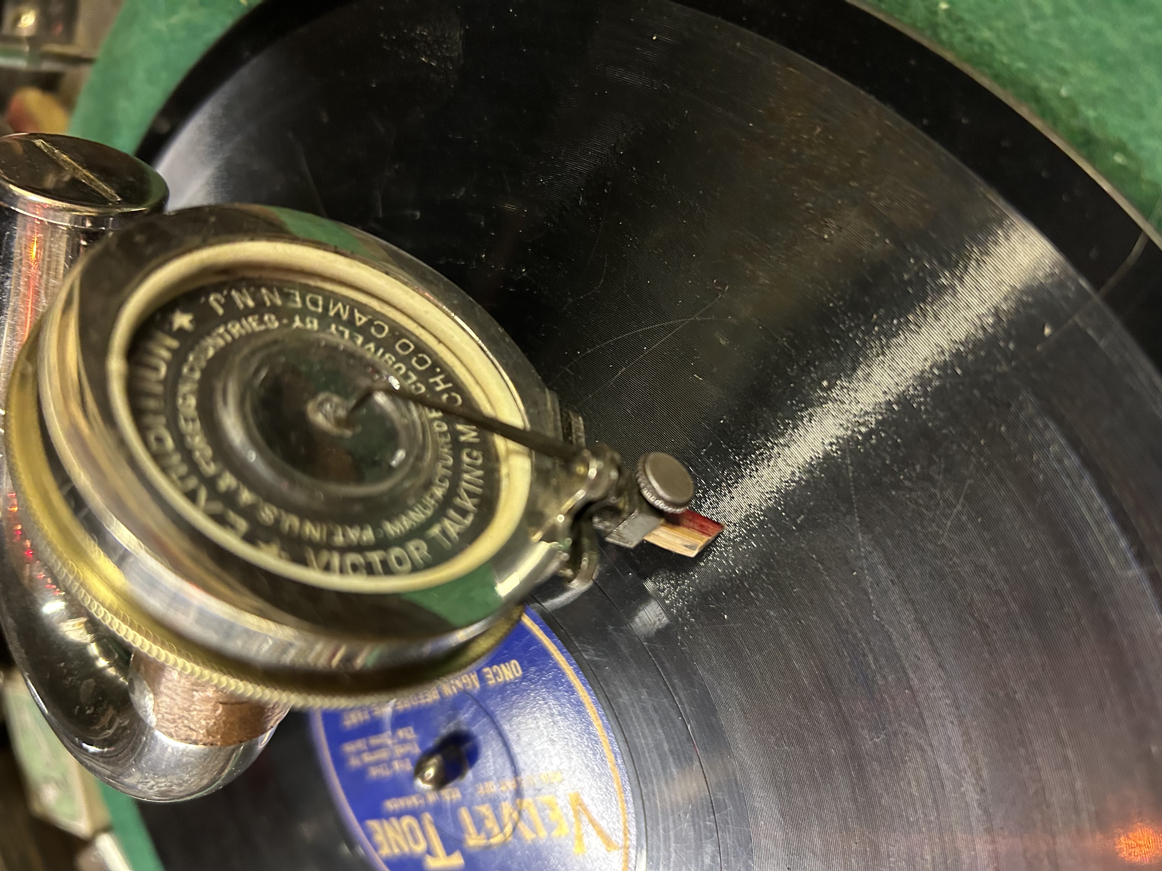

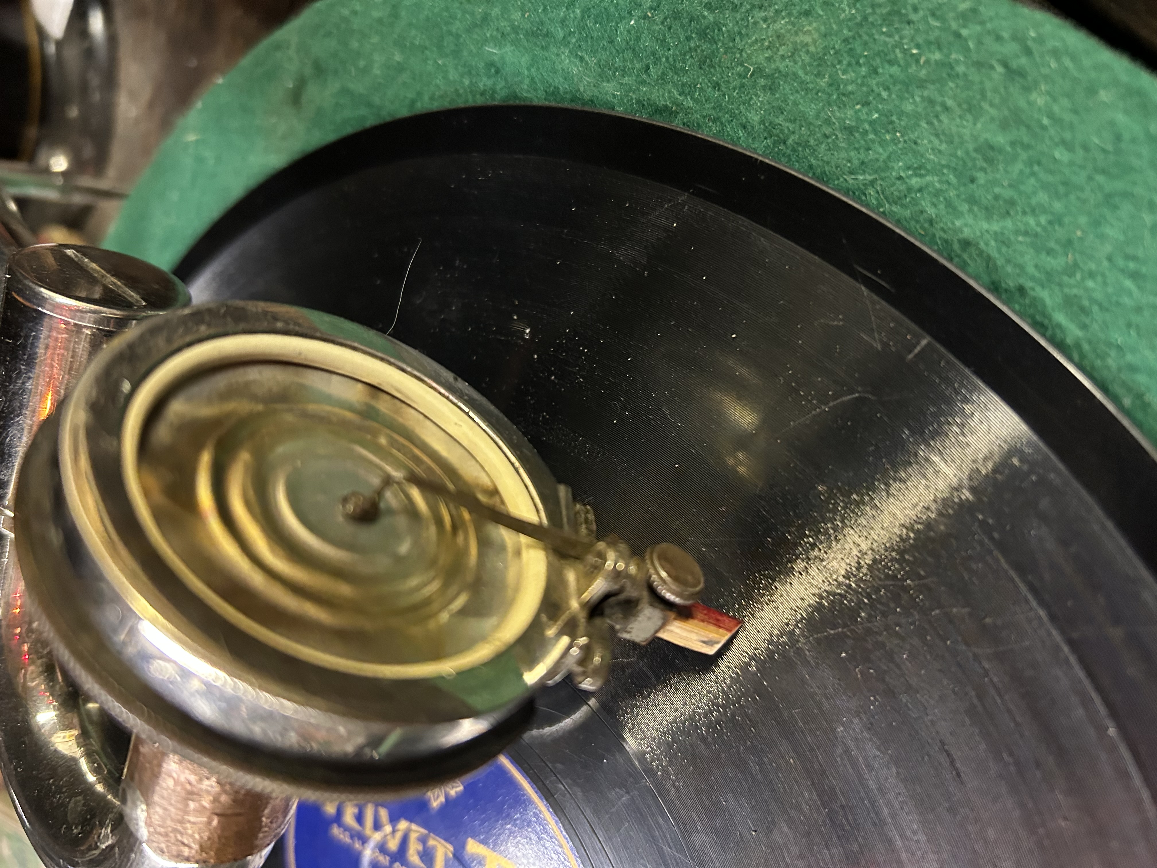

Greetings,
I mounted my “wood-look” diaphragm in one of my. Columbia reproducers and played a record , once with the non-mica and once with the standard mica diaphragm on a small, tabletop Columbia machine.

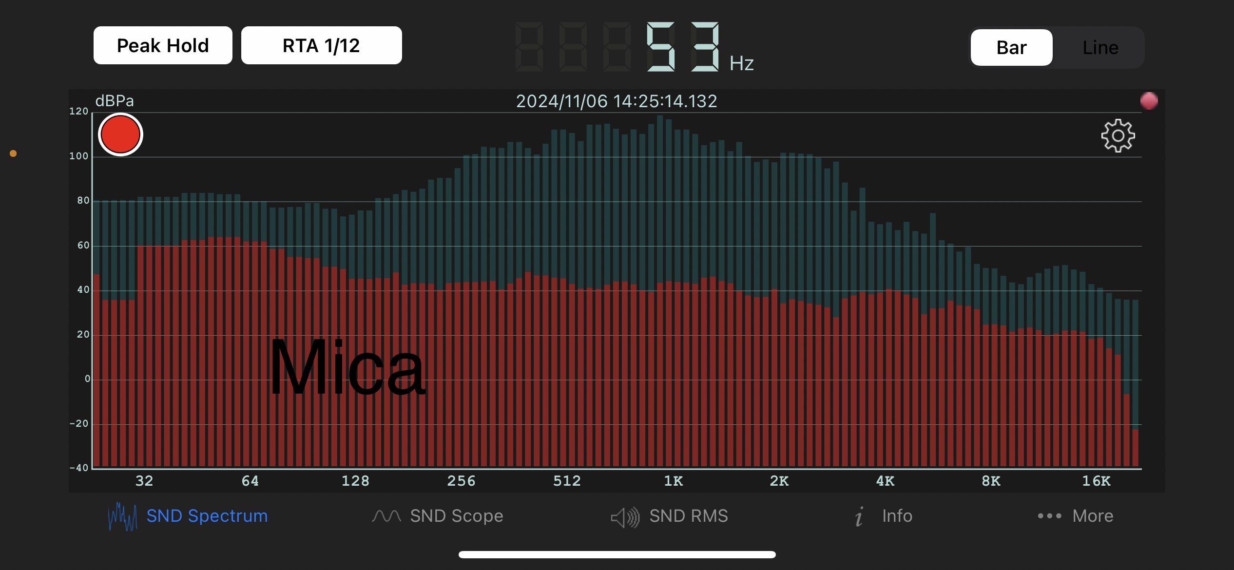

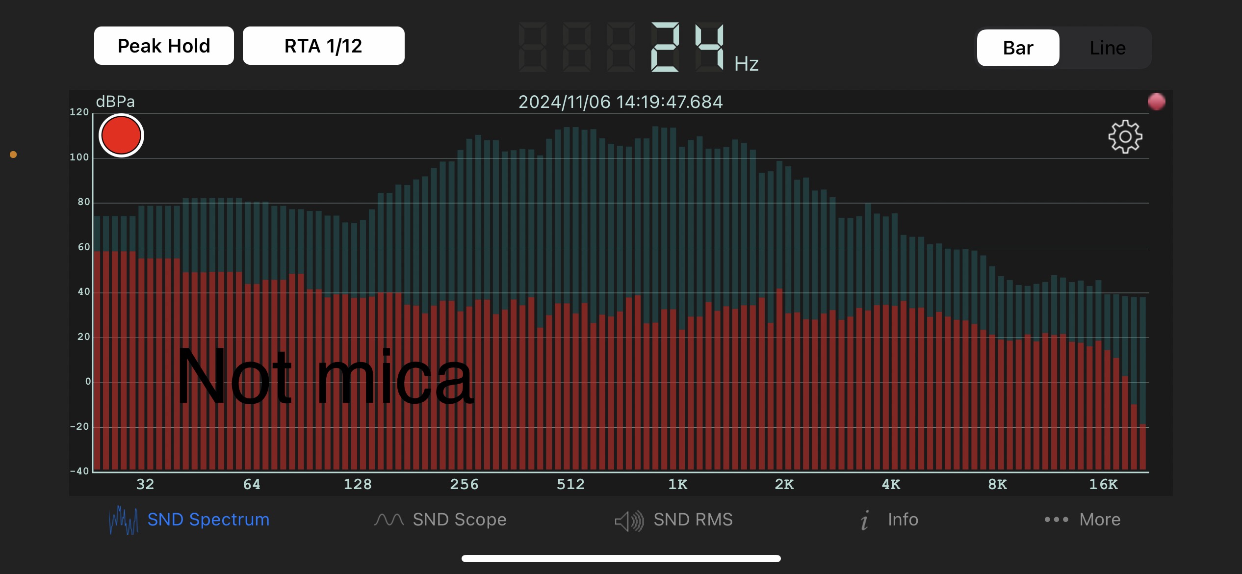

Using a free sonic tools app, I positioned my iphone in front of the gramophone to sample the sound produced.
I used the same bamboo needle for both samples, sharpened between plays. See graphs below.
Ignore the red bars, as they are just the sound of the room after the record had finished (higher decibels than expected, given that I was in a quiet room and the furnace was not running!).
The dark blue/green bars show the peak hold, the maximum that the various bars/frequencies went to during the playing of the record (12 per octave).
There is not much difference between the two diaphragms.

The mica was a bit brighter, perhaps, and the non-mica a bit mellower, but they were actually quite similar.
I should do a blind listening test, get a friend to swap out the reproducers so I can rate the sound without any preconceived bias. I have made a plastic diaphragm and an aluminum one for Exhibition reproducers (I have half a dozen, or so), so those, plus a stock mica one would make for a good shootout.
