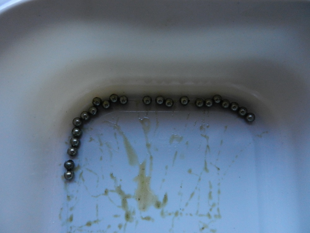

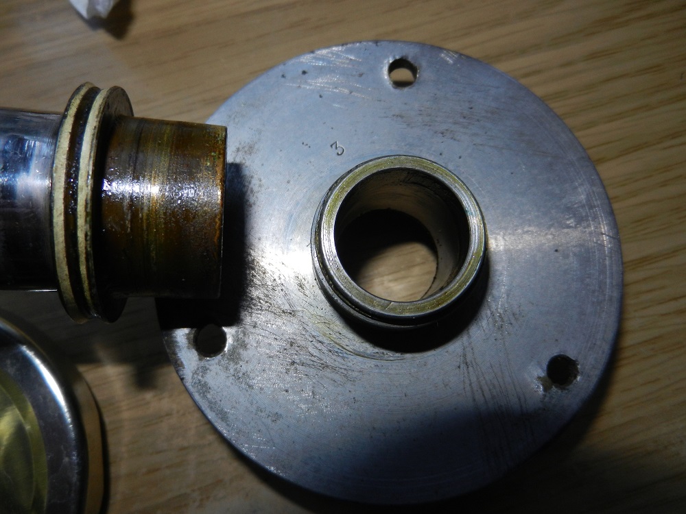

Well that was easier than I thought. Removed tone arm and taken apart as per attached photos. There are 23 of 3/16" loose balls which are probably worth replacing as some feel quite rough and there is a bit of muck in with the thick oil. Only marking seen is the number 3 on the underside of flange. Will clean up and reassemble with steering box lube.

Well done Iain and it is always very interesting to see the progress of the original development on the technical detail front such as the locking screw. The latter does seem to be a worthwhile idea to maintain the "set" of the critical adjustment but these days I suppose a dab of Loctite would probably be better. Your use of steering box lube is a good idea. The number 3 is also interesting and would seem to point to a pretty early machine although nobody has yet discovered any definitive dating records (please excuse the pun !).

Graham, I notice there is an annular groove half way down the bush where the tonearm spigot fits. Would there have been some sort of 'O' ring seal here or is it just to retain the lubricant?

Like you I suspect, I have always assumed that the groove is there to contain lubricant which is why I use a light grease at that point which also acts as an air seal---desirable to maximise bass frequencies. However, I cannot argue with your thoughts of a viscous oil at the higher level to promote free-running although a light grease does aid assembly ! I have never come across or heard of an "O" ring at that lower point---indeed I think they were a pretty new invention in the early nineteen-thirties ? Felt certainly (not suitable in this narrow groove ?) but I am not sure about rubber/neoprene etc. I think slightly increased friction might have interfered with the required free movement ? Interesting question. Thank you.
