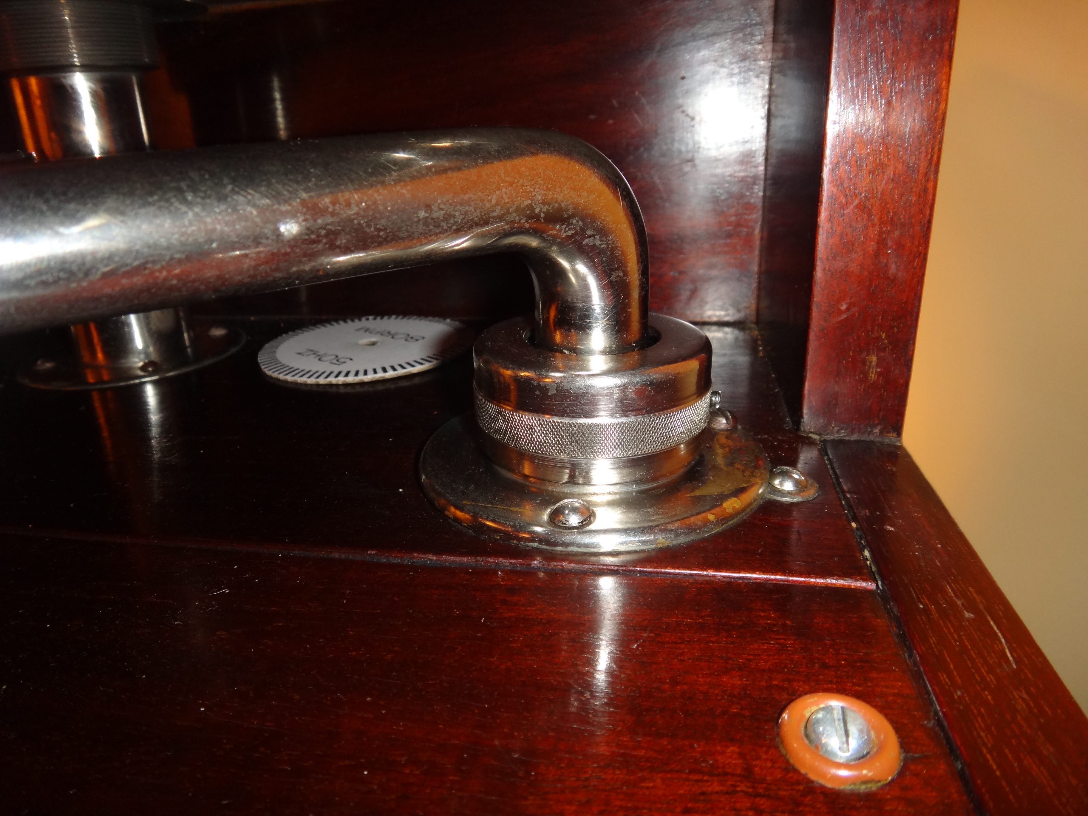

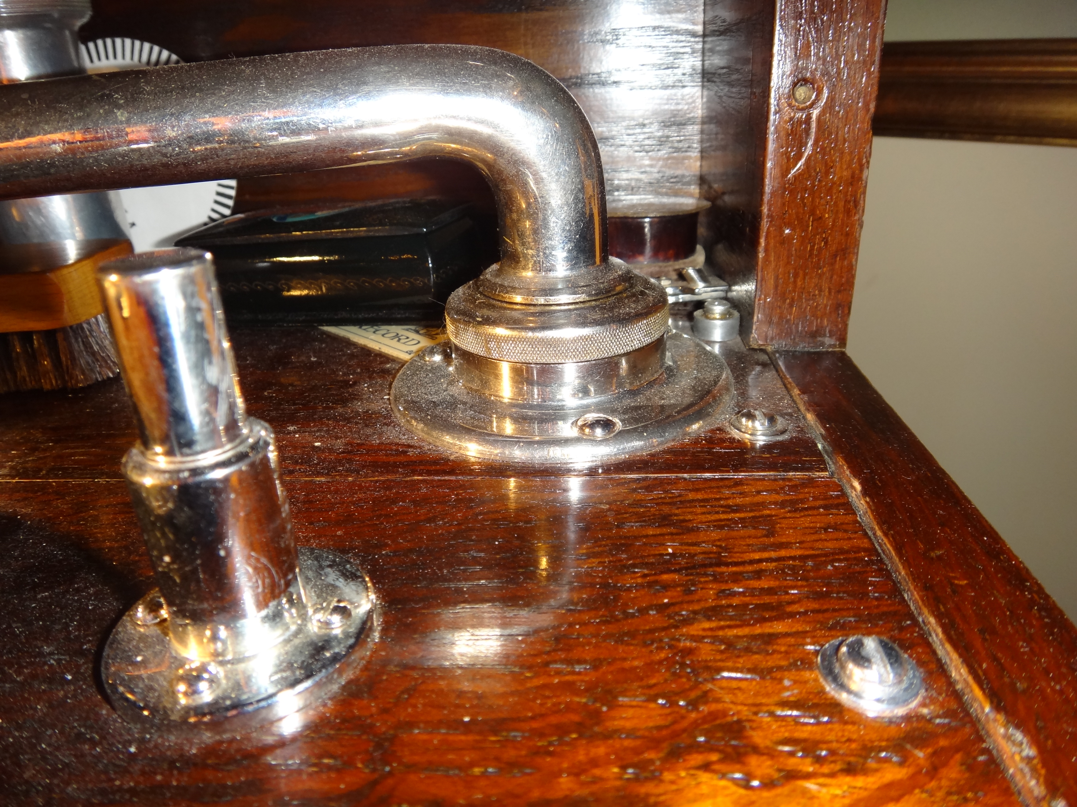

Iain, Happy Christmas and Hogmanay !
Alex is quite right and I hope these photos will give you certainty as to which type you have. The early type has loose ball bearings whilst the later type has a fully enclosed ball-race which will be removable in one piece without any danger of individual balls falling out. In the case of removal of the early type I would always unscrew the entire bearing housing first which can be done by taking out the three flange wood screws and unscrewing the whole assembly in an anti-clock direction thus separating the complete tonearm from the internal conduit (remove soundbox first !). If the assembly has been in place for many years it might be necessary to start the process by gently tapping one of the flange holes with a nylon or perhaps aluminium drift of suitable diameter. It is then easy to dismantle the housing over a large tin to contain wandering balls. Note there is a grub/locking screw in the side of the cap which also needs to be slackened/removed to allow uninterrupted movement.
Please be extremely careful upon reassembly not to overtighten the cap thus indenting the brass tracks. Having introduced light grease, just nip up the threads to eliminate any play whilst still allowing unimpeded movement. If previous owners have not done this and you find indentations, and thus notchy movement, I am afraid it will be necessary to remachine the track(s). Retighten the grub screw but, again, without too much pressure to avoid distortion of the fragile brass threads.
Whilst on the subject it might be worth noting that the early type EMG bearing was current for all goose-neck and some swan-neck tonearms until the improved design arrived. Expert gramophones (unfortunately) used the early type with loose ball bearings throughout their production run and with goose-neck tonearms exclusively.
I hope this is helpful.

Re: EMG Mk X tonearm advice sought
Alex, Graham, Thanks very much, that's really useful. From the photos mine is the early version however no locking grub screw so maybe this was a later refinement. Anyway I will proceed with caution and remove unit from cabinet complete before disassembly.
