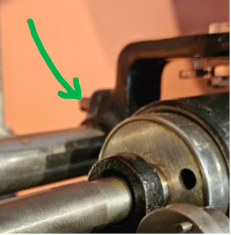

The only "correct" amount of repeater lift is that which allows the stylus to clear the record.
If memory serves, (and it may not), there is not a lot of adjustment available in the lift arm. I believe you could/should make your lift adjustment where the carriage clamps at the back.
Here...
Screenshot 2025-01-13 190134.png (154.74 KiB) Viewed 772 times
Posts: 8283
Re: D Repeater Question-Added pics while stylus is catching cylinder
I agree with Jerry. Adjust from that screw on the back of the carriage.
