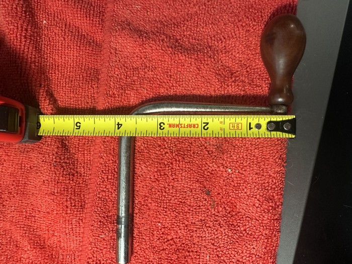

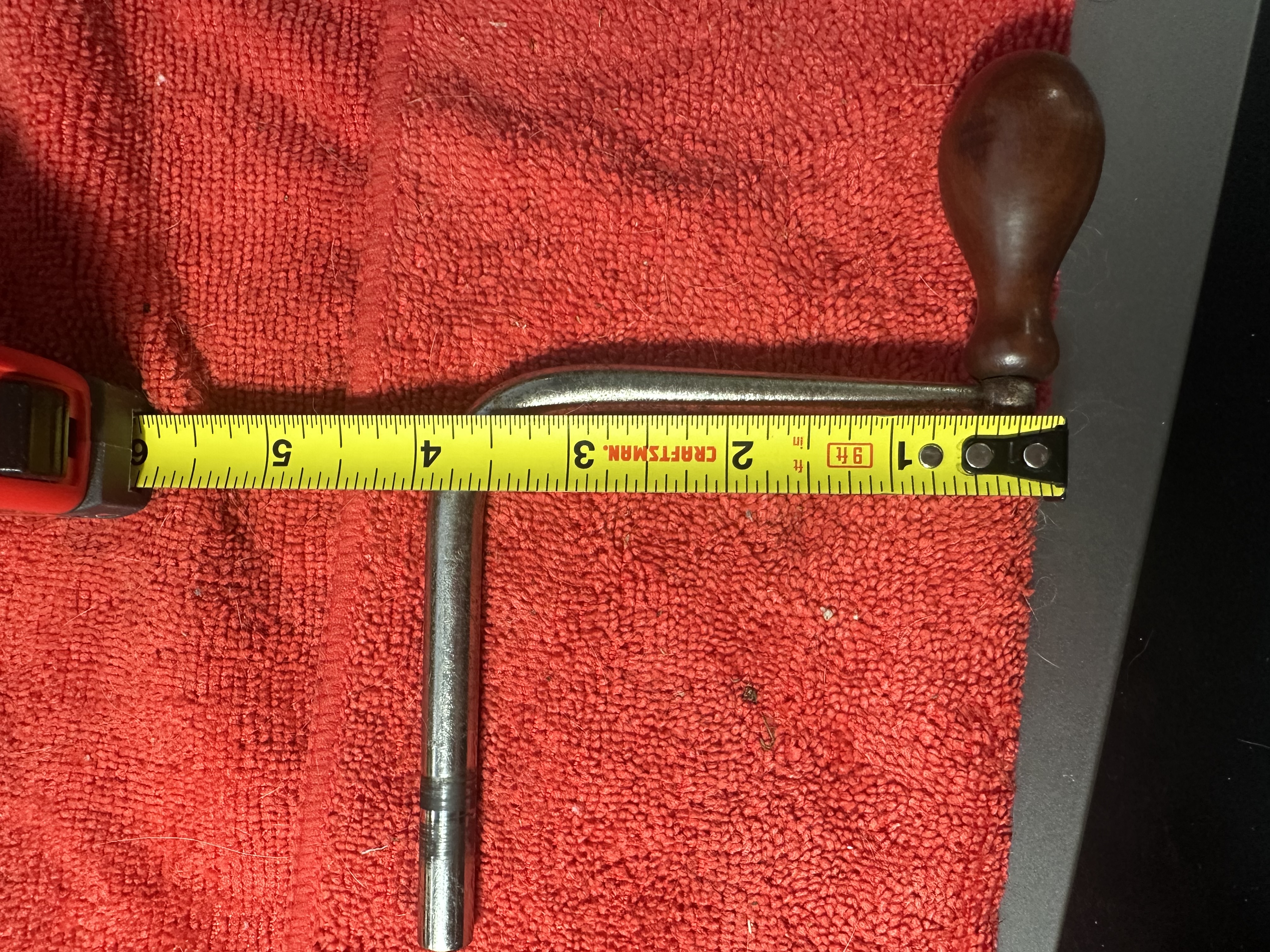

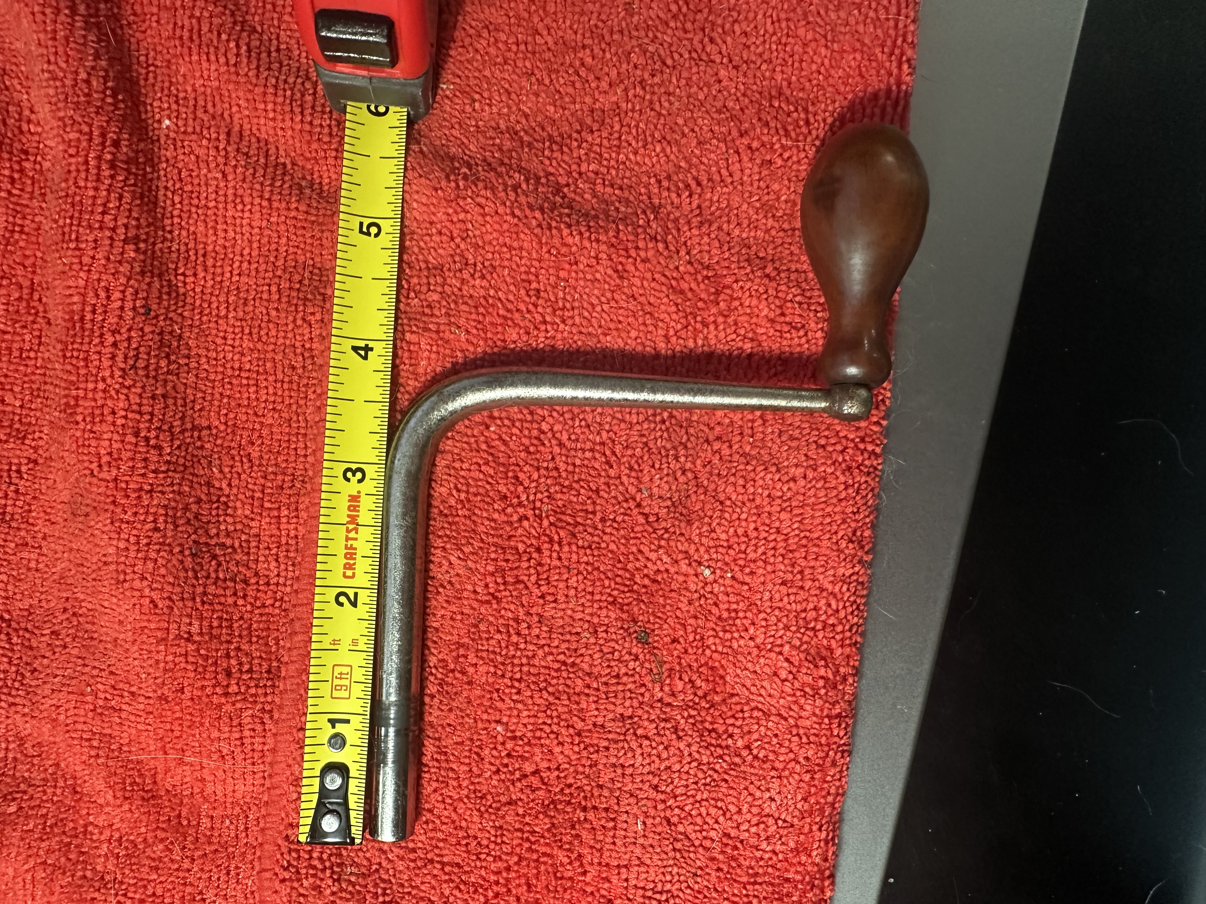

The crank is the standard female one for the Victor II through V. Photo and measurements below.

Thank you. I tried one of those but it seemed to stick out too far from the cabinet. However, just about every picture online basically shows the same crank, so with your added confirmation, I trust that this is the correct crank.
To the OP, your brake is correct.

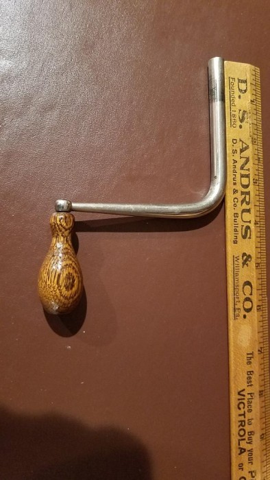

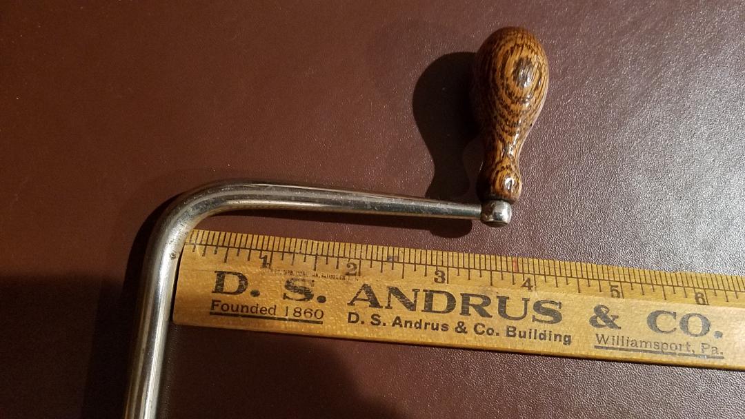

For Jerry--- et al.. Here's a couple pictures of the crank from my Humpback-- Hope this helps-

outune wrote: Fri Feb 07, 2025 4:51 pm For Jerry--- et al.. Here's a couple pictures of the crank from my Humpback-- Hope this helps-
Brad Abell
Thank you, Brad!
