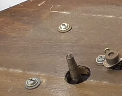

He did miss one obvious clue on the hexagonal crapophone base - the Philips type screws!

It's my video, so I take the flak. Yes, it was indeed my intention to warn of the perils of the usual fake machines, and as it happens I compared them to a typical Swiss type machine I happened to be looking at.Marco Gilardetti wrote: Mon Feb 10, 2025 9:23 am I believe the intention was to point out the most obvious crap-o's "features" to newbies. Then the list of exceptions is nearly infinite, but that is best to be left for a later stage into this hobby.
I see a lot of these fake machines in the wild and have had conversations with potential buyers who assumed they must be genuine as they have never seen anything else.
Yes, I will confess I have seen very few real horn machines. I'd love to have actually had a real HMV or Victor machine to compare against, but I have never seen one in the wild, much less had a chance to buy one (except for possibly at the only UK fair I am aware of, RetroTechUK).
On the other hand I appreciate that's not the viewer's fault and I have clearly been more absolute in my statements than I should have been.
I notice someone has said the video is "completely misleading". Is that the general opinion?
Thanks
- mrrgstuff
- Posts: 201
- Joined: Sun Jan 19, 2020 6:27 am
- Location: The south of England
Re: Never say never!
So YouTube doesn't allow me to make arbitrary changes to a published video, but what I have been able to do is remove the references to the hinged lid and 3 vs 4 screw mounting which I appreciate is not a reliable indicator of a fake machine.
I've also updated the description which hopefully makes it clearer, and mentioned that some non HMV machines did have bases of different shapes.
I can't unfortunately add text or voice-over to clarify anything in the video.
Thanks
Thanks
