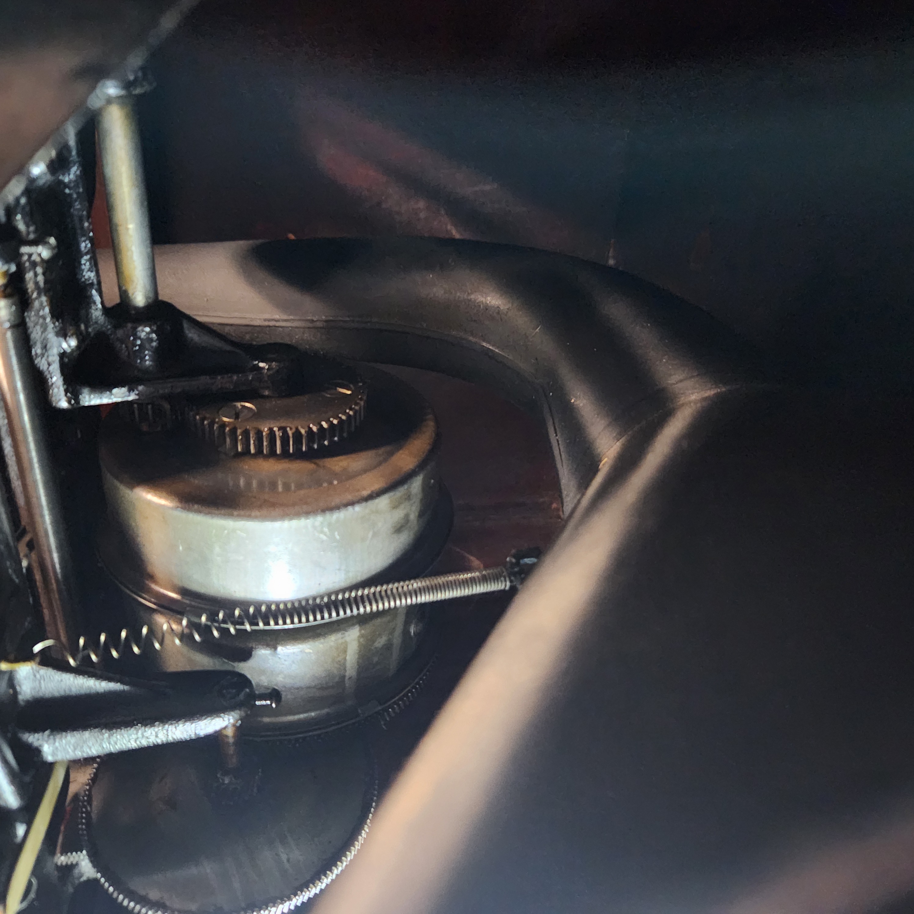

I checked, and the screw is loose. I've already cleaned much of the carriage rod, especially where it skips the most. the carriage moves freely when not sitting on the feedscrew & I'm not sure if the horn spring is damaged, so here's a picture to show you (of what i assume is the horn suspension spring), although I doubt it is causing it since the carriage moves so smoothly.Lucius1958 wrote: Sat Feb 22, 2025 10:33 pmThat's the screw right at the front end of the reproducer.
Also, some other things that might cause it to hang up in the middle: gunk on the carriage rod or the straight edge; stiffness in reproducer/horn joint; missing or damaged horn suspension spring.

If the reproducer weight moves freely, the carriage moves smoothly without resistance, and the spring is providing the right tension, then you can check the feed screw/half nut connection. There might be gunk or damage there; or in case of misalignment, there are a couple of small screws that can be adjusted. Let us know how you fare.
