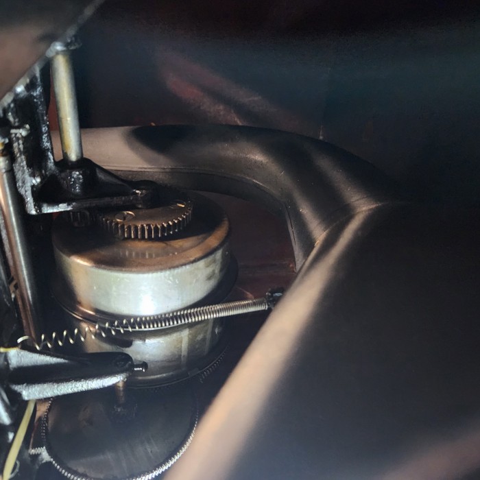

I checked, and the screw is loose. I've already cleaned much of the carriage rod, especially where it skips the most. the carriage moves freely when not sitting on the feedscrew & I'm not sure if the horn spring is damaged, so here's a picture to show you (of what i assume is the horn suspension spring), although I doubt it is causing it since the carriage moves so smoothly.

If the reproducer weight moves freely, the carriage moves smoothly without resistance, and the spring is providing the right tension, then you can check the feed screw/half nut connection. There might be gunk or damage there; or in case of misalignment, there are a couple of small screws that can be adjusted. Let us know how you fare.

Does the reproducer rotate freely in the horn? Have you taken it out? Sometimes the pot metal swells up and restricts that movement as well.

Pay very close attention to the movement of the carriage as it plays. Notice especially if the movement of the carriage pauses at the same time you notice the skipping. If it does stall, then the engagement with the feedscrew is slipping. This is usually remedied with a small adjustment. The slipping can also be caused by resistance in the movement of the carriage. Stiffness can be caused by lack of oil on the carriage slides or tightness between the reproducer neck and the horn. As to the suspension spring, if it's pulling too hard, it can actually cause the horn and carriage to lift. If the carriage lifts even a little bit, it can cause the halfnut to disengage with the feedscrew. Last, for those who are not accustomed to playing cylinders, it's not an uncommon thing to not push the cylinder onto the mandrel tight enough. If it's not snug enough, the record can drift off of the mandrel and get out of sync with the reproducer. That would tend to happen near the end of the tune, as you're experiencing.

It's definitely the engagement, one of the first things I noticed was how it was lifting out of the groove on the exact same point on every record. maybe this would also account for the slight skipping in the beginning, if it's too far out of sync it would probably cause problems on both sides, right? I'll try to adjust it
