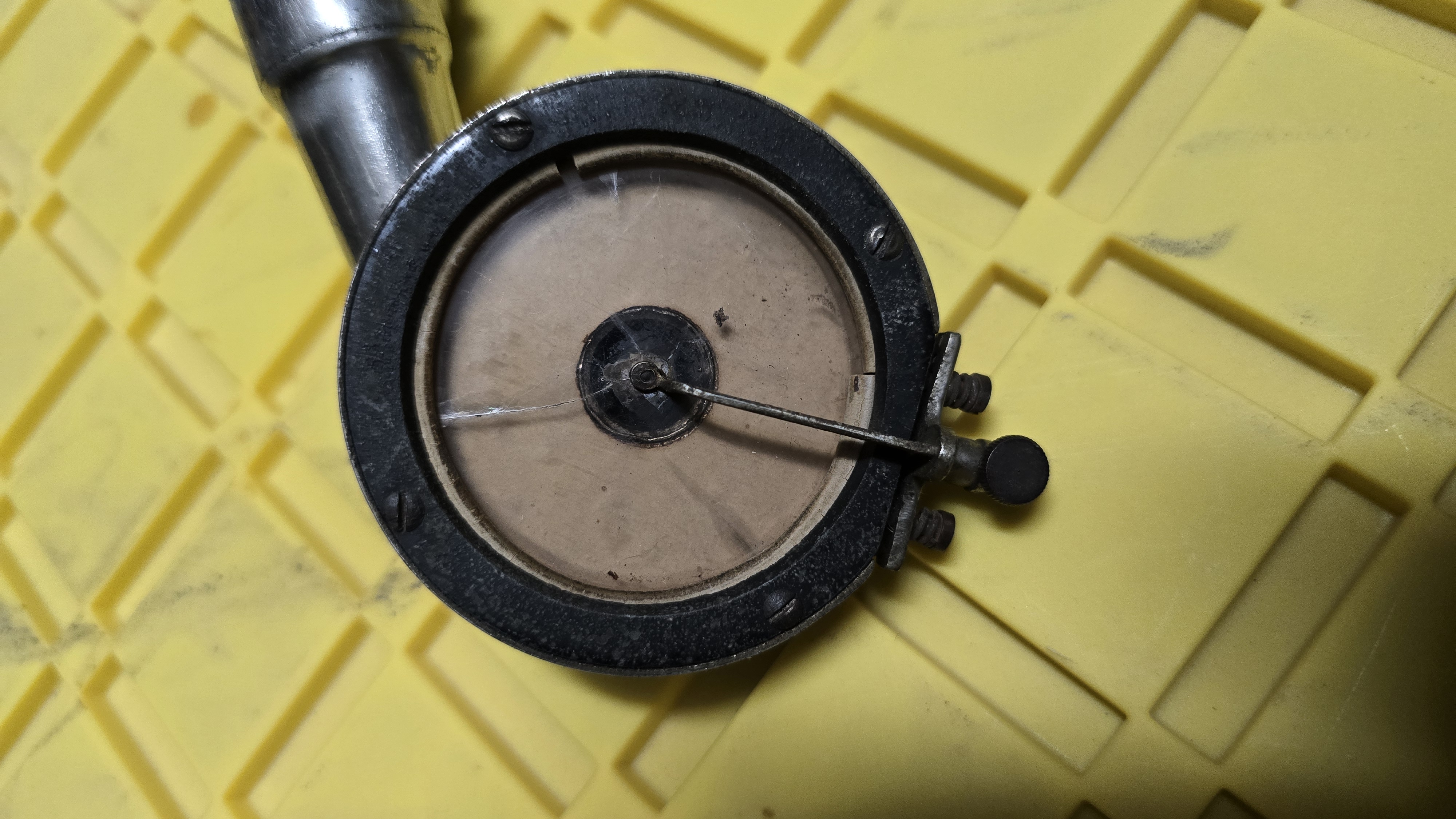

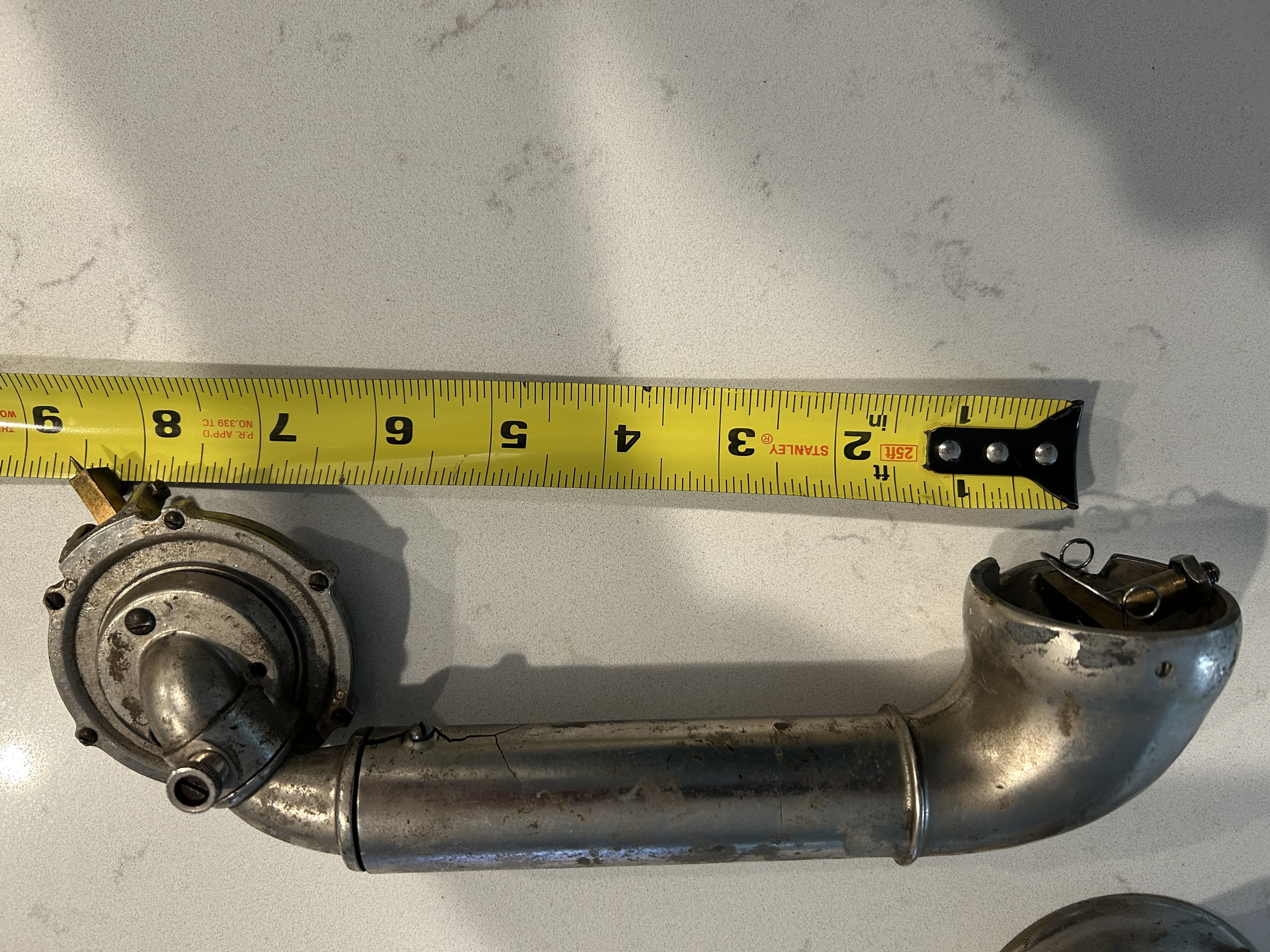

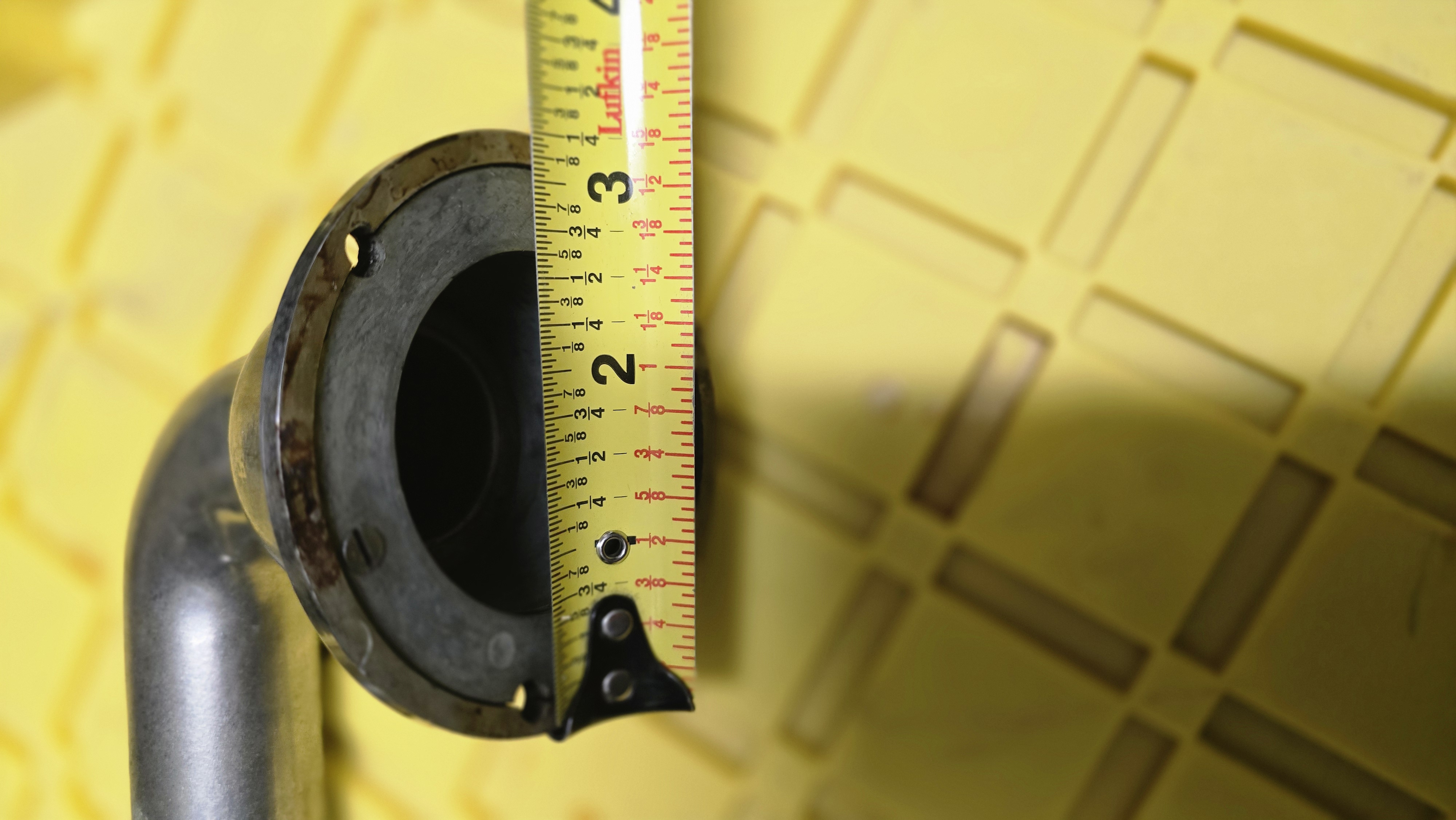

If you take a couple of more pictures and measurements I have a couple of tonearms that look a lot like the one you have. I fixed a couple of mine with JB Weld and a donor base I got from Ebay. It took a while and a lot of experimenting but in the end the are working perfectly now. I was a machinist in the military so fixing things is my way of keeping busy. Anyway just need some pictures and the diameter of the base on top and bottom.

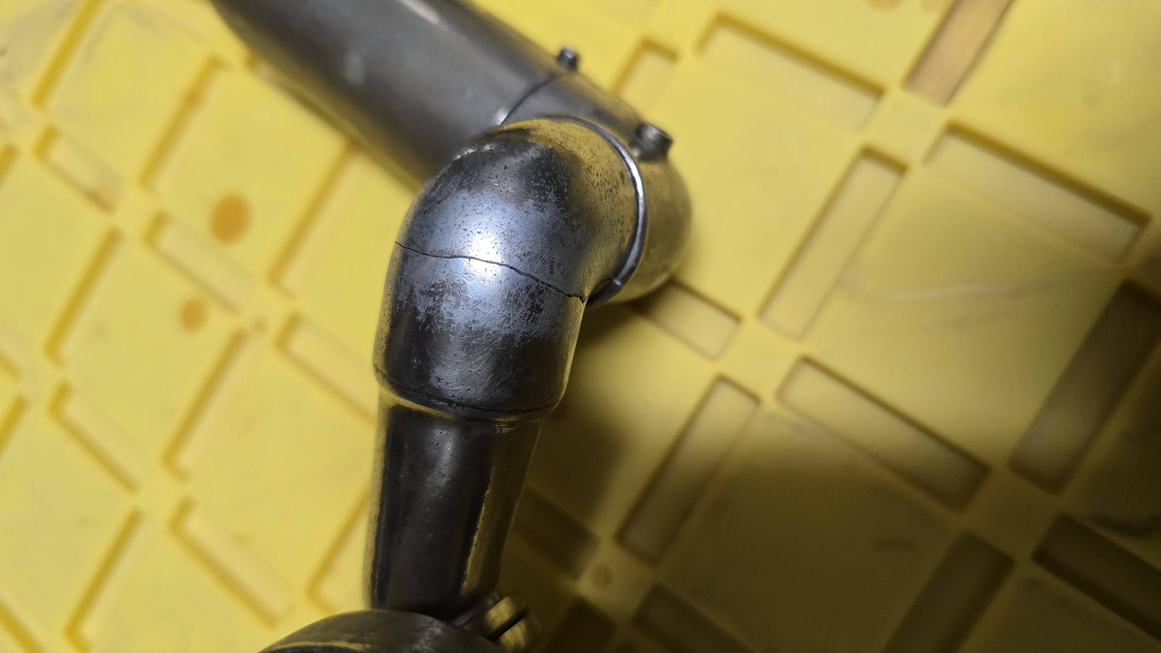

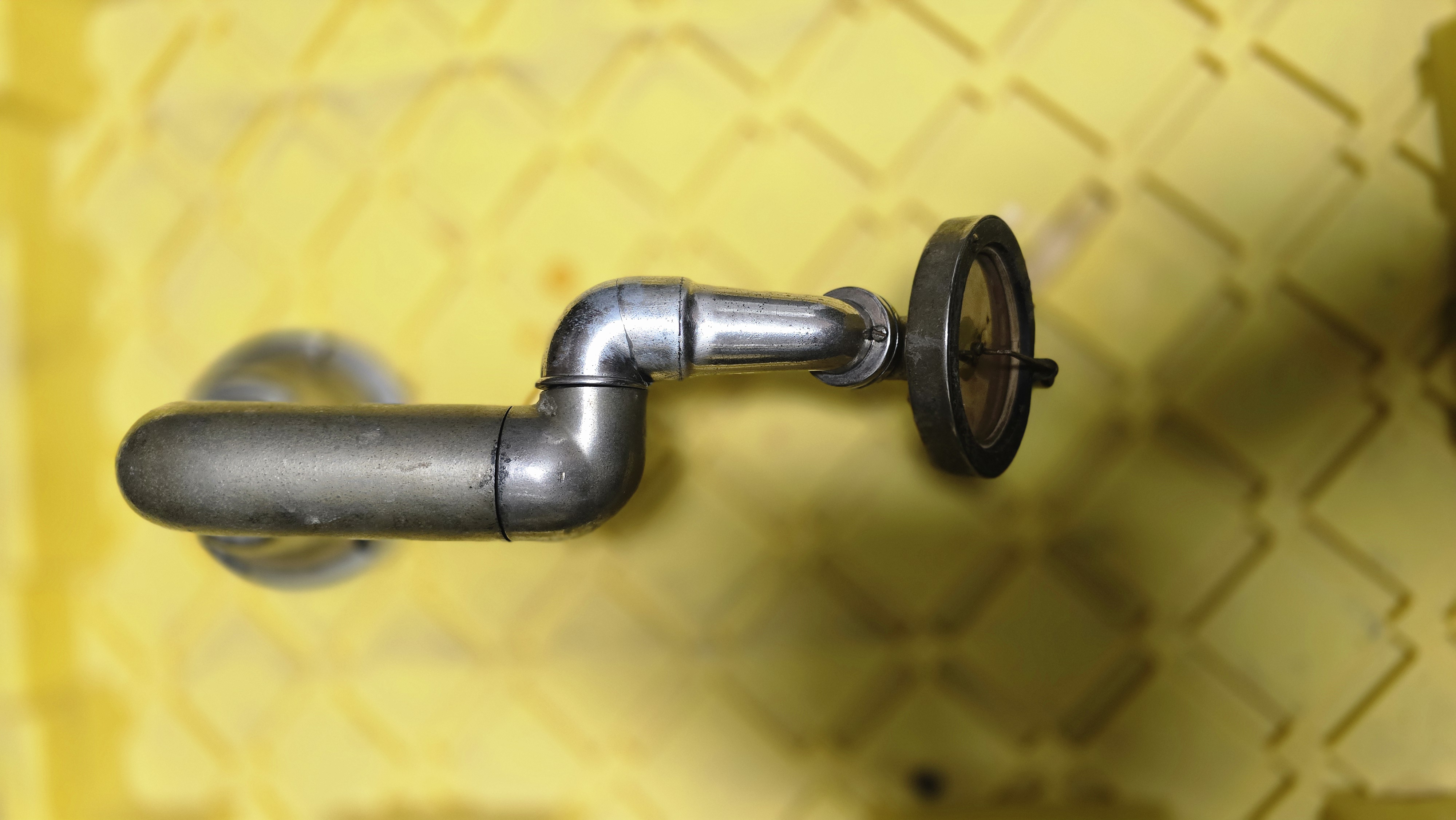

BigC wrote: Wed Mar 26, 2025 12:46 am If you take a couple of more pictures and measurements I have a couple of tonearms that look a lot like the one you have. I fixed a couple of mine with JB Weld and a donor base I got from Ebay. It took a while and a lot of experimenting but in the end the are working perfectly now. I was a machinist in the military so fixing things is my way of keeping busy. Anyway just need some pictures and the diameter of the base on top and bottom.
BigC, thank you! I will get lots of measurements and pictures this evening after work and post them here.
JasonK94Z
Posts: 14
Joined: Sun Mar 23, 2025 7:57 pm
Re: My first machine. Need advice and help!
Post by JasonK94Z »
Here you are. If you need anything else, let me know. Apparently that chunk out of the base of the tone arm is cut internationally. It rides on a tab in the mounting base that acts as a stop. The mounting base itself is missing a web with a hole in the center that that bolt rides in. The web is busted out and gone. It’s not anywhere in the phonograph either.
BigC
Posts: 258
Joined: Sat Apr 24, 2021 2:13 pm
Location: Blythe California
Post by BigC »
Here is the only thing I have that would come close to what you have. The reproducer needs to be rebuilt and it had a crack in the elbow that got fixed.
