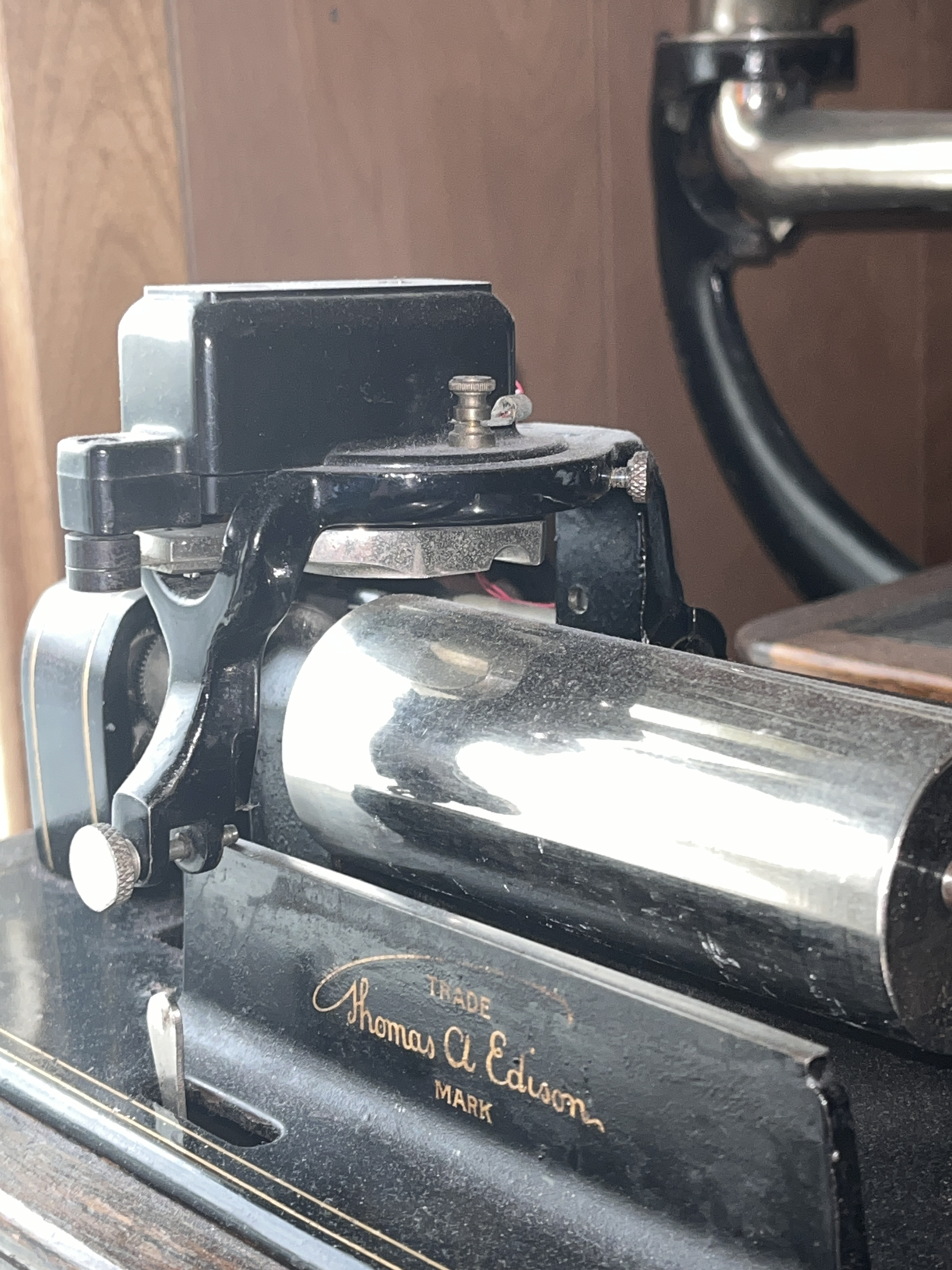

Sometimes available through myself, sometimes through my business partner & co-inventor Peter Liebert.
Fits in place of an Edison C or H reproducer.
You can use any custom stylus mounted to a Stanton 500 compatible assembly. Currently we are only able to include a 4-minute stylus (which will also play any 2-minute celluloid [not wax] cylinder records.
I’ve just made up another small run of parts…likely the last as the Stanton 500 cartridge I use has been out of production for many years and NOS parts are getting harder to find at prices I can justify purchasing.
I plan to have reproducers available at the upcoming Wayne show (at Peter Liebert’s table).
Pm or email [email protected] if interested or if you have questions. You’ll have to be patient as I generally only check email / messages once a week or so.
-Rob
(The dust on the record/stylus is from the record sitting on the phonograph unplayed for a couple years, not from the stylus wearing the celluloid! I didn't notice the dust before I uploaded the pic.)
