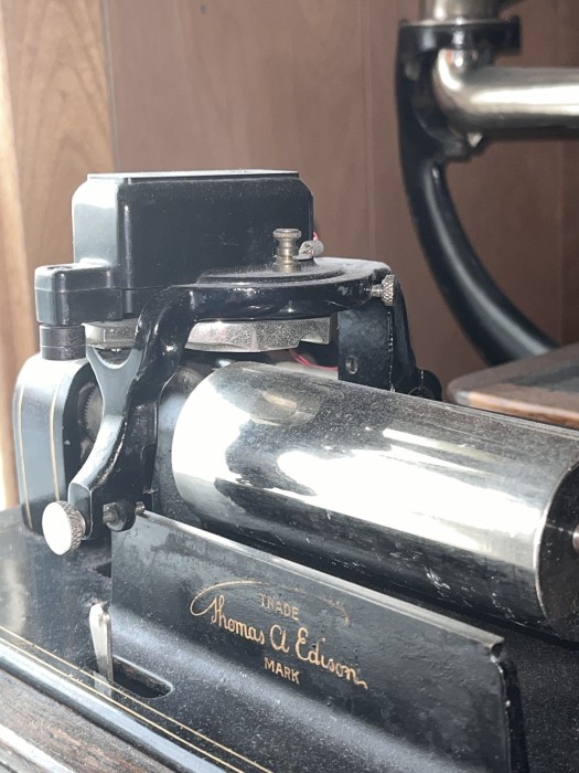

Here is probably the granddad of electric pickups. It's a Sykes Electrograph from 1936. It was produced in England and not very common
to find over here. The few I have seen for sale were in England. I doubt it was a big seller as by 1936 the cylinder was pretty much a dead recording medium even
in England.
This is mine mounted on an Edison Standard B It's designed to play Blue Amberols as the stylus and weight assembly is taken from a Diamond B reproducer. Rebuilt and adjusted it surprisingly sounds good.
Only drawback is if the record is even slightly out of round you hear the bump-bump much more than on acoustic playback. It seems virtually every Blue Anberol is
just enough out of round to be annoying to listen to. I found the best records are Columbia, US Everlasting or similar celluloid records sound the best.

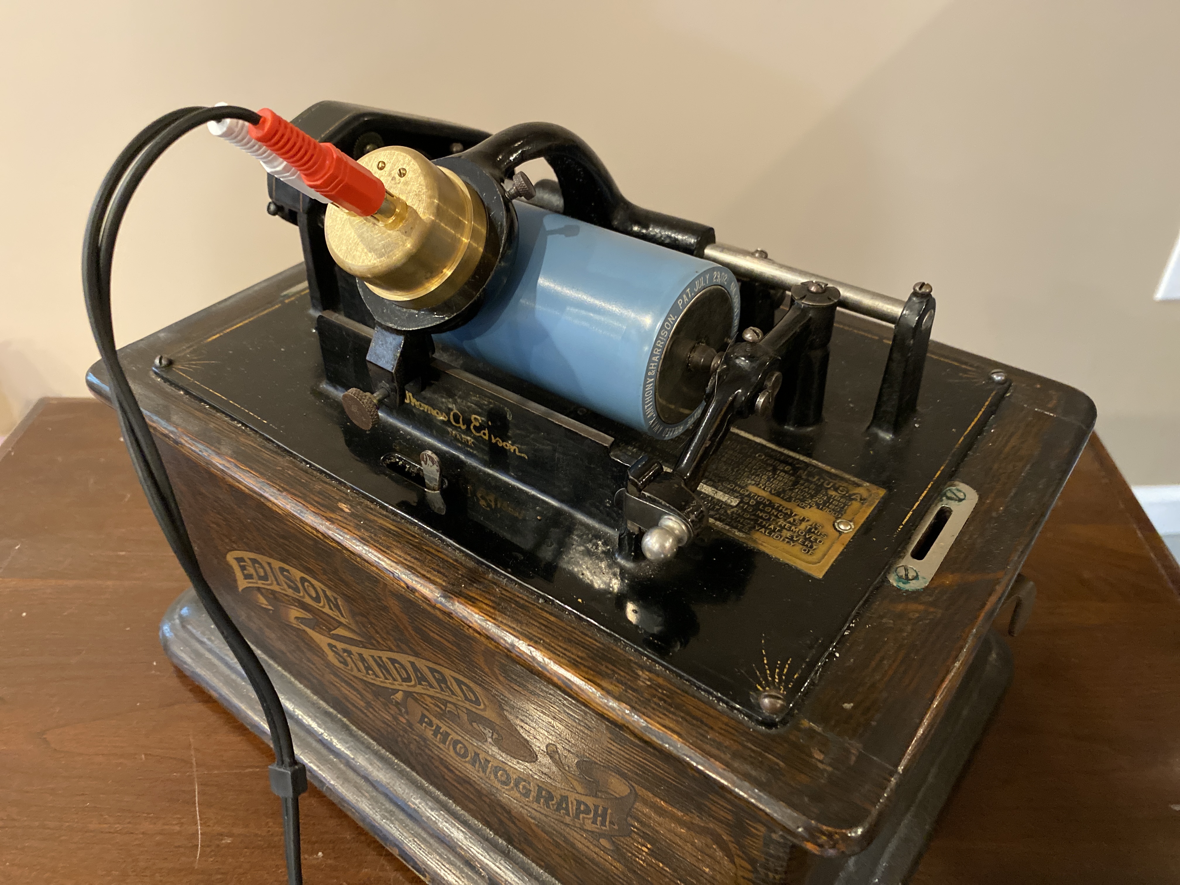

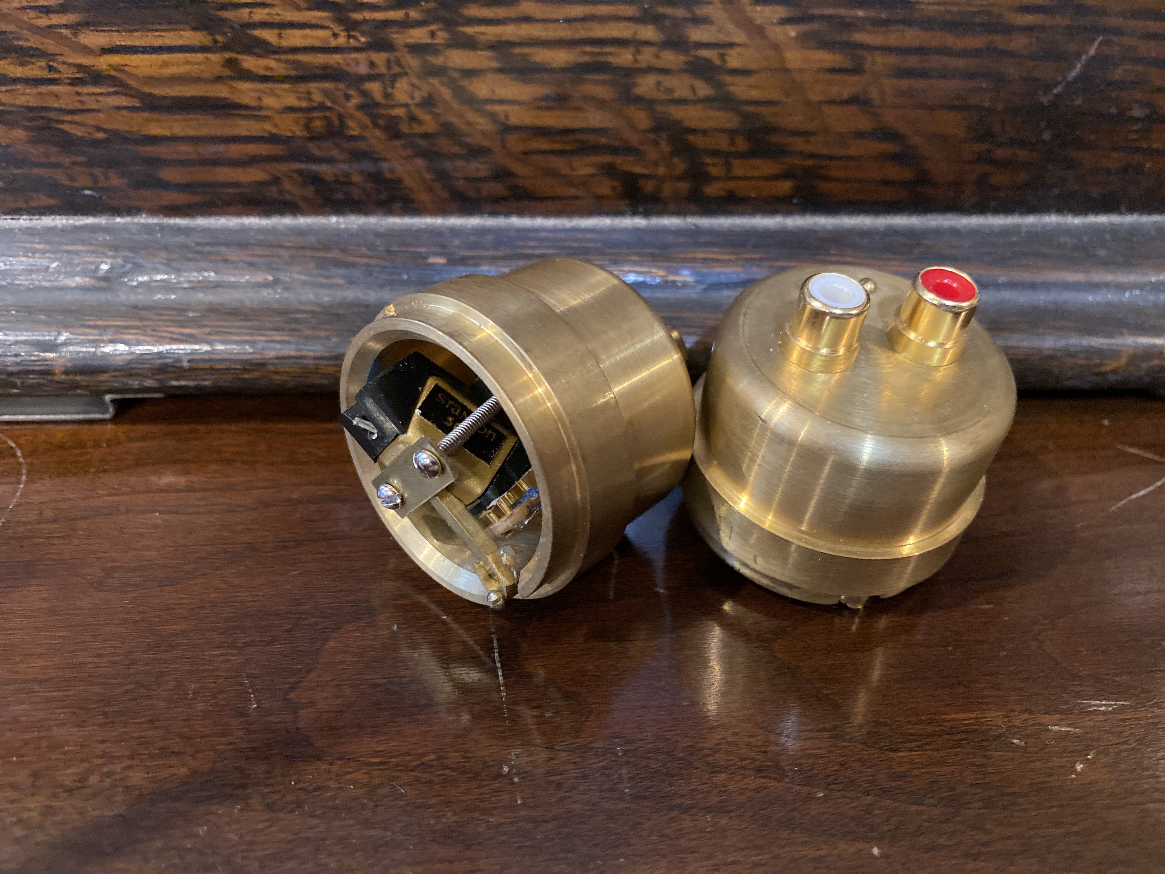

Sometimes available through myself, sometimes through my business partner & co-inventor Peter Liebert.
Fits in place of an Edison C or H reproducer.

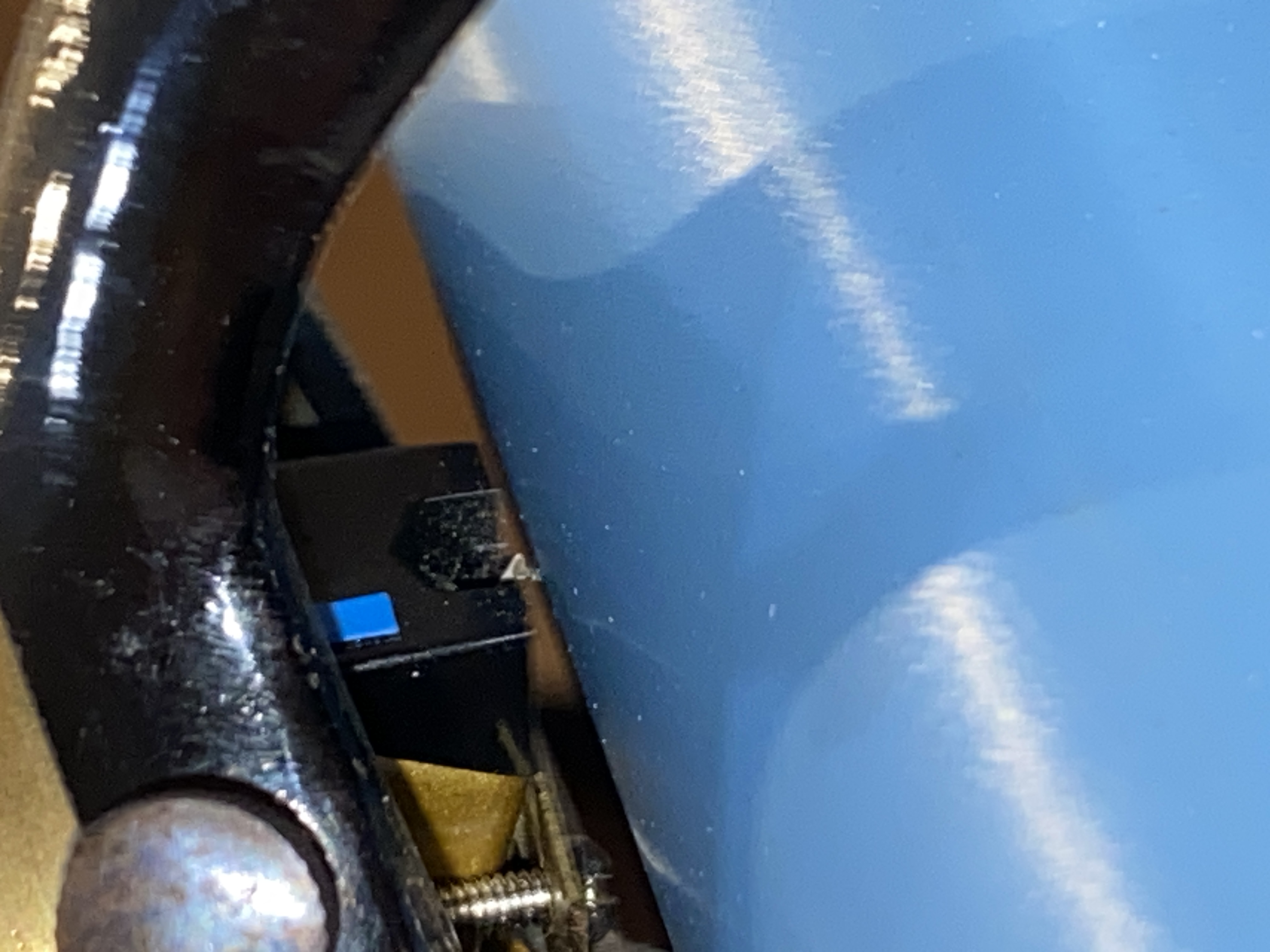

You can use any custom stylus mounted to a Stanton 500 compatible assembly. Currently we are only able to include a 4-minute stylus (which will also play any 2-minute celluloid [not wax] cylinder records.
I’ve just made up another small run of parts…likely the last as the Stanton 500 cartridge I use has been out of production for many years and NOS parts are getting harder to find at prices I can justify purchasing.
I plan to have reproducers available at the upcoming Wayne show (at Peter Liebert’s table).
Pm or email [email protected] if interested or if you have questions. You’ll have to be patient as I generally only check email / messages once a week or so.
-Rob
(The dust on the record/stylus is from the record sitting on the phonograph unplayed for a couple years, not from the stylus wearing the celluloid! I didn't notice the dust before I uploaded the pic.)
