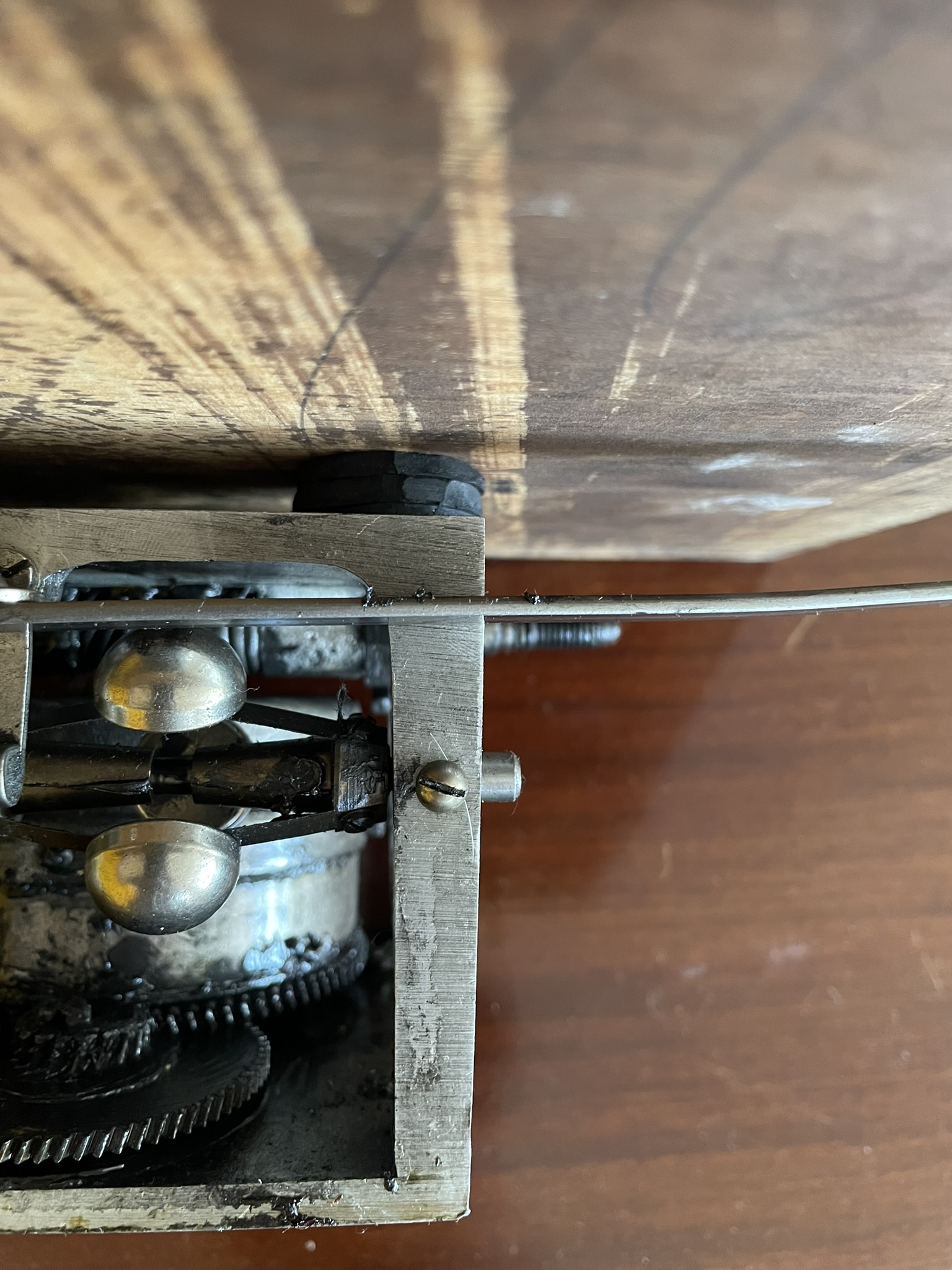

Just a little update on the restoration,
I received some rubber today in the mail and made some washers for the motor, this worked really well and the motor is somewhat level now.
However, I have caused myself to have another problem and a very silly one at that. I'm probably going to anger a few on here but I thought I had let the motor run down completely but I guess there was a little left so when I took apart the sped regulator to insert a new pad of felt, the governor span out of control and broke off two weights. I have found both weights and asked John Sleep in case he has some replacement spring things but I know this is a very scarce area in replacement parts. I'm very annoyed because I thought I had done everything correctly.
In regards to the sound box rebuild, I am still yet to receive the part from John but he said he will get to me as soon as he can.

If no luck with John Sleep, I might possibly have springs to fit.

Update:
I have sent the governor off to John Sleep to fix and received it back yesterday. I have put it back in and adjusted the speed regulator as well as replaced the pad. All seems to work fine on the motor now apart from the governor itself making a lot of noise - like a whirring noise. As far as I can tell, its not coming into contact with anything so I'm a little confused as to what it could be, if anyone could hazard a guess that would be great!
My next move is to fix the sound box but it turns out John didn't have a replacement rubber isolator so I've decided to make it myself. John Sleep recommended car tyre inner tubes and I will see how much this costs but I was also thinking just of making it out of the same material my washers were for the motor board (obviously in a thinner sheet though). If anyone has any suggestions on this, I would be grateful.

Whirring governor might be the end bushings worn out. Are they made from brass? Some photos of that area, the bushings, etc... even a short video, would be very illustrative for us to understand and try to help...
