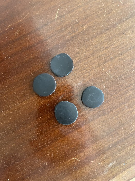

Re: Fullotone Cabinet Gramophone Restoration
So while I was taking it apart to the stage I got to before with the mica removed etc the back actually just came off on its own, quite cleanly too. I can see now that the rubber is very brittle and will need replacing. Although I am not entirely sure what to use, so if anyone could suggest a material that would be great! I think making these isolators is the only way due to their specifications.
Overall though, this soundbox looks like it will clean up nicely and the mica might last a little longer if I am careful. I have put back together a Exhibition before and that one works well as far as I can tell so this should be no different hopefully.
- Posts: 6534
Similar to what you're doing for the motor mount rubber washers, buy some rubber sheet of the correct thickness and cut out the new isolators. A fairly soft rubber should suffice.
As Jerry has said, the best material to use, and probably as close as you'll get to the original stuff, is natural rubber sheet of a similar thickness. If you can find some with a hardness (durometer) value specified, somewhere around 60 or less would be ideal - fairly soft.LaoChe85 wrote: Wed Jul 16, 2025 1:34 pm So while I was taking it apart to the stage I got to before with the mica removed etc the back actually just came off on its own, quite cleanly too. I can see now that the rubber is very brittle and will need replacing. Although I am not entirely sure what to use, so if anyone could suggest a material that would be great! I think making these isolators is the only way due to their specifications.

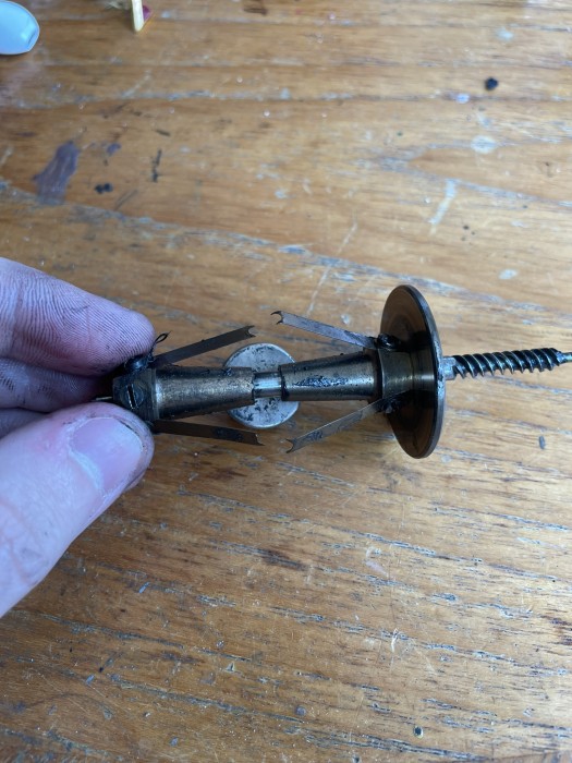

Just a little update on the restoration,
I received some rubber today in the mail and made some washers for the motor, this worked really well and the motor is somewhat level now.
However, I have caused myself to have another problem and a very silly one at that. I'm probably going to anger a few on here but I thought I had let the motor run down completely but I guess there was a little left so when I took apart the sped regulator to insert a new pad of felt, the governor span out of control and broke off two weights. I have found both weights and asked John Sleep in case he has some replacement spring things but I know this is a very scarce area in replacement parts. I'm very annoyed because I thought I had done everything correctly.
In regards to the sound box rebuild, I am still yet to receive the part from John but he said he will get to me as soon as he can.
Update:
I have sent the governor off to John Sleep to fix and received it back yesterday. I have put it back in and adjusted the speed regulator as well as replaced the pad. All seems to work fine on the motor now apart from the governor itself making a lot of noise - like a whirring noise. As far as I can tell, its not coming into contact with anything so I'm a little confused as to what it could be, if anyone could hazard a guess that would be great!
My next move is to fix the sound box but it turns out John didn't have a replacement rubber isolator so I've decided to make it myself. John Sleep recommended car tyre inner tubes and I will see how much this costs but I was also thinking just of making it out of the same material my washers were for the motor board (obviously in a thinner sheet though). If anyone has any suggestions on this, I would be grateful.
- Posts: 4534
Whirring governor might be the end bushings worn out. Are they made from brass? Some photos of that area, the bushings, etc... even a short video, would be very illustrative for us to understand and try to help...
