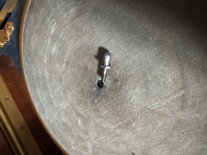

Unscrewing the spindle is necessary because it acts as a nut, holding the turntable in place. I have been keeping it partially unscrewed while I used the mallet to give me a place to apply pressure while allowing the platter to break free.
Here is the spindle situation.

You could also insert wood wedges around, under the platter, to help it out, and then give kicks with the mallet... small repetitive kicks.
You need to give them with the aid of a blunt punch or something, and to be sure that the kicks go where they are needed. Your idea of using the spindle itself, half screwed, it's the same I would do.
Eventually it will start to lean off the spindle. Be patient and careful.
Wish you luck! Turntables can be very stubbornly attached are years of use.
